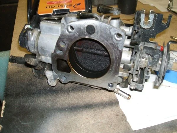

IME, the best solution for the EGR faults in older, high mileage 80s is to install an oil bypass filter from the valve cover to the throttle body/intake. It's the accumulation of carbon in the EGR sensing loop that is the ultimate cause of the P0401 fault, in trucks with otherwise functioning EGR system components.
Removing the filth from the intake airstream also promotes cleaner burning fuel cycles, resulting in improved fuel economy and longer engine, and engine component, life.
