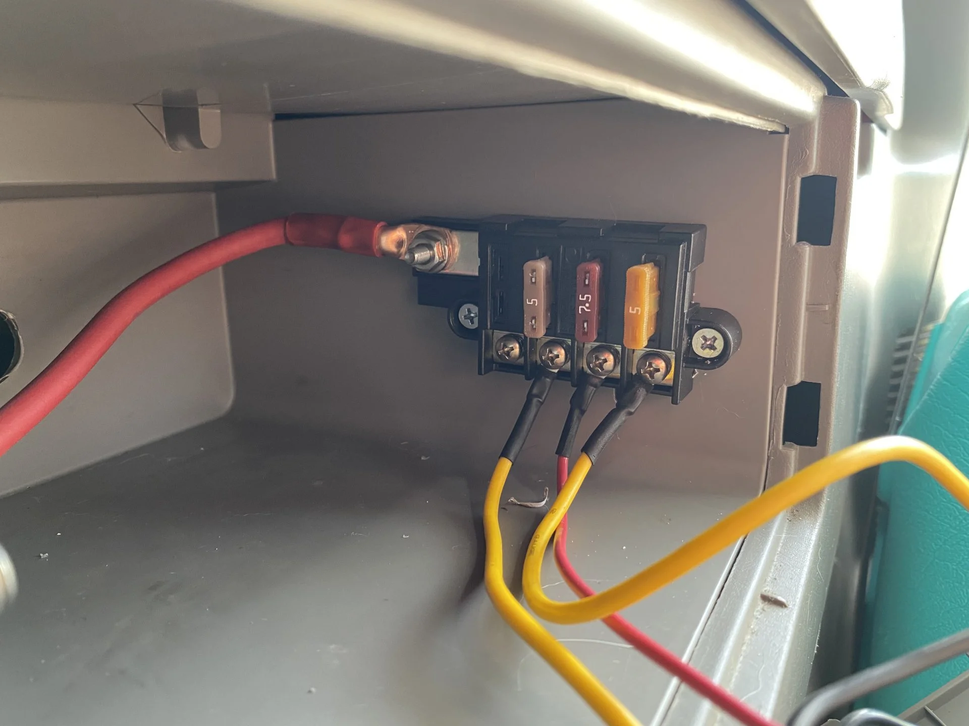

I’ve learned a lot since last writing on this thread and wanted to close the loop with my solution.
Needed bigger wiring as suggested by several helpful folks above. Turns out the wire leading to the rear panel was only 12 AWG and had a couple questionable butt splices in the mix. I replaced this and the ground with 8 AWG and now the accessory panel reads 12.3V with the fridge running. I still have voltage drop from the fuse block to the fridge which must be related to the 14 AWG wire that connects the fuse block to the PowerPole connection. I guess it’s time to bite the bullet and buy the Anderson crimper to rebuild these with proper 10/12 AWG wire.
