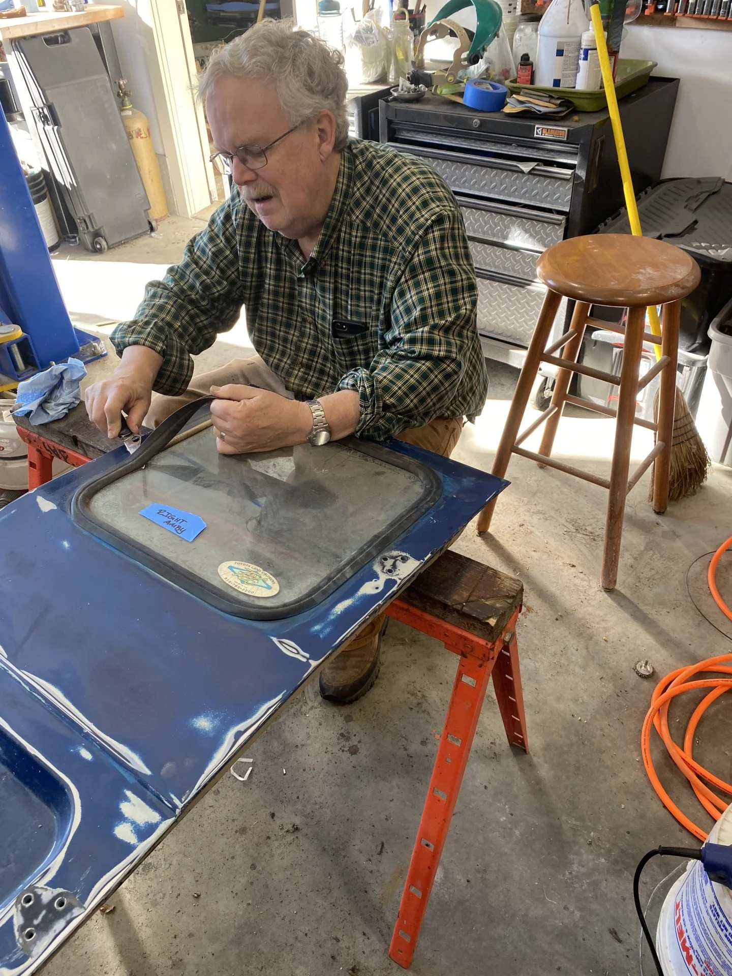

Anybody have any experience with one of these? My old man and I are stripping my 6/77 FJ-40 for a full repaint.
Looking for some tools that will help speed up the process and reduce the elbow grease needed for my pops.
Scope out the original sticker on the amby door glass. "Toyota Land Cruisers" Van Nuys CA 818 785 2200.
I just googled that number, brings up some info associated with some shops in Van Nuys, and looks like mayber the number's used by Icon 4X4, or was at some point? I can tell you with 100% certainty that this truck is not and ICON! Hahaha.

The hood on my truck is pretty rough, and I'll probably bring it down to bare metal. At some point in its earlier life, it looks like there was a fire in the carb, so the paint on the hood is, ah, "patina-ed," to say the least. And as we come across areas where the paint shows signs of poor adhesion or anything funky, those'll get stripped down, too.
We made pretty good progress in a couple hours yesterday working on the sides. Popped the glass out and used a DA sander, a sanding block, and 220 grit. No rust really, aside from a small area in the rounded corner where the sides meet the tub at the back of the truck. I'm definitely scratching my head and wish I knew the history of the truck. It was originally yellow, then painted blue. Inside of the amby doors was tan. Inside of the sides is white. Lots of drips in that layer of white paint, so sanded it away and found more of an ivory color, which is the last layer before factory primer. Inside of front doors and the dash, under dash, floor pans are all black. Bed of the tub is a mix of blue, black, and showing some yellow through scratches.
We should get some more time in the shop today, aiming to have the sides primed by the end of the weekend. Then we'll move on to the rest of the truck, panel by panel.
