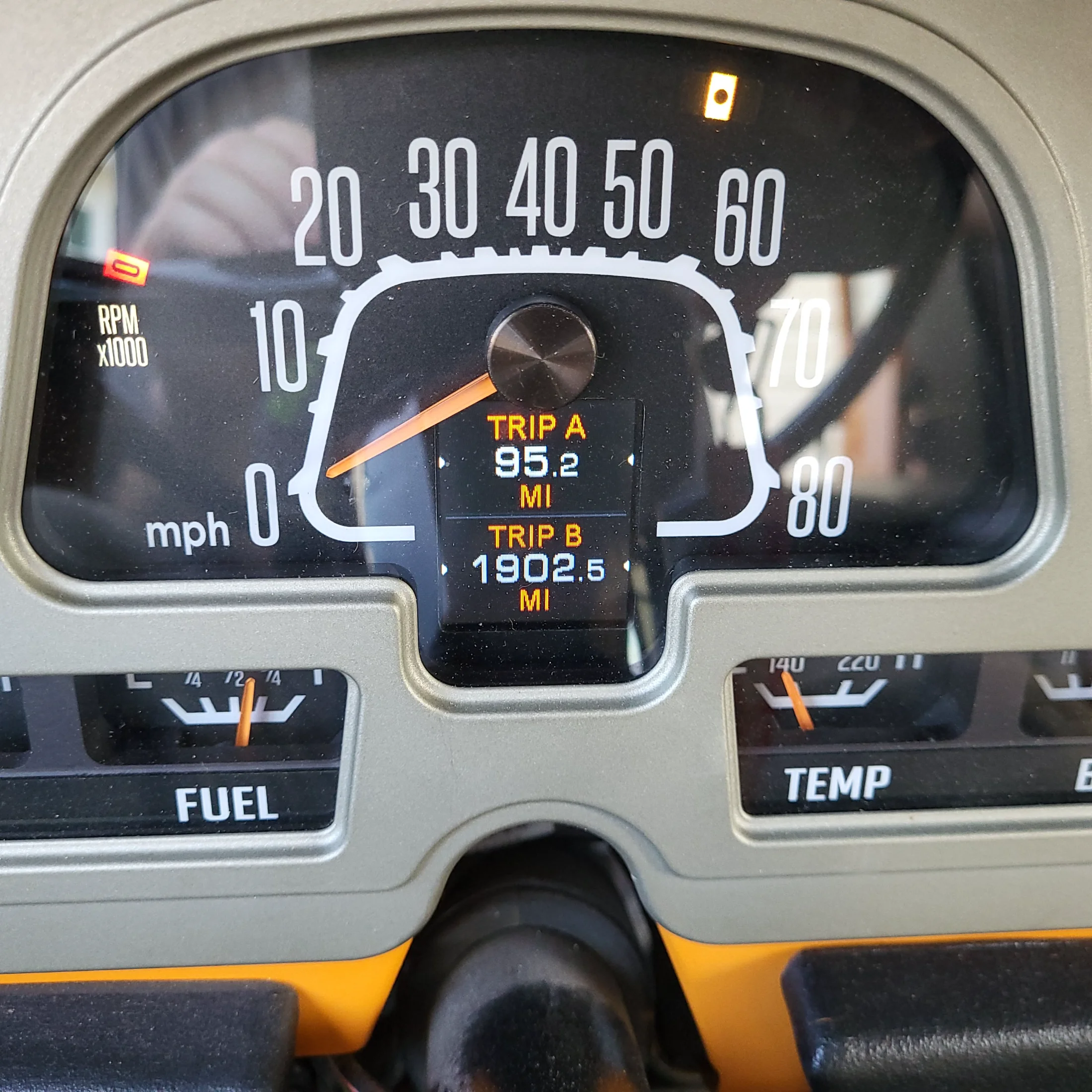

I reset my trip at every fill. So I've got 95.2 miles since I filled.

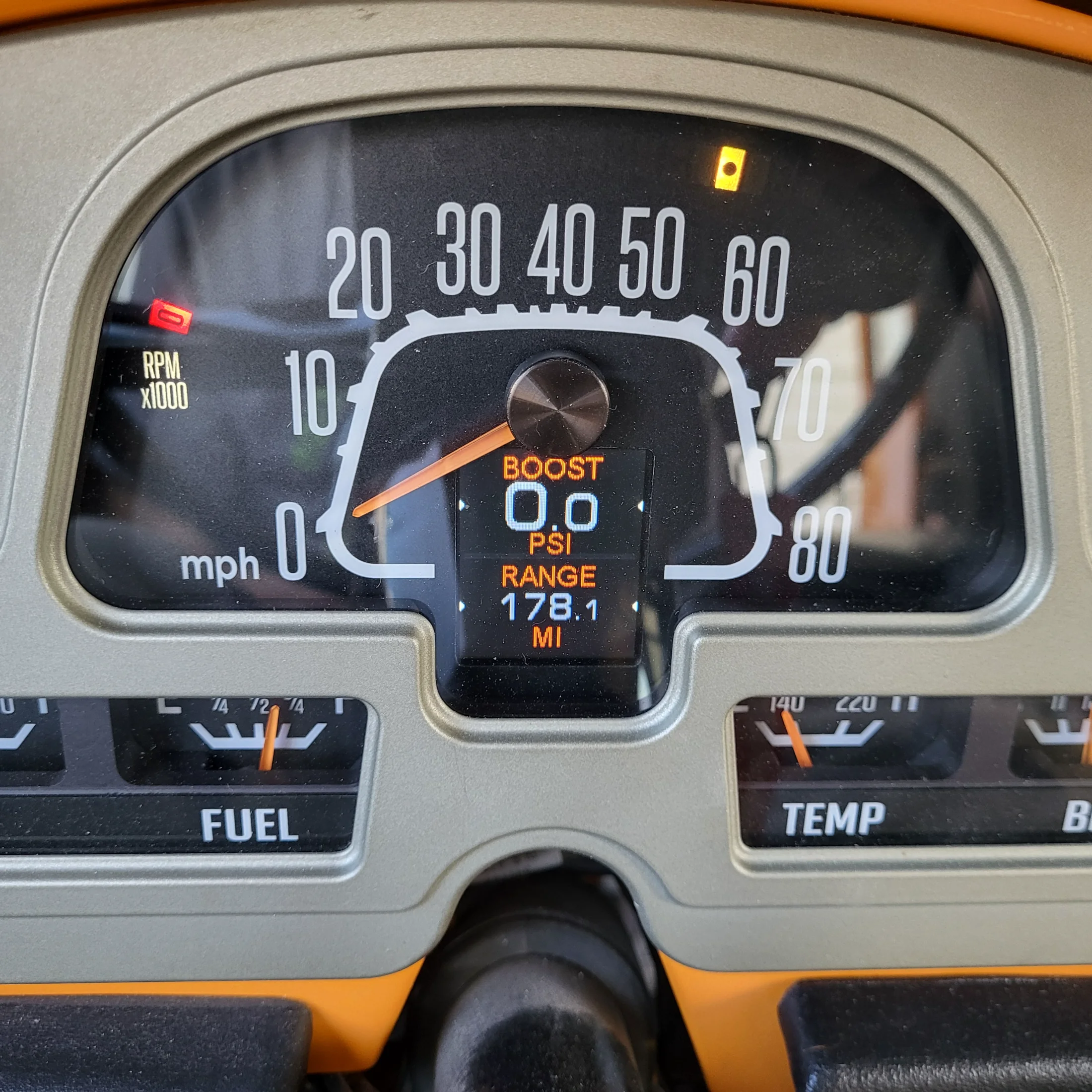

With Range enabled, it's showing I have 178.1 miles remaining. Thats potentially really close to reality. I normally get around 20mpg with this thing. Max i can hope to get is 320(ish) miles on a tank before it goes pedestrian mode.

Now I am jealous that your range works and that you have such a long range. Thanks for checking that out. I have no idea what is wrong with mine but I wonder if it’s having a hard time calculating 7-13 mpg.
