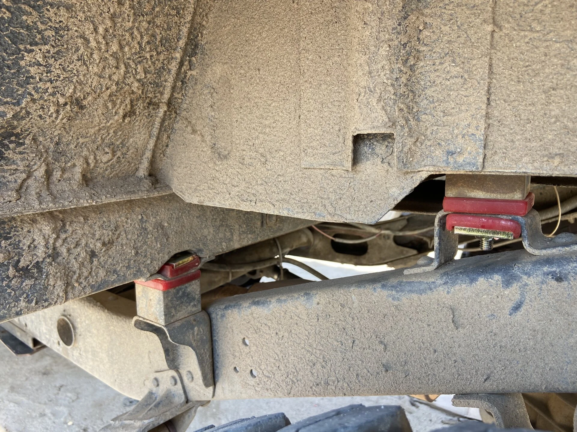

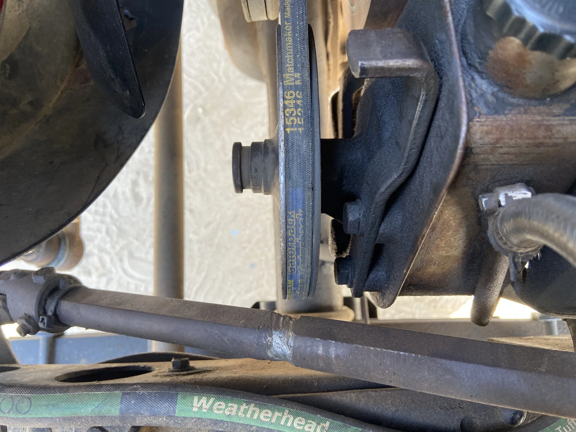

I had a few issues to address before leaving. For the past few months when the rig gets really twisted up my power steering pulley was contacting the steering shaft going into the box.
Clearance is tight to begin with and I figured it was just a combination of all my mounts being 25+ years old, rotten, and destroyed. I finally installed a poly body mount kit that I have had in a box since 2020. My fear was broken hardware on disassembly but everything went smooth.
I probably should have washed the thing beforehand to limit the dirt in my eyes but I survived and the install took only a few hours. I also took the time to check the trans crossmember mounts and the motor mounts. To gain any clearance I could I used a prybar to push the engine over a hair before cranking down the motor mounts. I don't know how much it actually moved but I did it anyway.

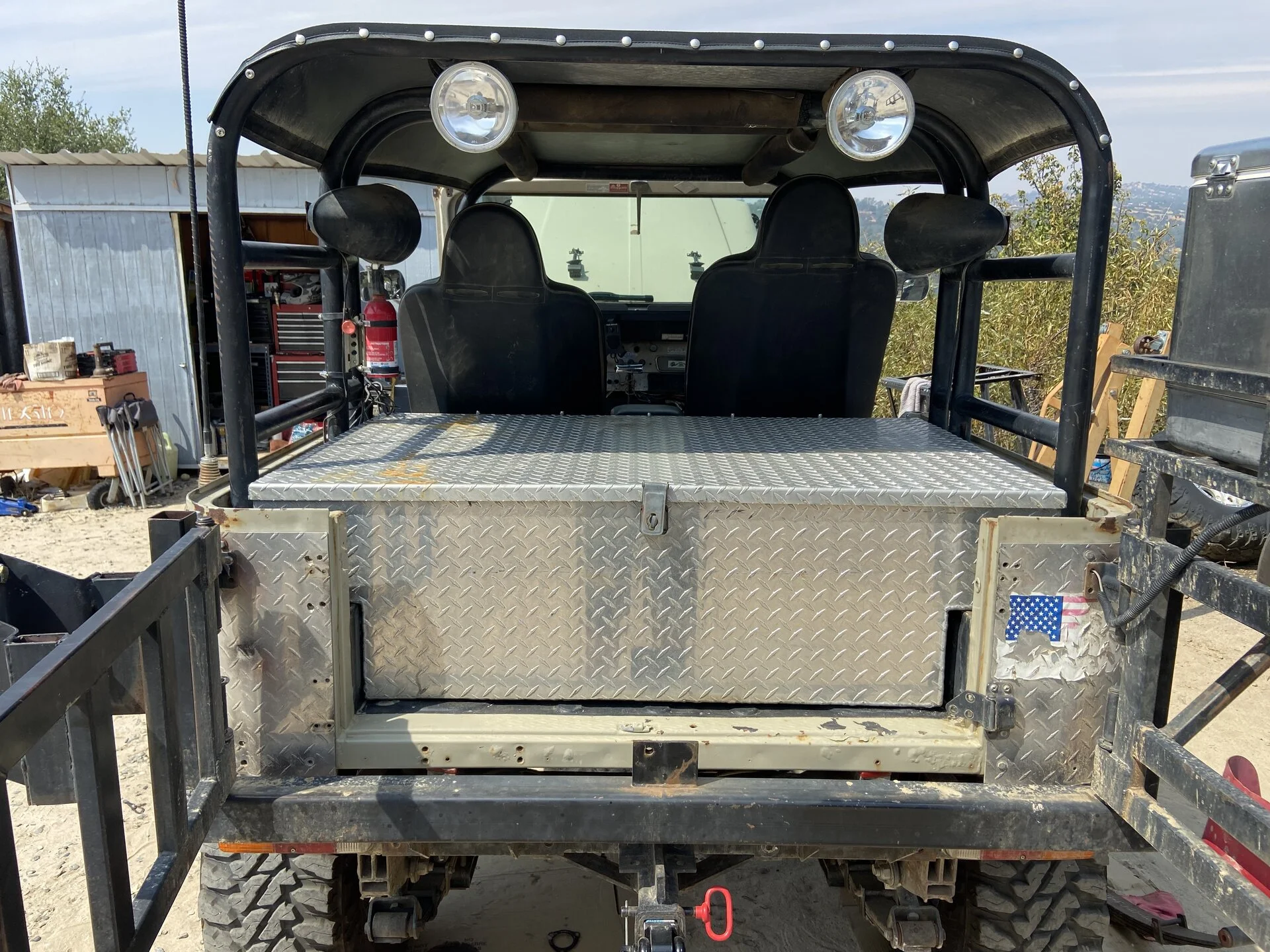

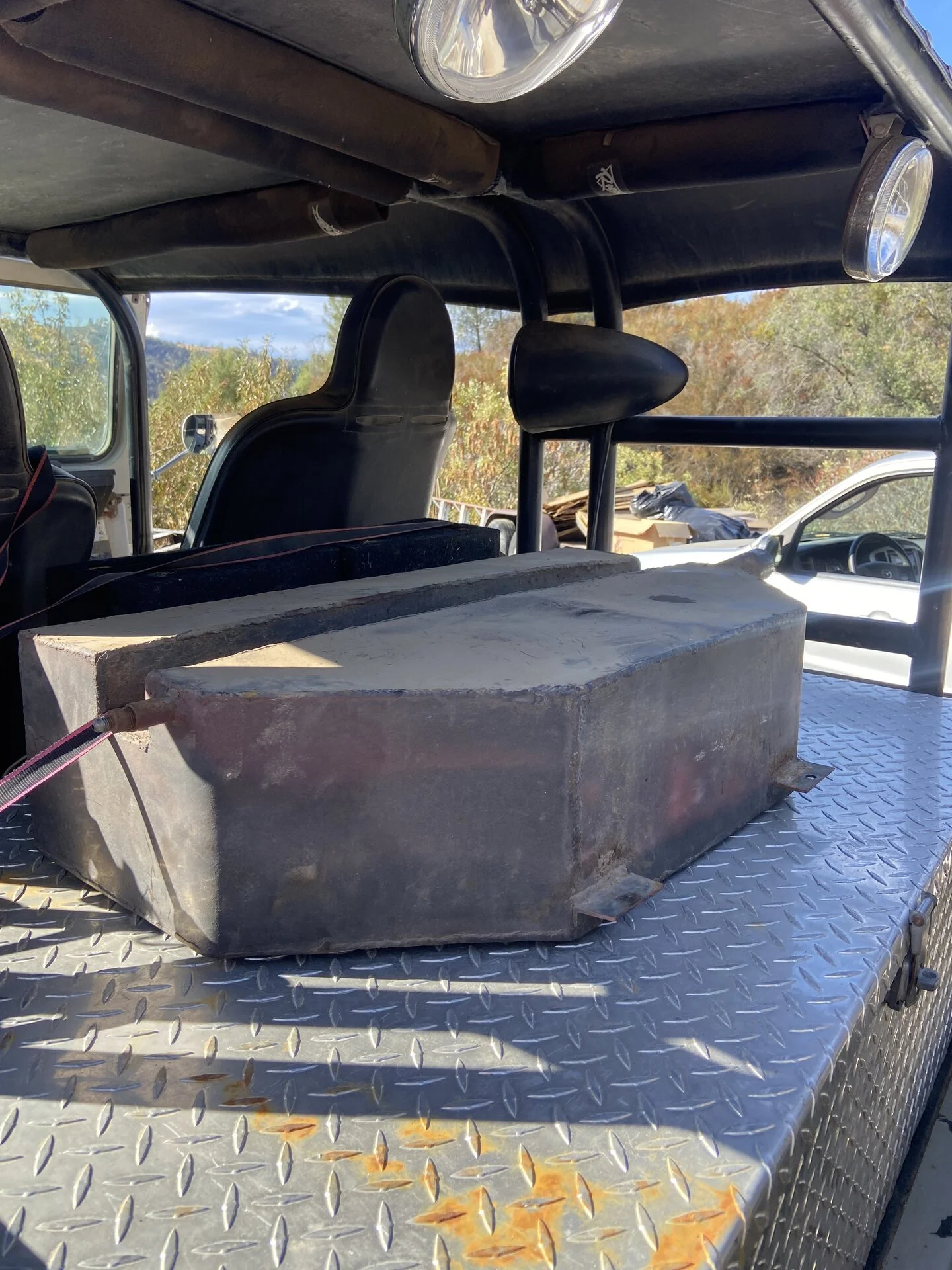

The next bit of prep was setting up my storage for tools and camping gear for the rubicon. I pulled the rear sit to put my toolbox in. I told my friends they will need to hustle and get their rigs finished because I'm not going to remove all this lockable storage for a backseat again so no more free rides.

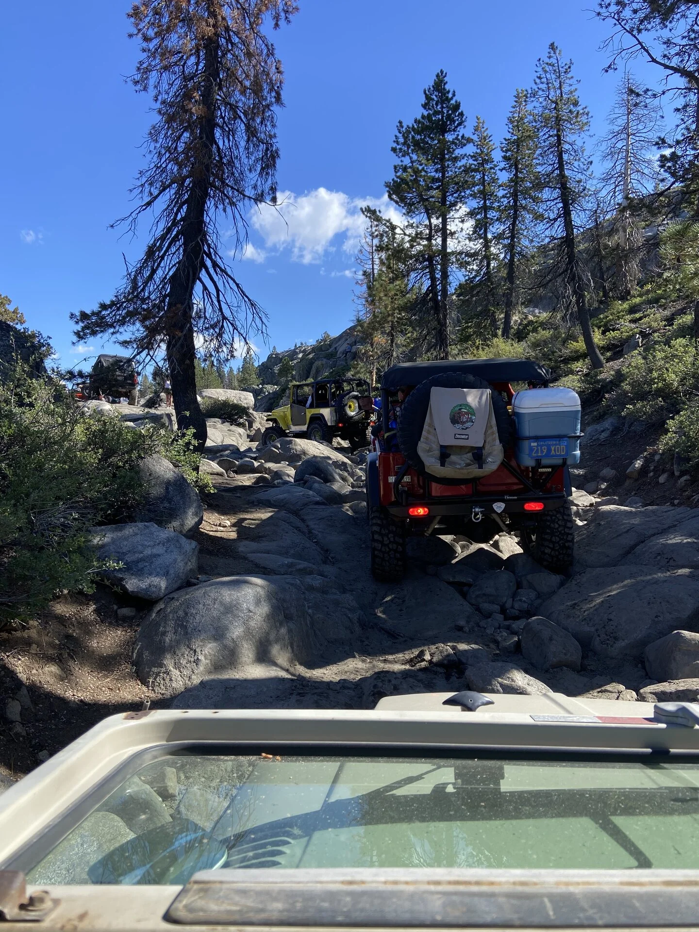

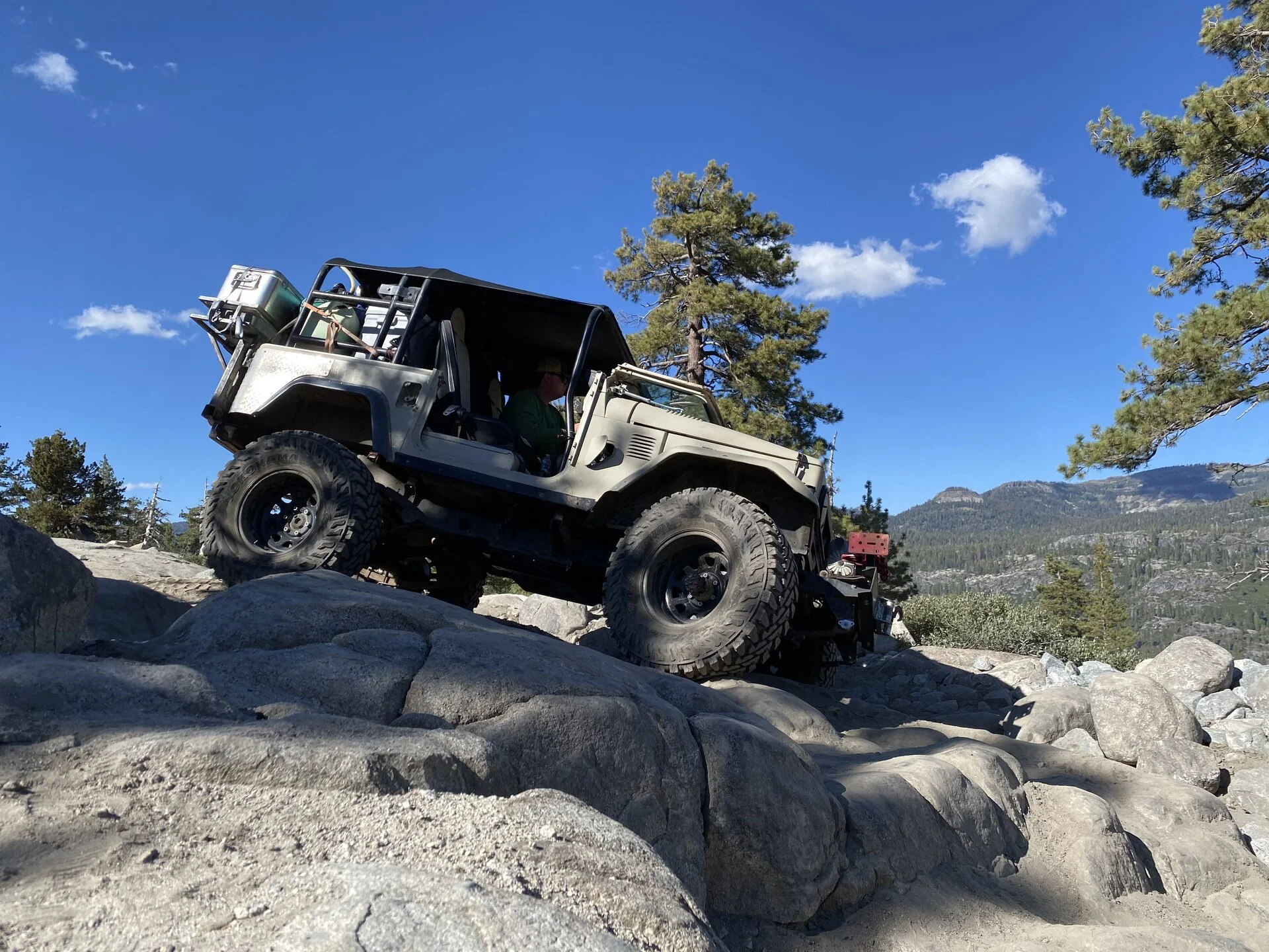

Came into gate keeper and followed behind a 200 series and a few 80's. I was trying my best to keep pace with them but any part that was a non obstacle I had no chance of keeping up but then would catch up to them at various ledges or rock gardens where the big vehicles were a little bit slower being that they seemed to get hung up or diffed on more rocks that the swb 40. This only lasted until the top of walker hill though because they were just so much faster through the sections loaded with the small nuisance rock.

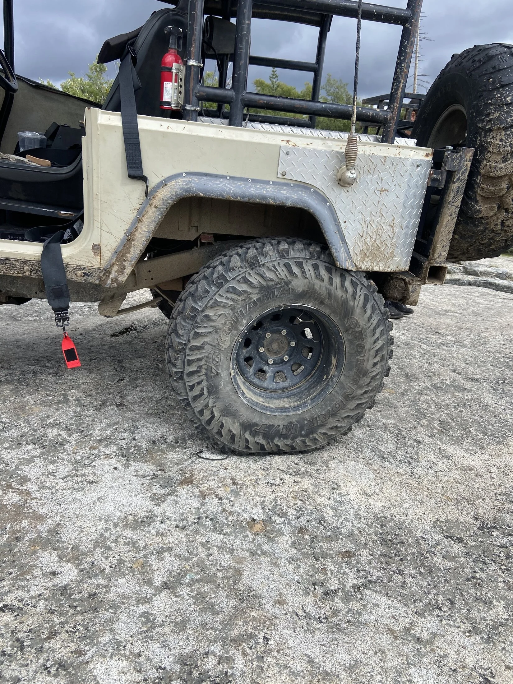

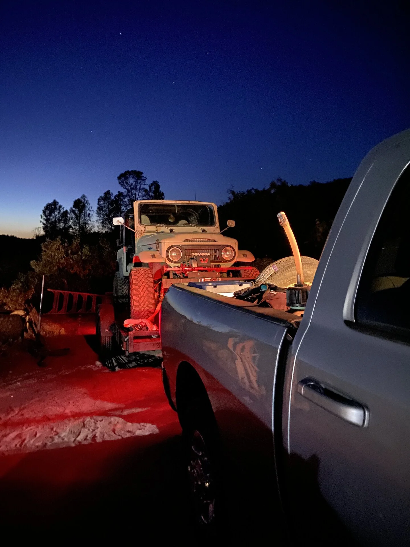

After an early lunch watching people play at soup bowl we ran into a group of three jeeps and an f-toy stopped on the side of the trail. The f-toy had sheared the knuckle studs on the driver side and totally wiped out the trunion bearing. I decided to unload and dig out what I could to help. I had some random knuckle hardware and trunion bearings as well as a magnet to fish out all of the exploded bearing out of the birfield/knuckle ball.
After hanging out for an hour or two and helping out we loaded up and continued on. While watching some hummers run little sluice, the Breakfast run caught us. We hopped into the back of the line and I got my first taste of a rubicon traffic jam.

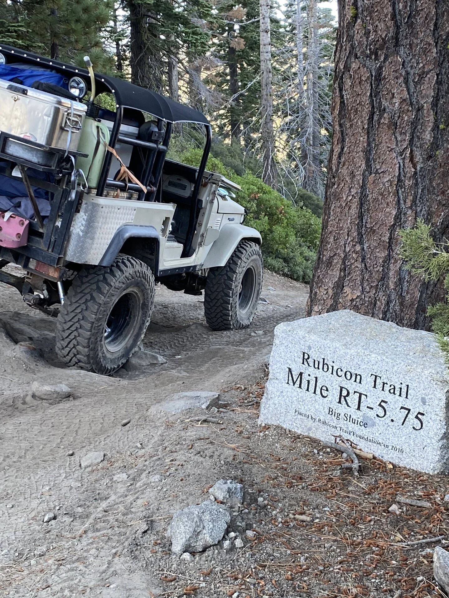

Started Big Sluice hoping to get to the springs by dark....

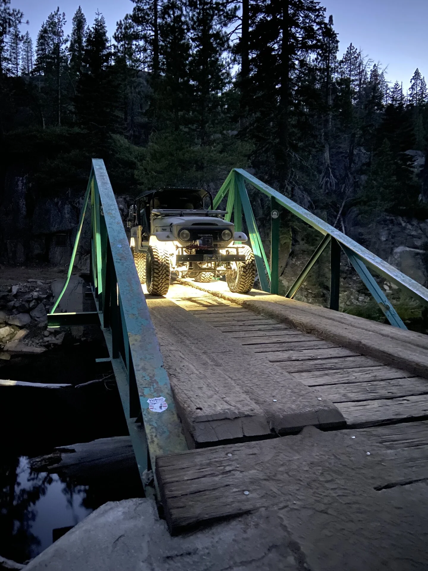

Crossed the bridge before full darkness so I'm counting that as a success.

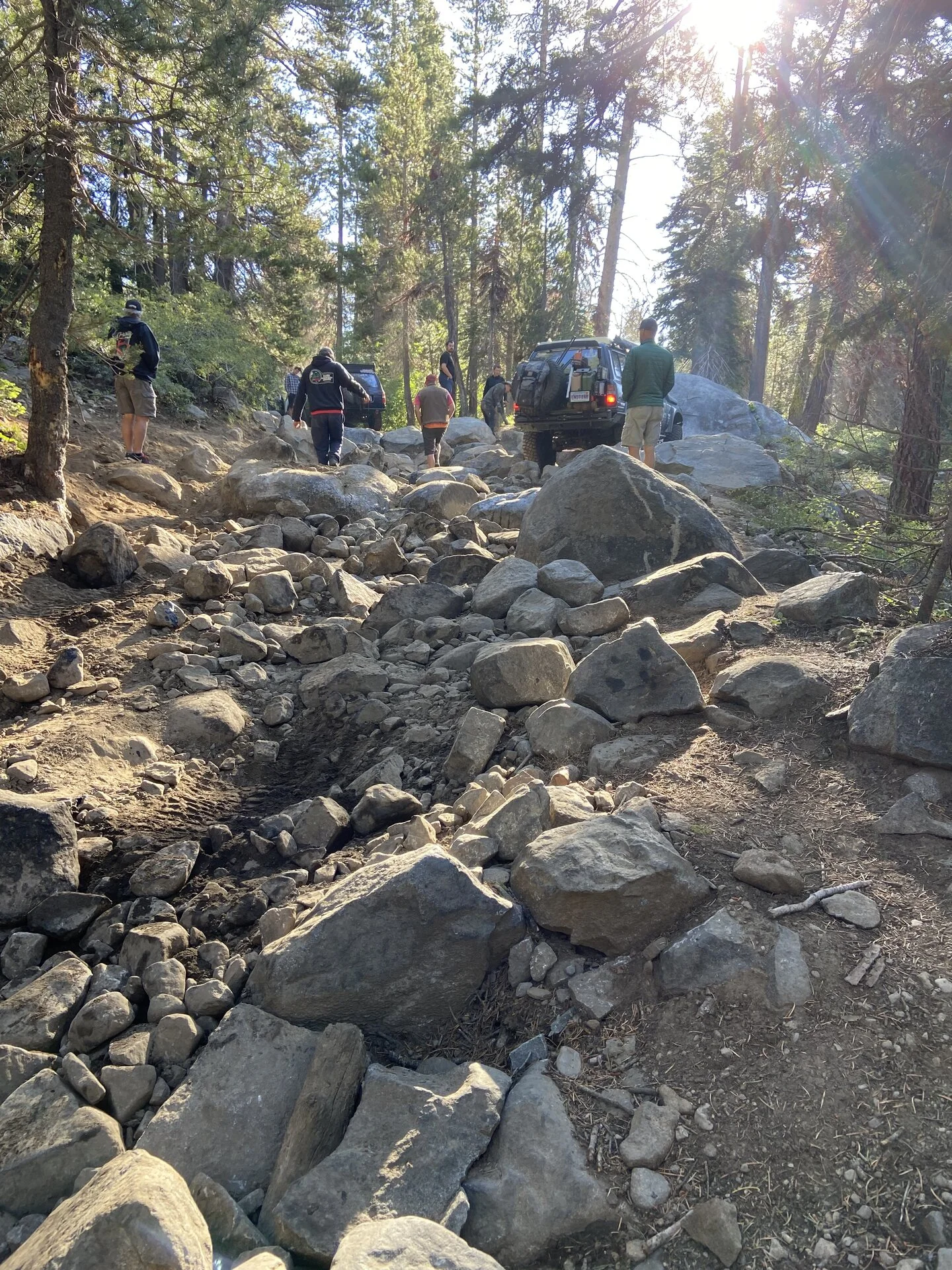

I was camped at DD so got out just ahead of your group, that little section pic'd above was torn up pretty good this year.
It was a fun surprise. Was running out with nobody in front and nobody behind but ran into a little traffic there. It was fun to spectate for a bit.

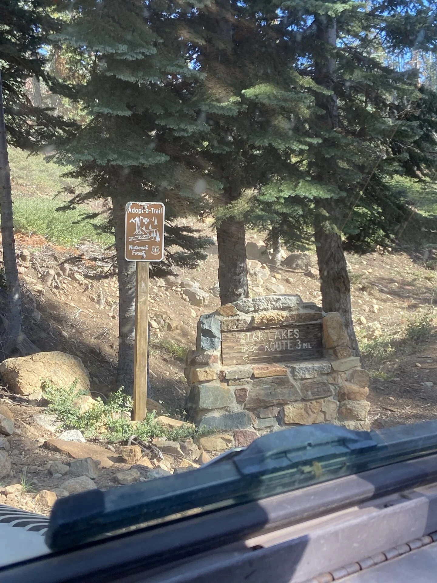

Star Lakes has a blue trail rating but in anything with a rear locker and decent tires its a 2wd trail if you keep momentum. The main goal here is getting one of my good friends out in his Jeep more. He's super green to the whole 4x4 thing so any seat time is good seat time.
Then a few days ago at a friends wedding, I got to talking about my trip on the rubicon and I mentioned how I ran out of fuel.... turns out a friend had a solution to that problem and this came home with me
Rear mounted aux fuel tank. Excited to get this plumbed up. Will be easier than hauling around a bunch of 5 gallon moto cans on longer trips whether it be highway miles or trail miles.

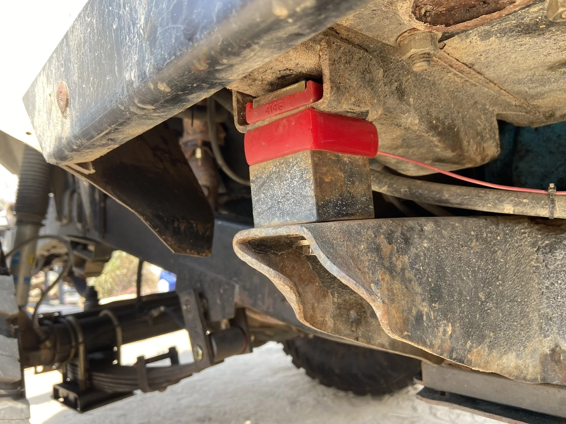

Rubithon Prep Started a few weeks ago now that ski season is winding down. With the snow melting in the Sierras I decided to take the tarp off of the Cruiser and stretch it’s legs a little bit before summer wheeling really kicks off…..
Stretched a little too much I’d say…
I used the winch to pull the axle back into position and found a nice flat spot to set up shop and figure out what to do.
Luckily I wasn’t far from home where I had a spare rear leaf pack that was close enough to put things together. The U-bolts weren’t happy and I stripped some hardware trying to get things out. Ended up using an interesting combination of straps and tools to get things "tight" and limped it home.
I spent the following weekend doing rear bushings, hanger pins, U-bolts, and any other hardware I could freshen up. I also learned that my spare pack is a different lift height (lower) so I added enough from the old pack with the replacement main to get things level. Guess this shows how old and worn out my springs are. Understandable considering they are probably 20 years old.
