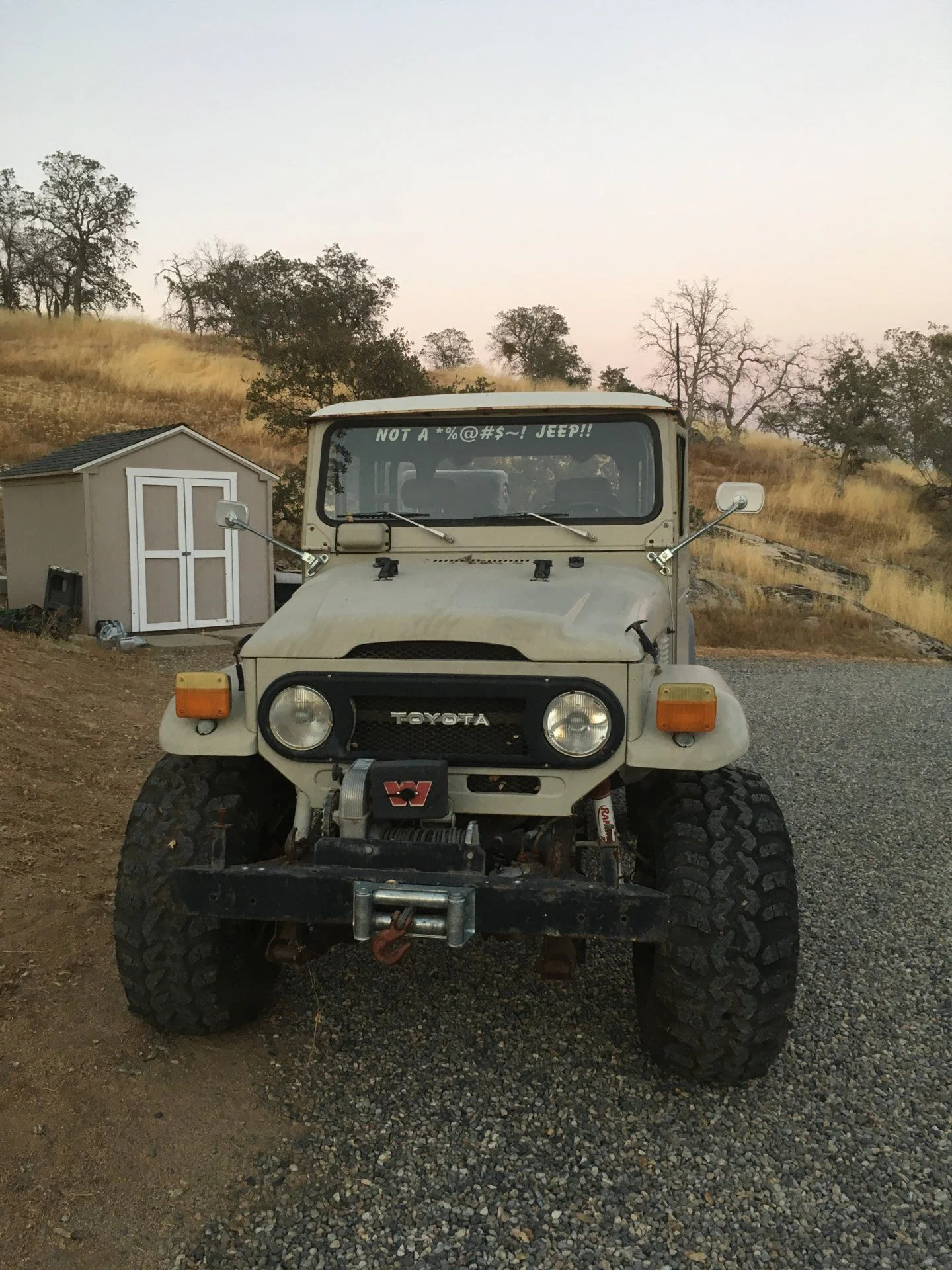

In fall of 2016, a 1975 FJ40 that has been in my family since new was passed down to me. It was built into a wheeler in the 90's by my uncle. Kids and life got in the way of wheeling the last 20 years so my dad, my uncle, and other in their group stopped wheeling and working on their toys. When I picked up this cruiser it had not been turned over in almost 9 years, and not driven really in even longer.
First day getting it tuned up for the drive to my house.
Top off and a tune up later, had it out on some local trails.

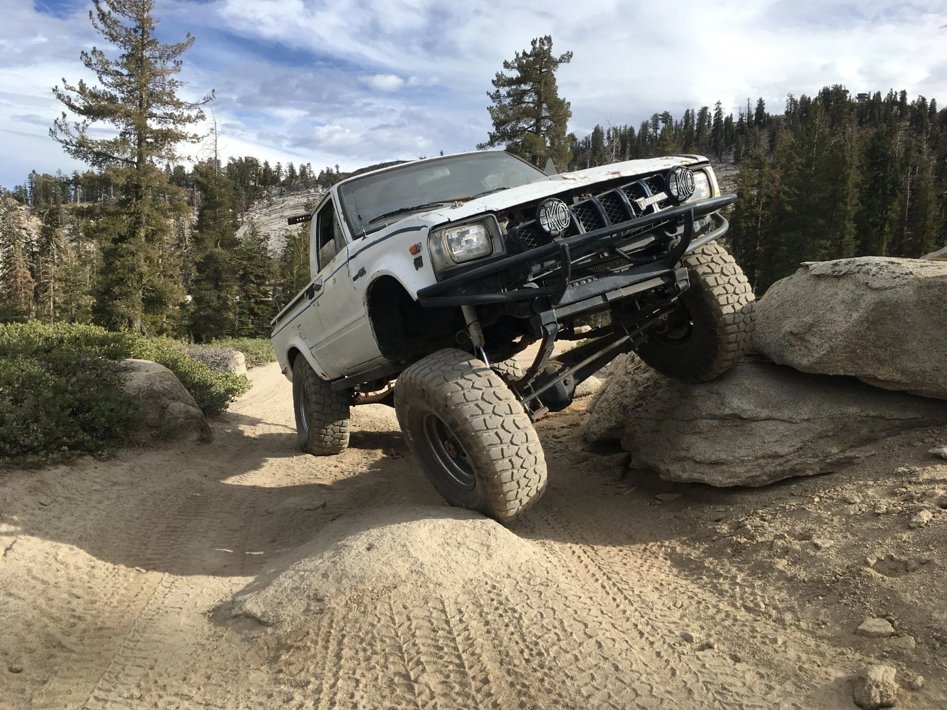

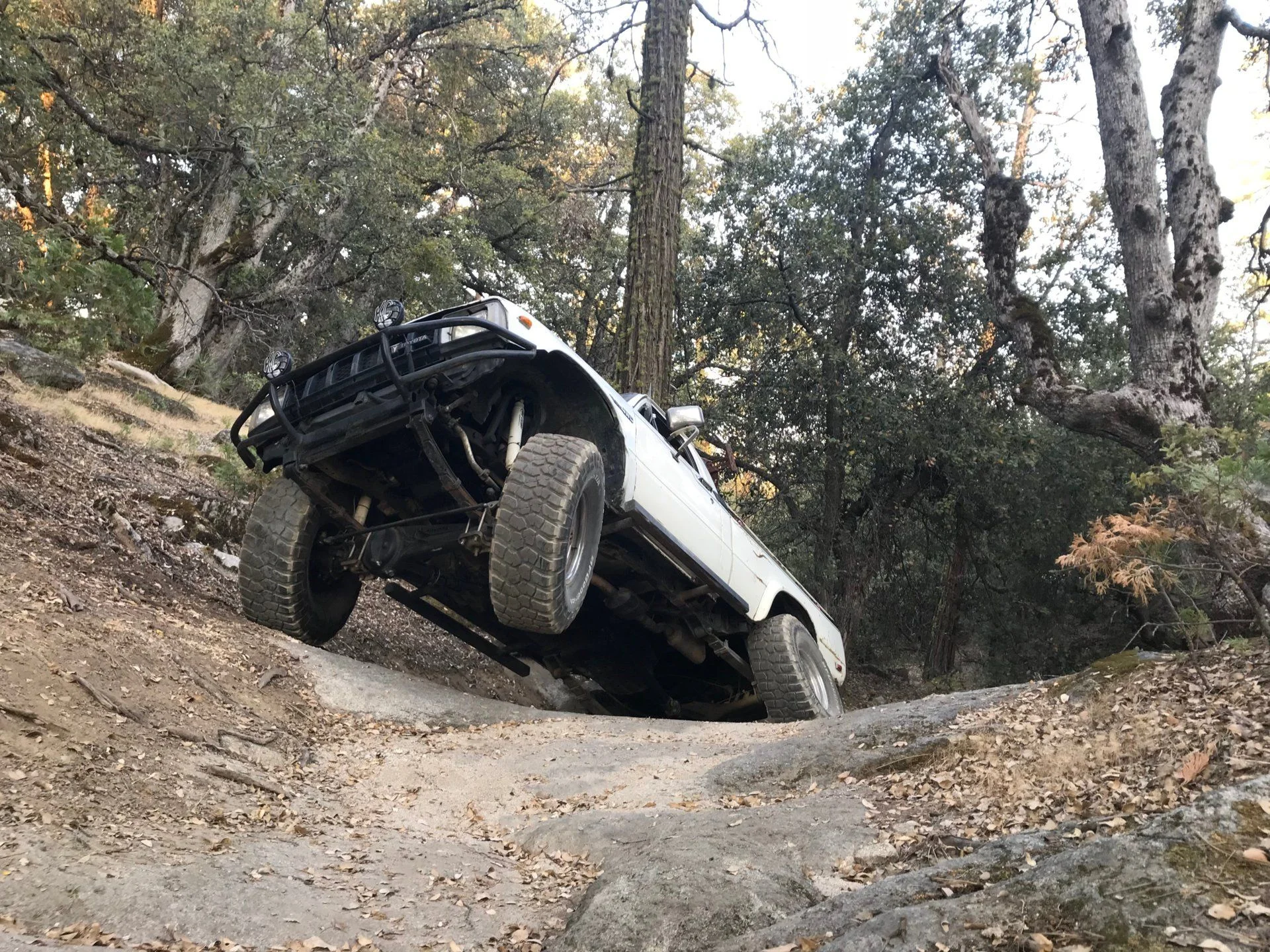

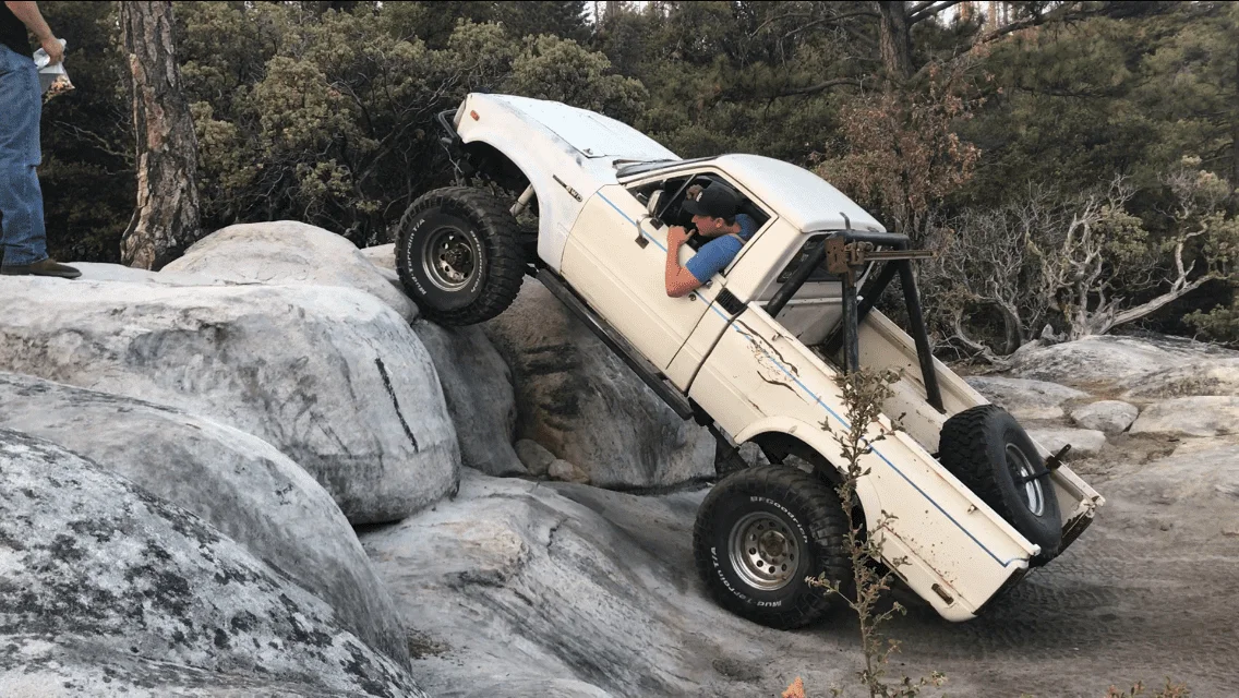

I parked it because I was mid way through another project. My project was my first truck which i bought in 2015. Here are some quick pics...
Pretty cookie cutter mini truck build. Duals, 5.29s, lockers, etc... The shining star of this truck was the 22r i had built. Still slow don't get me wrong, but this was my daily for a long time and I had just about ever goody you could throw at those things besides boost. I loved the look on Yosemite tourists faces when I would pass them on my way up the hill to work in my sketchy looking Toyota.

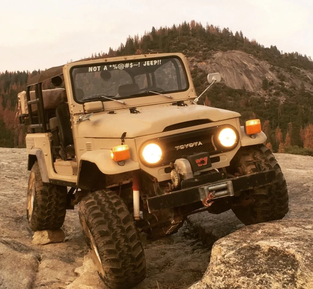

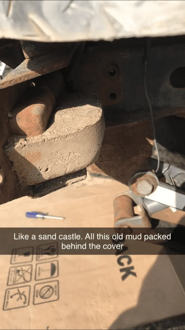

I sold the pickup in October 2018, and got back into working on the cruiser in early 2019. Started with a tune up, change some seals on the engine, trans, and tcase, and going through every bolt on the thing to make sure I wouldn't die on my first drives. By May my transfer case decided to eat a few teeth off the gears so that took some time to fix.
Since then I played with it in the hills a bit, did some snow wheeling, and then parked and started really going through it.
Im about one weekend of work away from finishing my complete re wire with an ez wire 21 kit. Pictures of that process are limited because I was initially trying to get it done in a weekend to go down to KOH (didnt make it). I do have lots of notes so if anybody goes that route and has questions feel free to message me.
I ditched the old broken Holley projection tbi on the 350 for an edelbrock q-jet thats been laying around the house. Keeping it simple and cheap for now since I'd like to ditch my oil soaked, smog era 350 for an ls style enging sometime by Summer 2021.

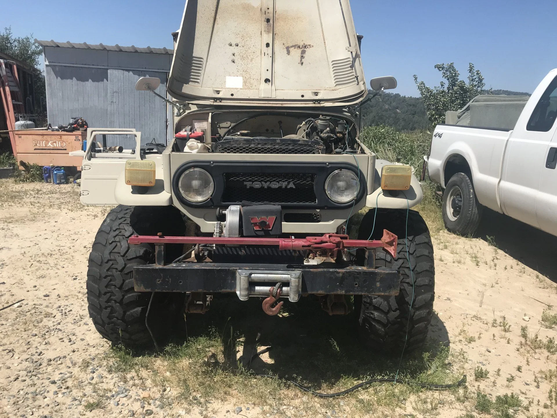

Back to work this weekend.
Plan is to finish getting my fuel system all plumbed up and have this thing running. I should have that done today. After that I'm moving to the t-case. Rear output doesn't seal up so I ordered a speedy sleeve and an output seal from SOR. No concrete at my house, and the carport is full of other stuff so all my project are done in the dirt with cardboard padding. I count it as practicing for trail repairs. I have some new tail lights on the way as well. My factory ones were corroded pretty badly after they spent two years with mud packed behind the cover.

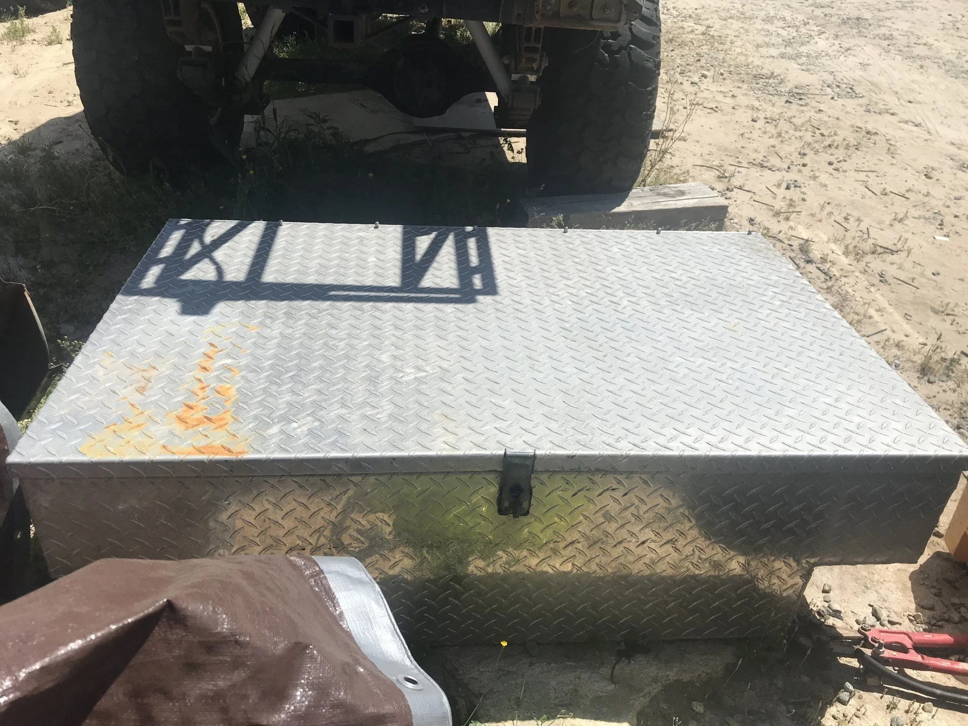

Also, rainy season in California seems to be over now that it is heating up. That means it is time to take the top off. Top off means I can also slide in my rear toolbox and wire the lights for it.
Slides in the back giving me plenty of tool and parts storage. Plan right now is to modify it to have some drawers as well. Set it up to have an upper and lower section, with the lower section having the drawers. Put more important/commonly used parts and supplies in the drawers so i wont have to unload all my camping gear from the lid just to open everything.
