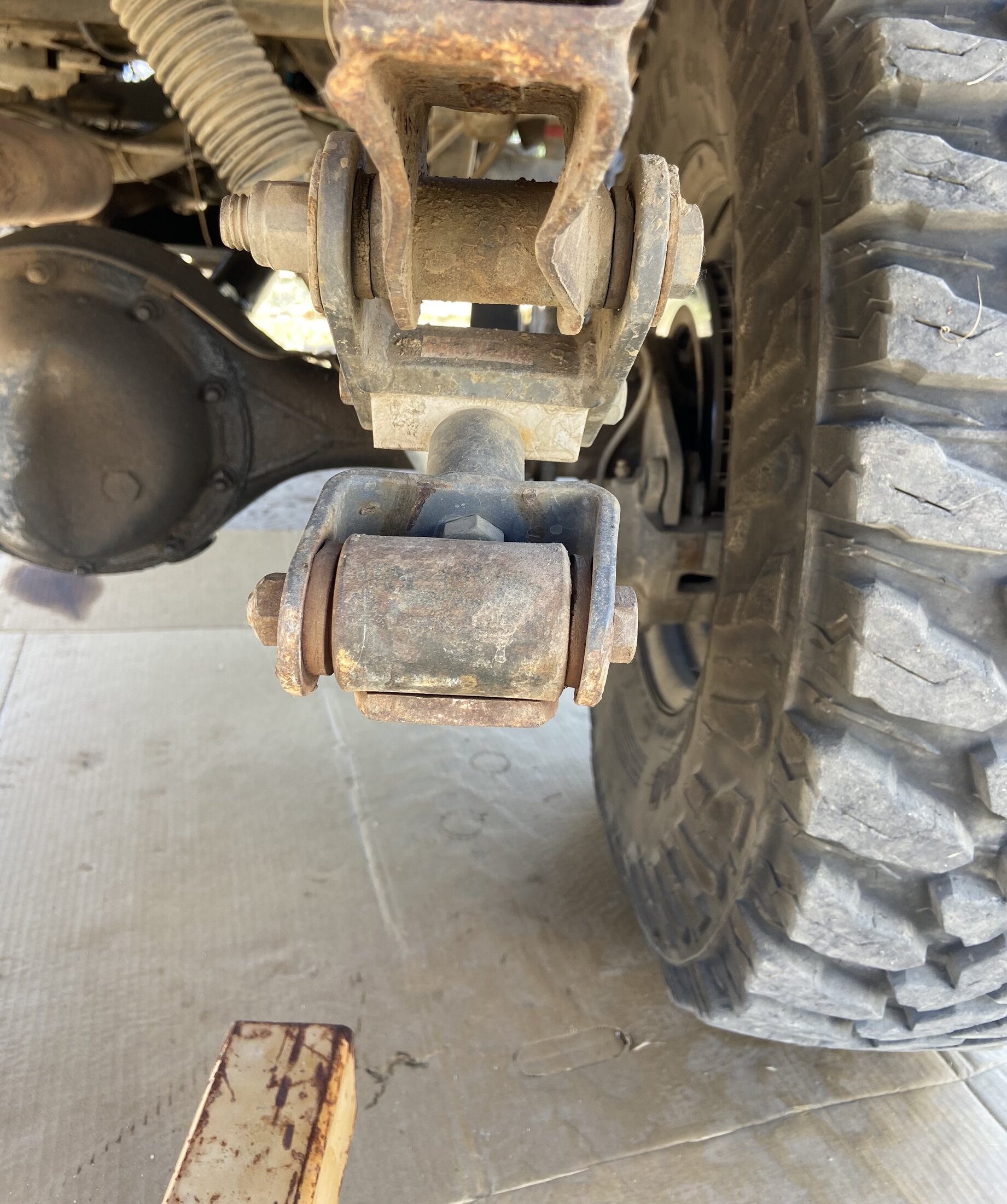

The cruiser has had revolver shackles on it forever and even though the internet makes it seem like they will unload at any given moment causing me to crash and kill a bus full of nuns.... I don't really mind them. Are they the reason these leaf springs break? Maybe. Regardless I didn't feel like changing much up for now and someone local had a set new in the box so I snagged them to replace the hammered and bent ones currently on the truck. The shiny black shackles hanging out the back look a bit out of place but they will fade like everything else soon enough.

Fresh “new to me” Revolvers to replace the bent up and 25+yo ones on the rig currently. Maybe one day I’ll switch things up but I really don’t mind these things.

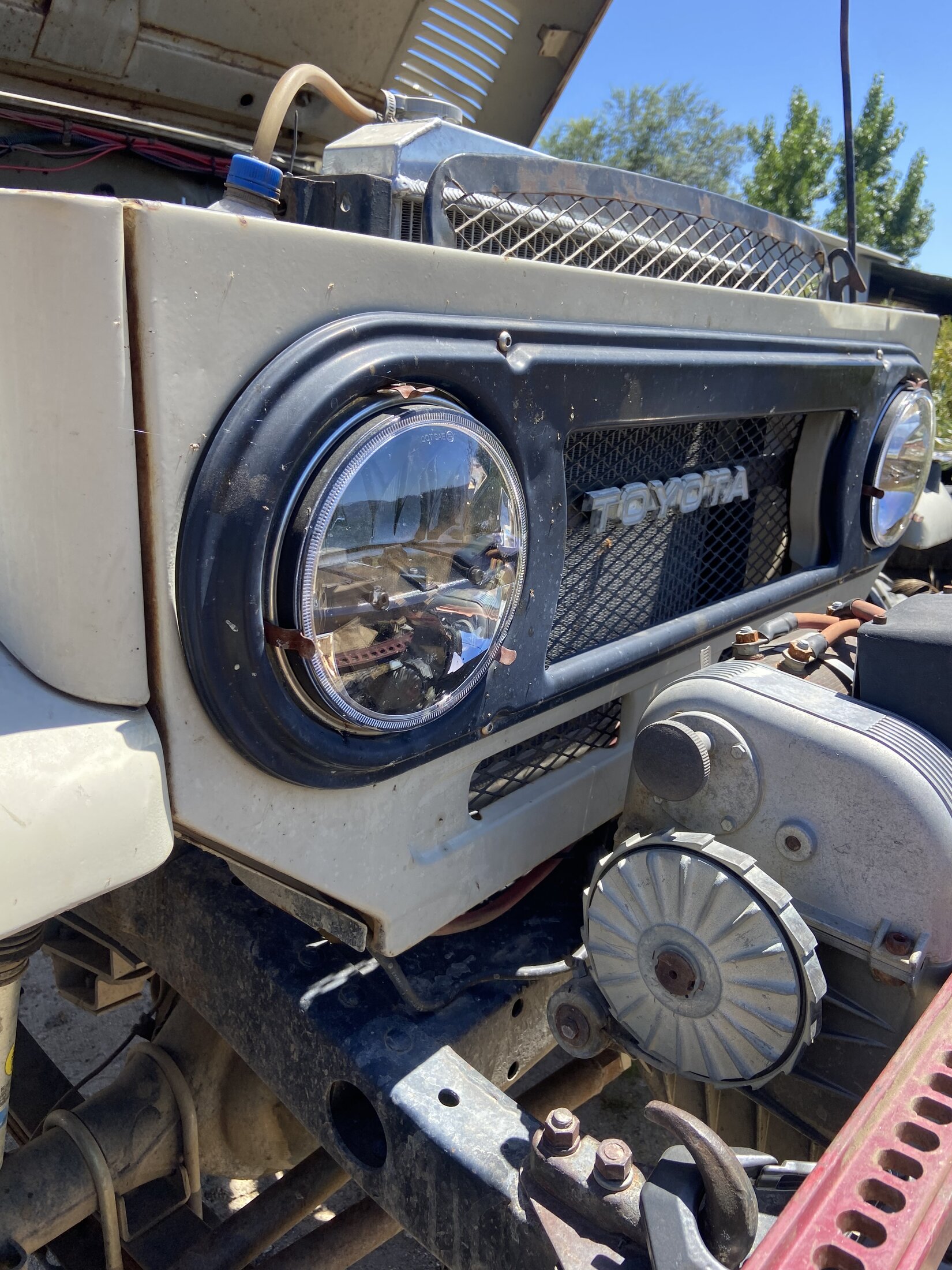

City Racer LED upgrade. Kicking myself for not doing this sooner. Less than 15 minutes to swap and night driving is light years more enjoyable now.

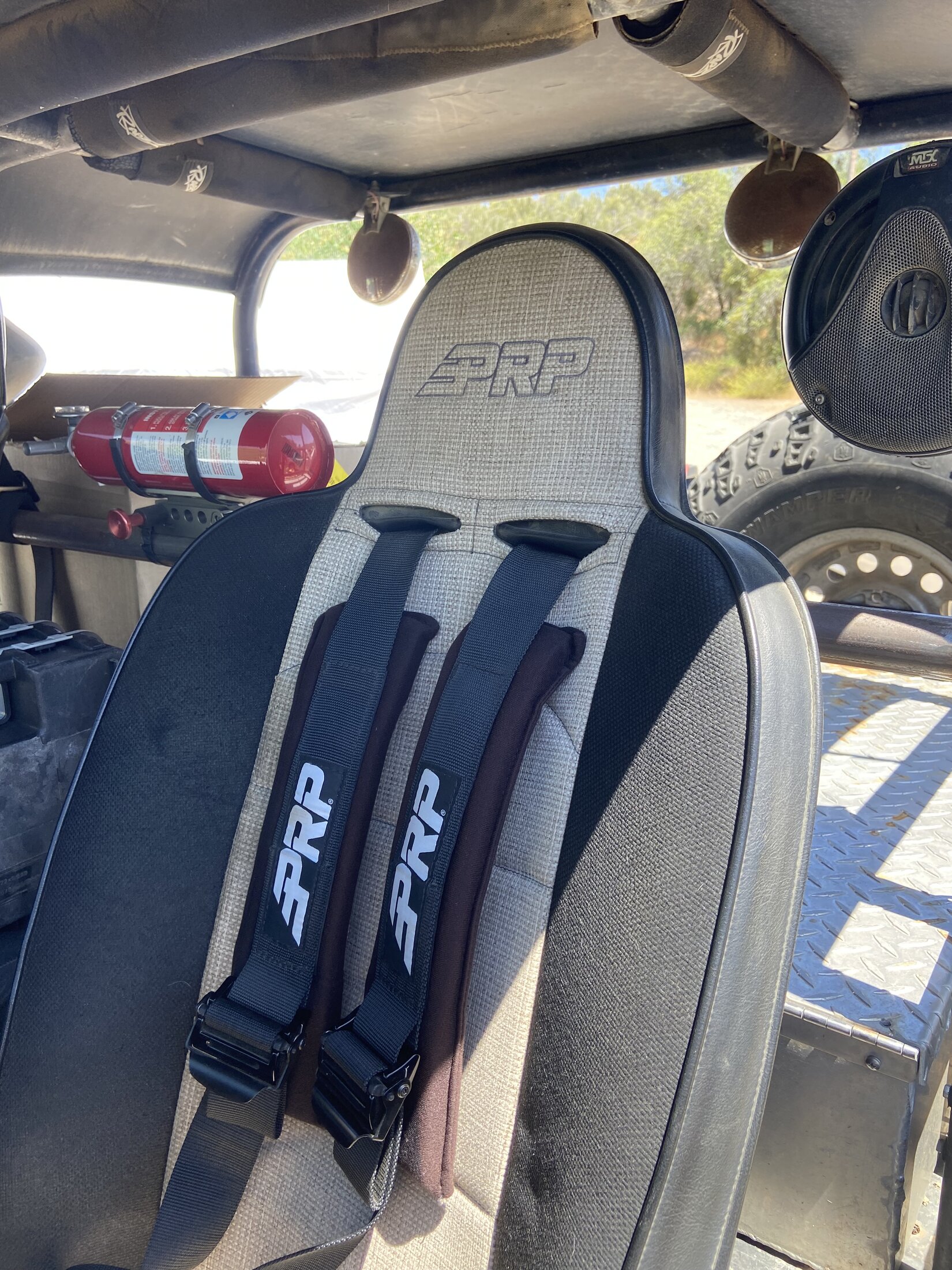

Idk if it’s still going on but while playing around on prp I noticed that the SFI rated 5 point harnesses were only 100 bucks a piece. Idk if it was some unlisted sale, a computer issue… I don’t know. I took advantage, snagged some, and a harness bar. The 3” lap belt with the 2” padded shoulder straps are actually super comfy. Glad I did not do the 3” shoulders. I feel like I would the 3” would bother my neck.

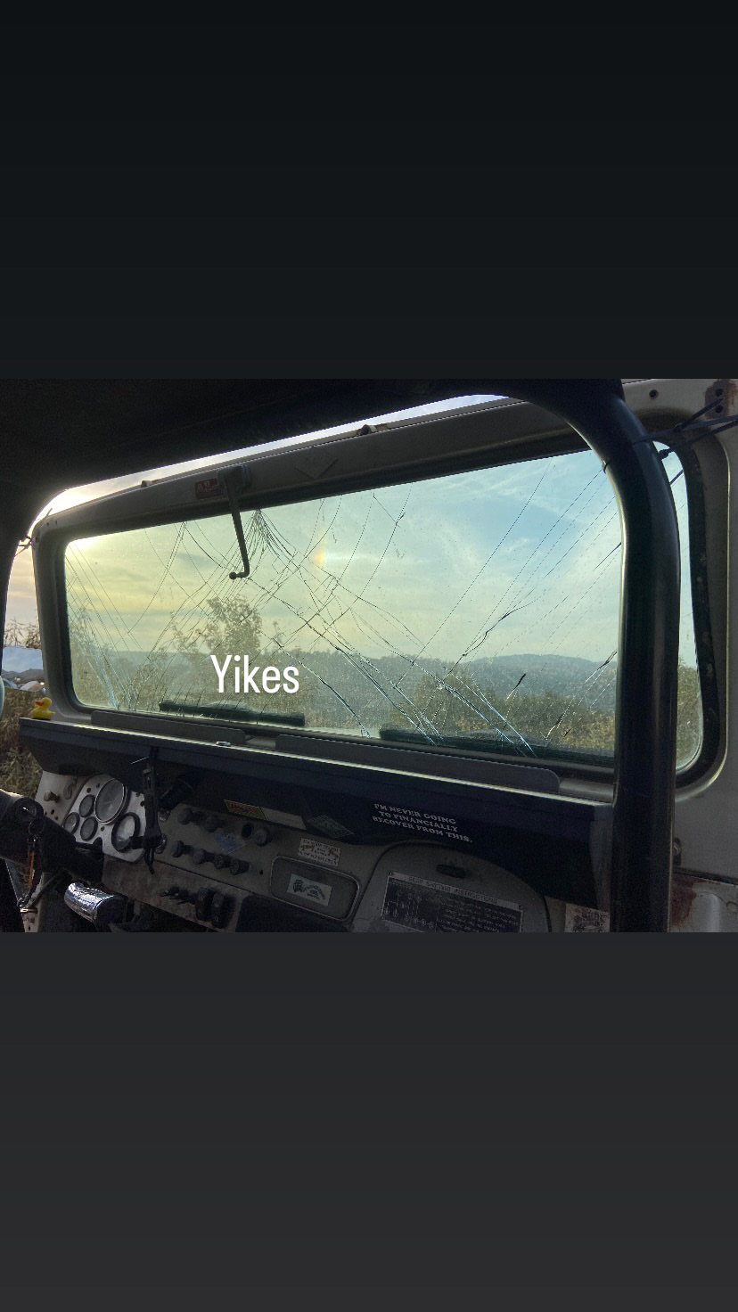

Sorry for the weird formatting, it’s a saved photo from an instagram story. Tight creek bed trail and I got leaned against some trees and tweaked the frame which cracked the glass. I tell my friends all the time how nice wheeling with the windshield down is…. Should have listened to my own advice.

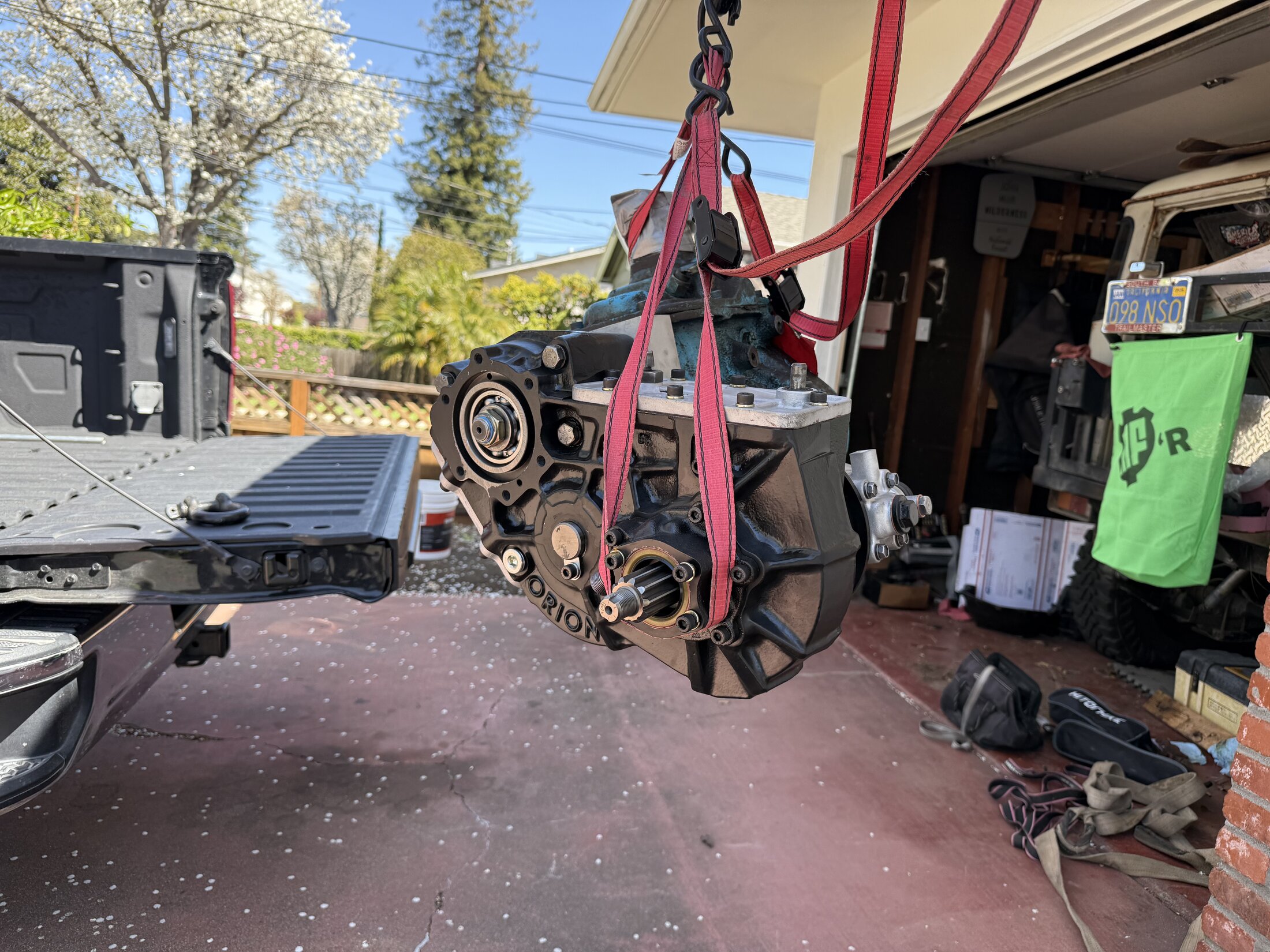

Took the trans/tcase out tonight as well. Headed to Valley Hybrids On Friday for an Orion setup. I thought about doing it myself but I have kind of an oddball batch of parts and an uncommon adapter so I’m handing this one off to the pros.

Orion picked up a few weeks ago. All the little upgrades valley hybrids offers are done to it and got the twin stick kit for it as well. Been slowly tinkering here and there. Got everything in the truck, shifters dialed in, etc. Took a little bit of work to get the shifters set up because I used my existing bracket/pivot. The plate style adapter I have also meant lots of trimming of the linkage.

Issue I’m going to solve today via a call to valley hybrids is my front output. They set me up with a new output flange in the box but it’s a different bolt pattern than what my t-case arrived to them with. The t case end of my driveshaft is the smaller 3 speed yoke to clear the reverse gear hump on the sm420. The large output I have from them won’t even install. Not enough room. Not a big deal as I’m a ways from driving the truck anyway and I know they will make it right. It just never even registered to me to check the yoke at pickup when it was mentioned to me they replaced it.

Little update as we get closer to Rubithon. Got the front output situation dialed in. Called valley hybrids and they got me setup with the proper early bolt pattern and machined the flange down so it would clear the transmission. After that everything was smooth.

Last picture really highlights my need for a new windshield. Surprisingly hard to find anyone that will cut glass for less than 350 in San Jose. I know things have gone up but 6/7 years ago I got cut and installed for maybe 150…. The 350 quotes are just to cut, install is more. That’s a problem for after rubithon though. If anyone knows anywhere to get cruiser glass before I cave and order from cruiser corps, let me know.
