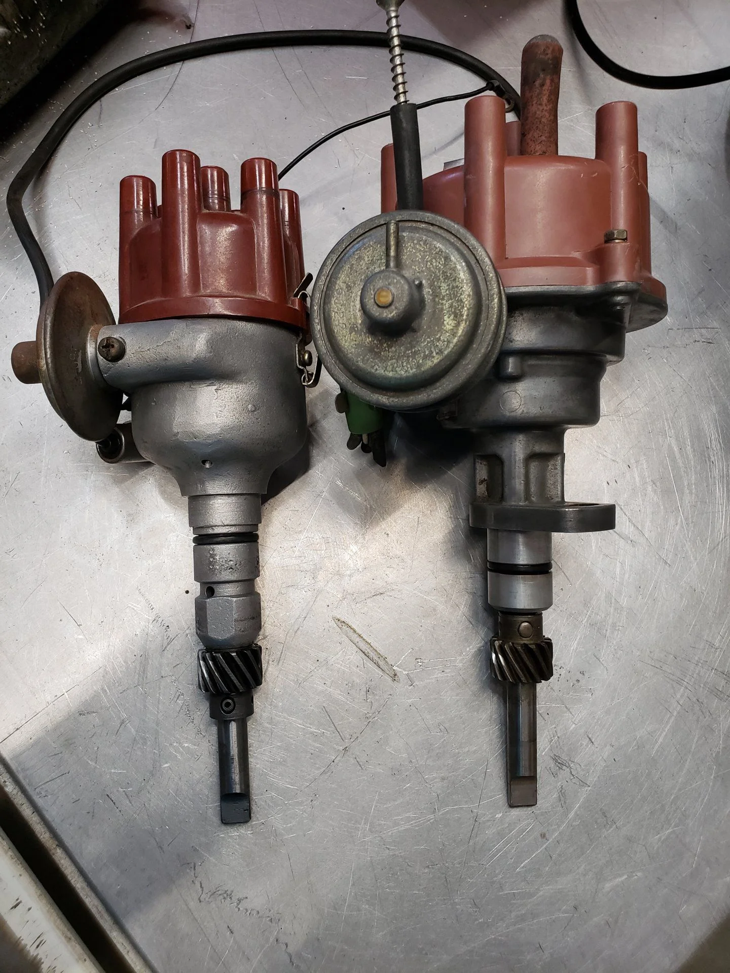

Here are pics of my two dizzys. Is my supposedly 68 dizzy correct? It won't fit all the way in as it is riding on the gear's collar.
Well I got past the O ring. Is it supposed to rest on this shoulder? I have the clamp off while i was fitting it in. Since the clamp goes on the shoulder I didn't think it mattered until I actually mount.
Yes, the early dissy rides the gear on top of the oil pump. It will usually sit slightly proud of the block as shown in your pic.
Note how the gear is flipped between your 2 dissy. That is how to tell if the dissy will register on the block surface or on the oil pump.
Also of note:the early points dissy in your pic is a vacuum retard type.

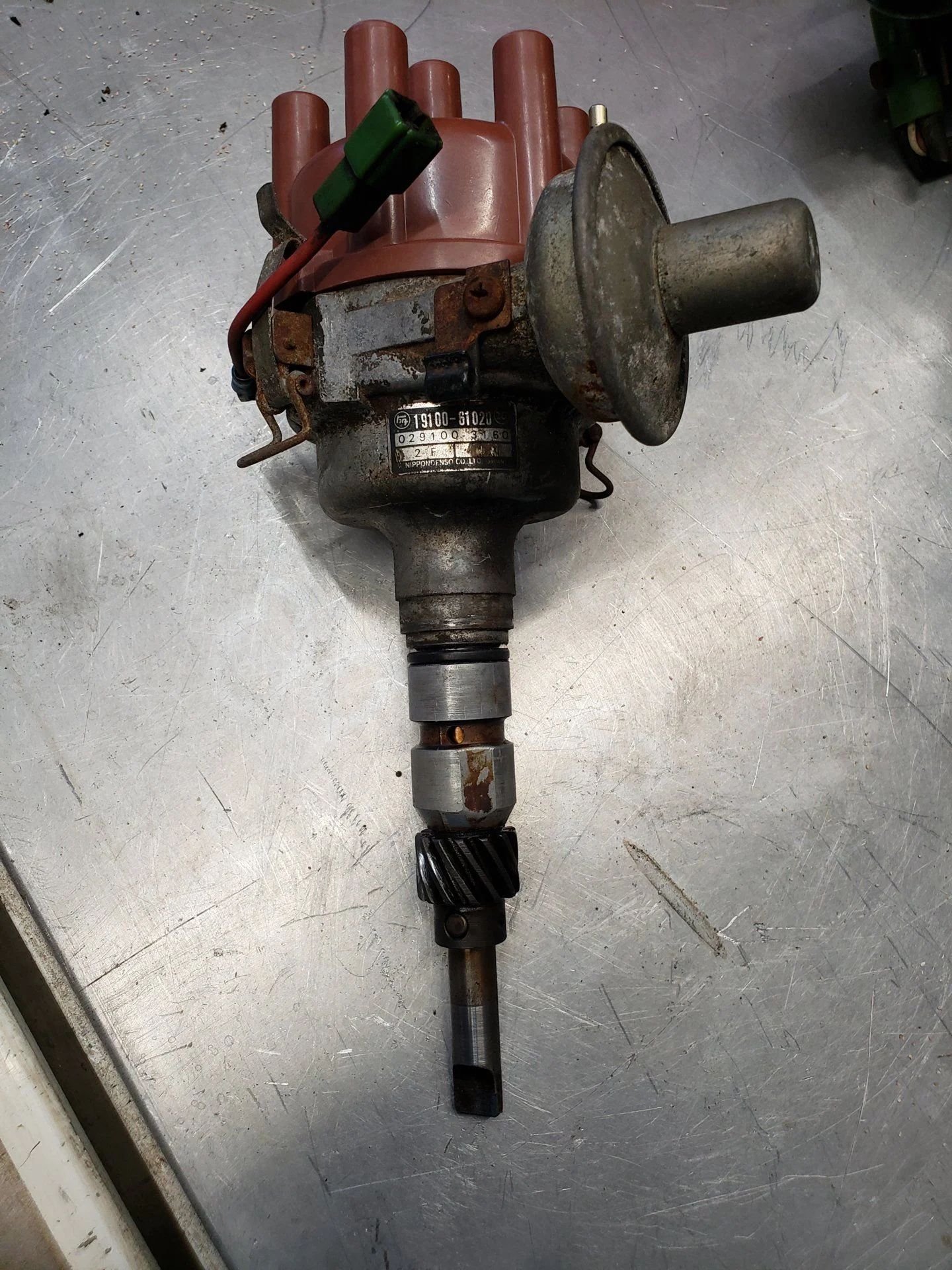

Well that is good information as I dod not know the difference. So, I'm guessing this one from a 75 2F is a vac advance since the vacuum module would be pulling in the counter clockwise direction? And, would this work for me considering the above?
Thanks Rocker. Looks like I need to see JimC sooner than later...my other appears to be a retard too.
The 61020 is a 1975 USA spec vac retard dissy. It is a vac advance body casting, but has a weird vac canister that pushes instead of pulling, to create the 'retard when vac is applied' effect.
