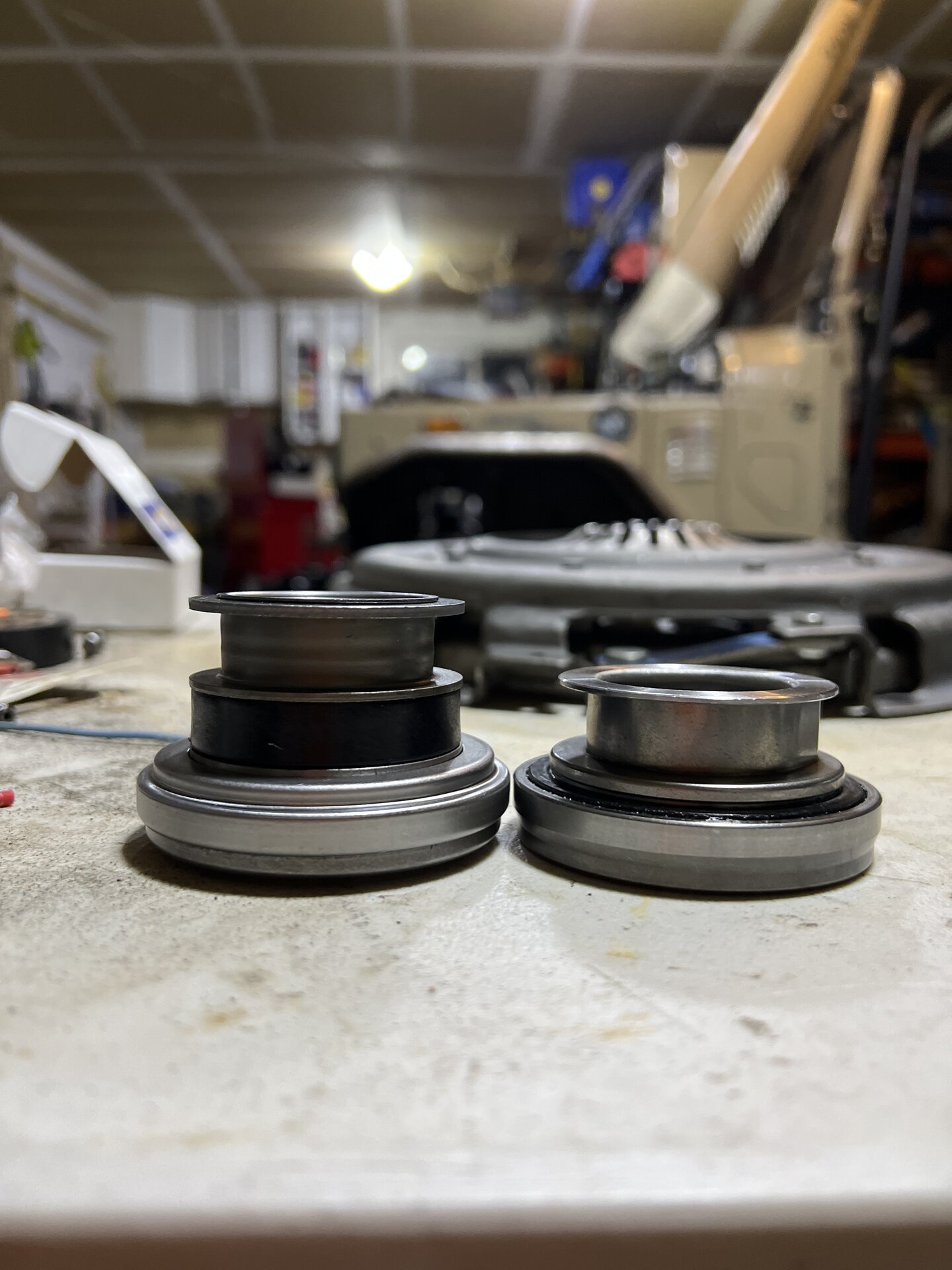

I’ve been beaten into submission and given up on the center force clutch. I’ve ordered the mid to late 70’s clutch master and slave. Have the stainless line and the 11” luk flat diaphragm clutch. Now which length release bearing do I use. I have 2 lengths. I’m using the Chevy cast fork and a stock GM cast bell housing iif that makes a difference.
