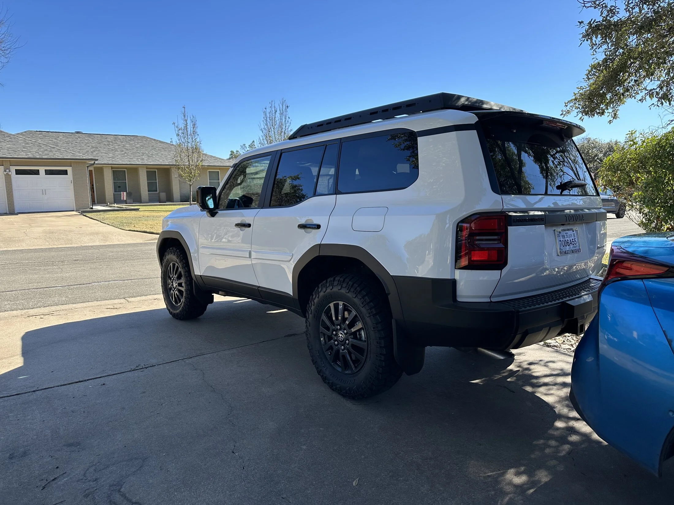

Looks great. Any rub at all? I have 275/70-18 Toyo RT Trails on Methods (likely will get put on the stock wheels, and the Methods will get 285s and go on my Sequoia) ready to go on our 1958 as soon as it lands. Momma no likey that kind of rubbing, so I need to be sure to not offend her sensibilities. :meh:
Zero rub in my driving. I haven’t taken it Offroad to stretch potential articulation, but in day to day city driving there is no rubbing.
Also looks way better without the predator steps
