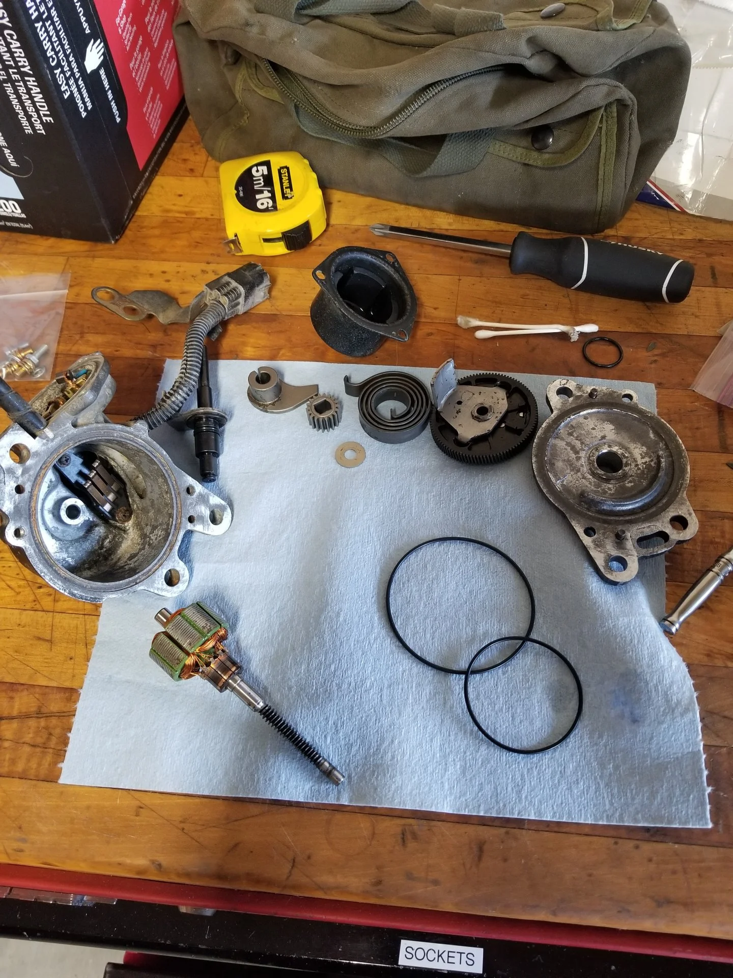

I took a part the actuator and from the reading I have done this one is pretty clean. It had virtual no grease so I was hoping that was one of the issues. I cleaned, lubed and reassemblled the actuator. This time i just pluged it in to test it but once again same results.

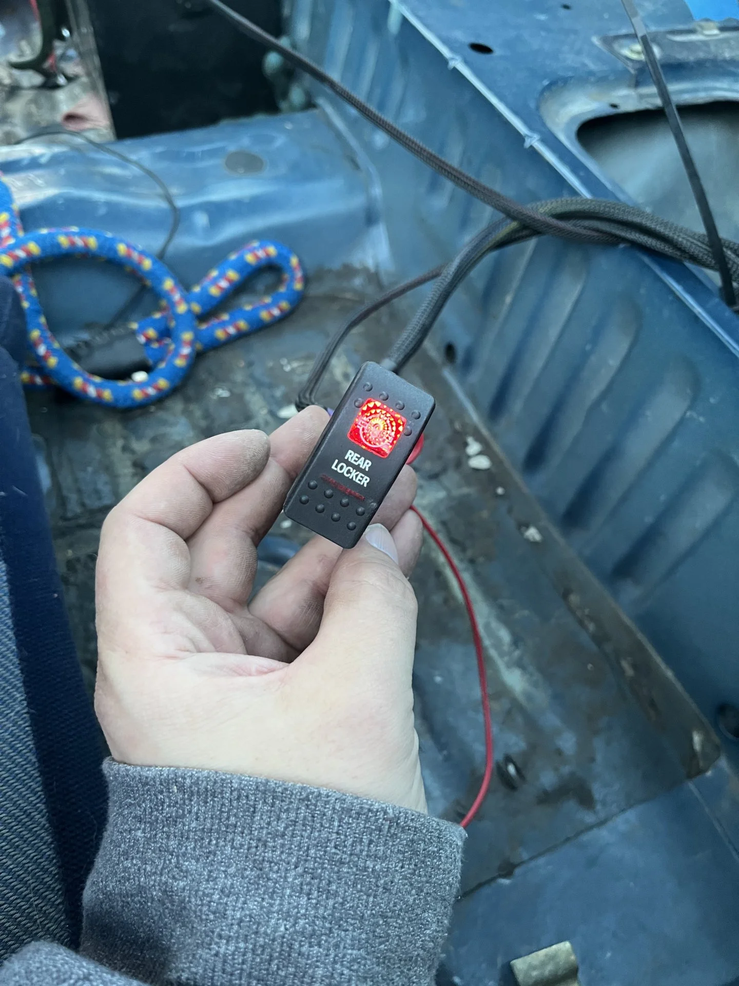

To access both front & rear e-lockers, I bypassed the magic dial and ECU (wiring) years ago and went with a direct 12v current to the actuators.. Using simple toggles on dash now to send current directly to actuators (respectively). Ordered it from "12voltguy." Works much faster and reduces some of the troubleshooting steps. Not sure they're still selling 'em.
I wired two elockers direct to switch. Never bothered with the ECU. Keep in mind that unlike an ARB the electrics don't unlock right away. Sometime you need to steer left and right go get them to go free.
Yea i did the same had a new harness built to bypass the ecu but no dice even with 12v directly to the two pins that control the movement. I just don't see how somthing so simple can go bad especially when it looks like its in really good shape.

Use an OHM meter on those 3 prongs and make sure they still have continuity to the harness plug. Look to see where all the wires are going and make sure they have continuity to their respective spots.
The motor requires 5 wires to work. 1 main ground. 1 ground and 1 power to run the lock side and 1 ground and 1 power to run reverse and unlock.
The motor gets ground through the limit switch (the 3 prongs in the case) so ensure those are indexed properly.
The limit switch removes ground in a direction. So if its in the locked position, the lock ground wire wont be connected to ground anymore. The unlock ground wire will be grounded. And vice versa.
Post up your wire colours and I can tell you what they do.
Edit: Also there should be a tiny spring behind each motor brush. Are those still there?
If you are talking about those Pain in the ass springs that fit in the housing than yes they are there. Had a couple close calls with them. I will use your info to trouble shoot the old actuator when i get some free time.

Ive had one of these motors apart before but I had since forgotten their exact mechanical operation. I am in the middle of rebuilding my rear end and just took my E locker motor apart for service. It appears to only go together one way, although the wiring directly controls the timing. For example it wont turn clockwise any more than maximum and it wont turn counter clockwise any more than maximum. I.e If ts already max clockwise, it will not try to turn anymore clockwise because the ground is removed. Power and ground must be applied for counter clockwise rotation.
To install the actuator into the diff, the gear(limit switch) needs to be installed in the middle of the lock-unlock throw. Marlin has the picture from the FSM on their webaite to index that properly.
