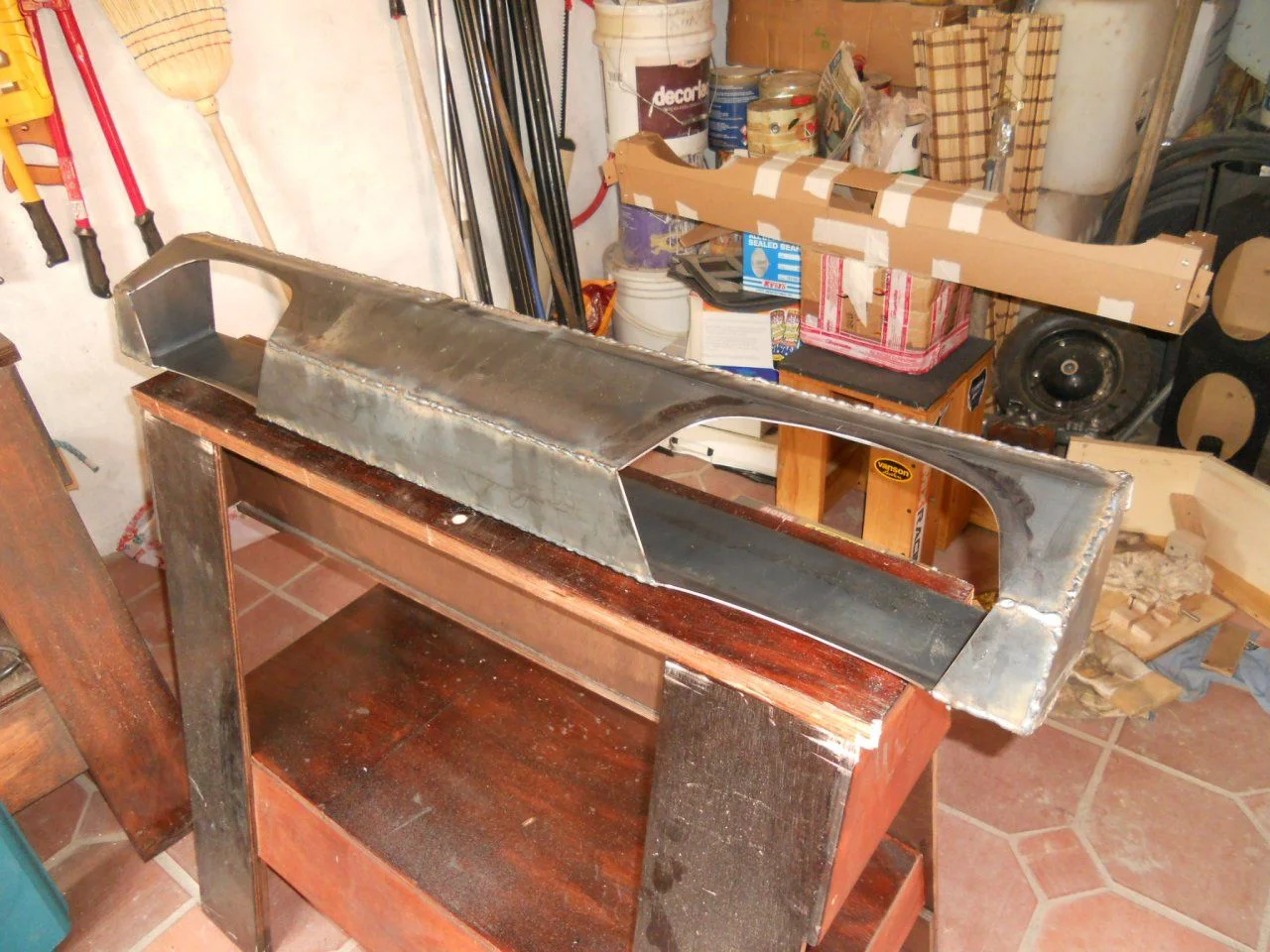

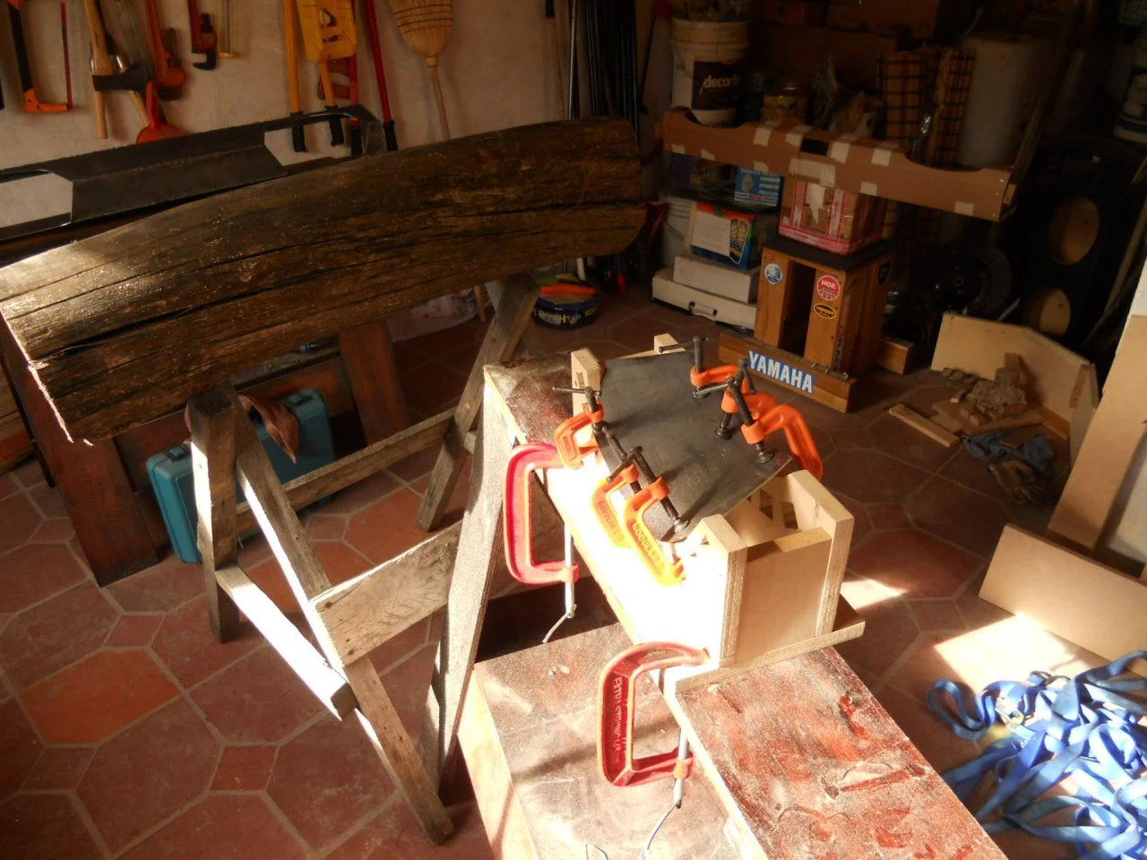

I asked for enough weld to allow me to radius off the corners. Nice and solid now. The real challenge is the trough plates. Yes, I used a log from the burn pile to start roughing it in. I debated on whether to make a male or female form and went with female since that is what I am mating to. However, I think the male would be better and may make another one. I'm using a Bernzomatic torch to heat the material. The clamps get a little busy and I think on the male that would be improved as well. I had worked on it for awhile, still have much more to go but had to knock off and go get the wife. When I unclamped it awhile ago to re-position I noticed quite a bit of springback. Probably not getting it hot enough.

I think a male mold would be far better for what you are doing. I'm a cabinetmaker/installer so I don't know what kind of spring back you'll be dealing with. But, a male mold would more easily lend itself to modification to deal with not enough bend because of too much spring back. MDF is an easy to work/cut item for what you are doing. MDF is also a fantastic thing to use for paint grade trim/panels etc. Sands easily, and with some careful application of caulking along seams and joints, paint sprays on real nice and all the properly prepped joints and seams just disappear under the paint.

I would be interested in seeing pics of what you end up using for forming the metal. My woodworkers background, and general curiosity are coming out to the forefront. Also, I'm very interested in seeing the finished product. I am very much into working with my hands, if you hadn't already surmised that.

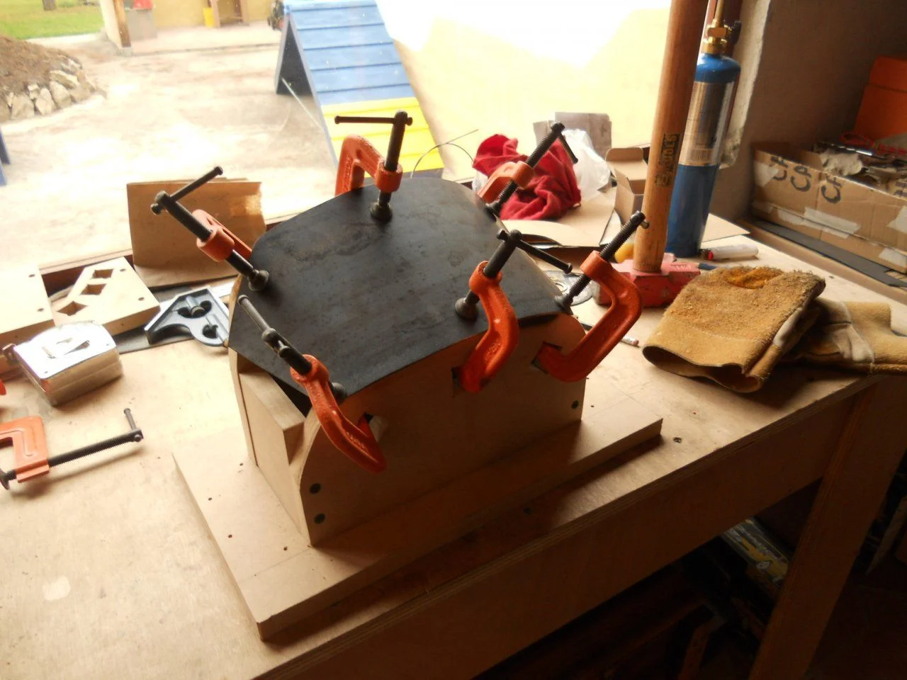

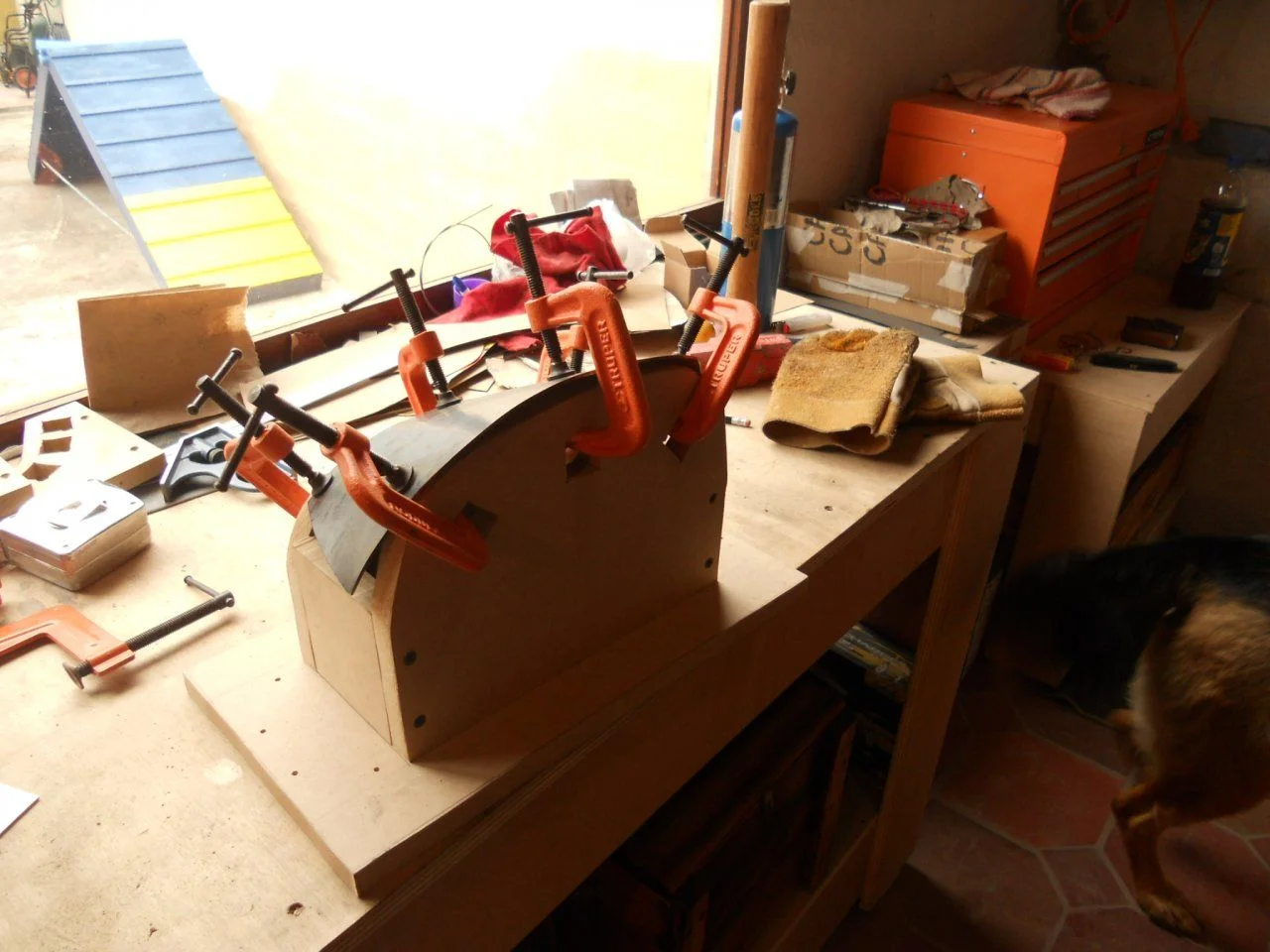

I spent the day yesterday validating Einstein's theory of insanity. While I did build the male buck, I can't get one side the way I want it. The other side is fine and can be welded. But the second side is like I need a radius crease and then lay it back and no matter what I tried I just kept ending up in the same place. So, I decided to try the second plate which was still flat. That went nicely on the buck, but on the box it exhibited the same problem. So I'm going to call "Uncle" and see if Carlos can get it to fit. So I now have all the edges filed and raidused. I just finished making a couple of divider plates for inside, have cut the hinge to length and the next step will be to fit the dividers and start looking at the lid for final sizing.

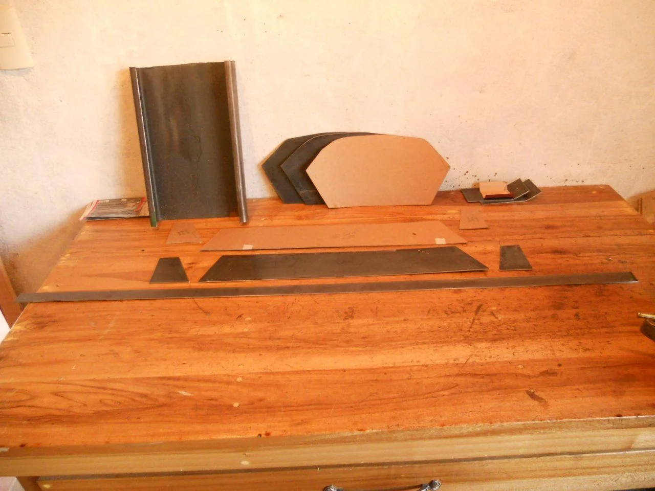

I have the lid fitted and will head for the welder again tomorrow to see if Carlos can get these trough plates fitted and welded. Will install the two dividers, end plates on the lid (unhappy with the way the flanges were forming). Then I will do some more finishing. I wonder if powder coating is an issue for the piano hinge? Since that piece would be welded into place it is not removable for the coating process.

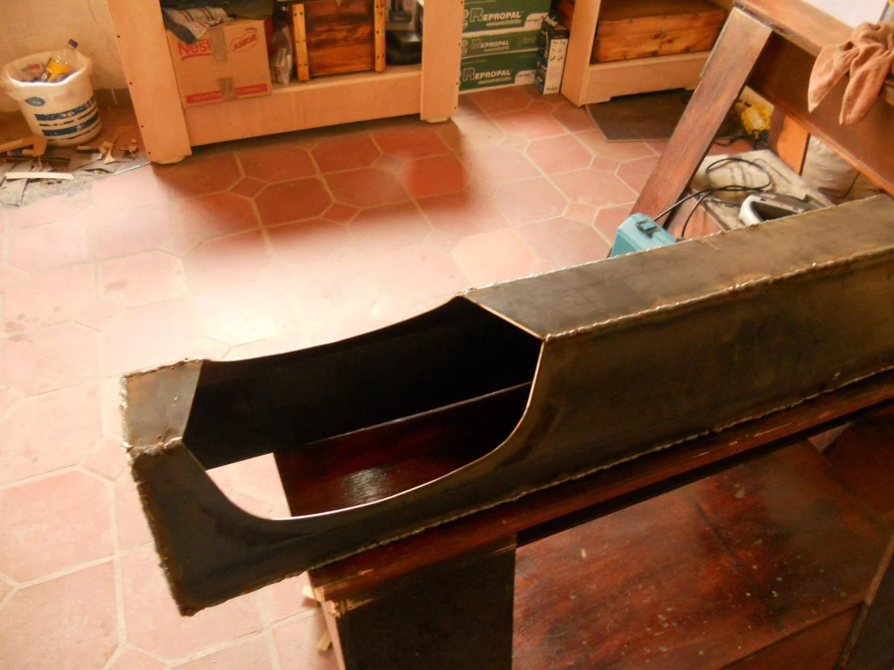

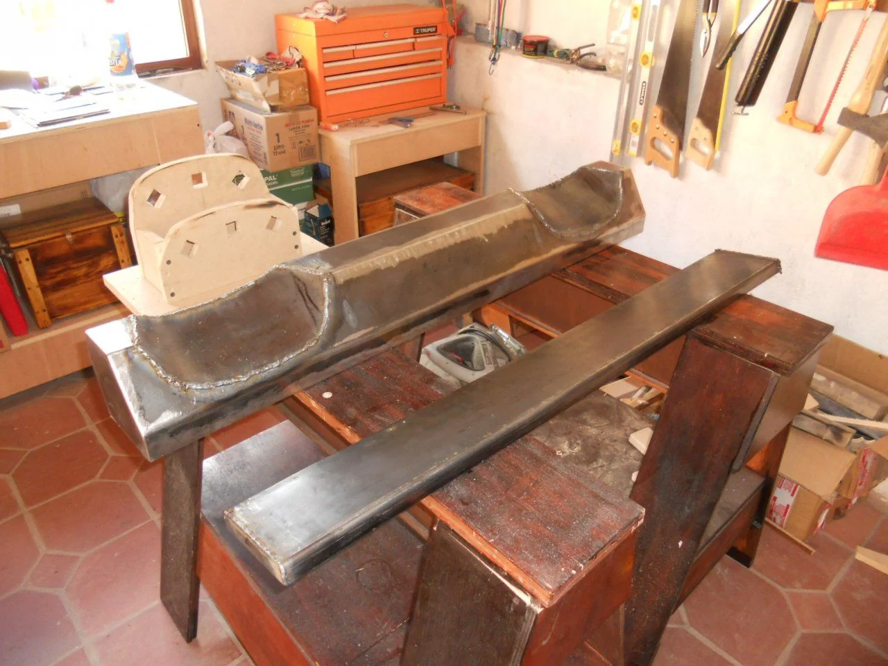

Success! Carlos took a look and just shrugged his shoulders. He looked at my new male form block, saw the plates fit it, saw that the form block fit the box, saw that the plates didn't and set to work. He was using a three inch long piece of train rail! And tapped around on them and pretty soon he set to welding them in place. So I have some more weld clean up to do, again. The ends are on the lid and the dividers are in as well. I have already fitted the hinge but need to find out if powder coating would mess it up. I don't see a good way to screw them together without it looking funky. The store bought units do not exhibit any fasteners on the hinge so I don't know if they are powder coated or painted. You can see the male form block I went to, worked much better but the railway rail or a body dolly, would be the required tool if roll forming on an English wheel didn't do it. So Carlos charged me $25 today so I am at $95 total so far. I can say that the USA made units at $300 is a fair price.
Cuencanolenny, it's absolutely fascinating to me to watch an expert in their field do their work, I don't care what the product is. The expert will make a few moves that look simple (but really are not), and suddenly you end up seeing the beginnings of what the end product will look like. It's just absolutely amazing to me. I love to watch an expert like that do their work.
