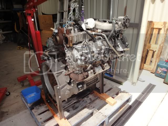

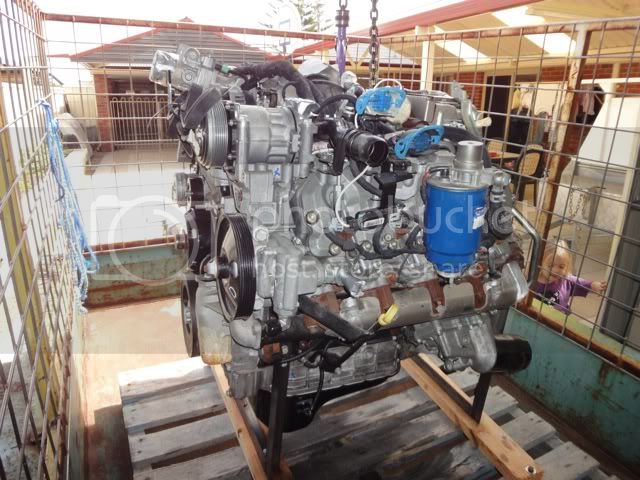

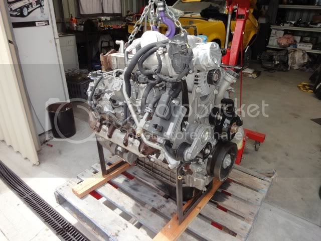

Engine and Trans are finally in my possession. Spoke to an engineer about the correct design and attachment of engine brackets to the chassis rails.
Bracket material can only be a maximum of 50% thicker than that of the chassis rails with attachment to the top, side and bottom to counteract the forces induced by the weight of the engine (both static and dynamic).

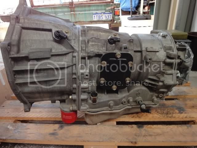

Trans is rebuilt with a stage 4 kit and is good for about 600Hp.

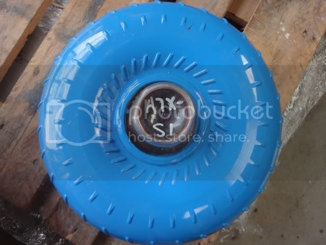

Mike L precision billet torque converter.

You may have already side it but what Allison trans is that? 6 speed auto.... if so drool.....
Thanks!
Yep, 6 speed Allison with a stage 4 kit built by Mike L. at Inglewood Transmissions in Fullerton, CA.
Approximate measurement of the engine are
Length = 700mm from front of crank pulley to back of heads (add 100mm for Turbo exhaust inlet pipes)
Width = 700mm from outer edge of heads (add approx 100mm for fuel filter that hangs on the LHS of the engine)
Height = 800mm from bottom of sump to top of accessories. NOTE: the bottom half of the sump will be removed and a new reverse hump pan will be fitted to clear the front diff.
