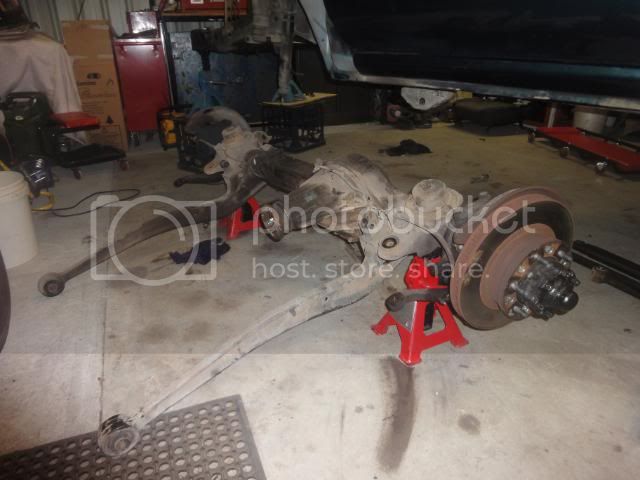

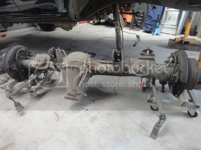

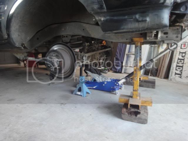

The next job I did was remove the front and rear diffs

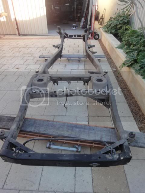

Chassis out

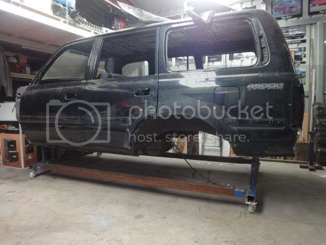

Quick frame knocked up so I could move the body around.
