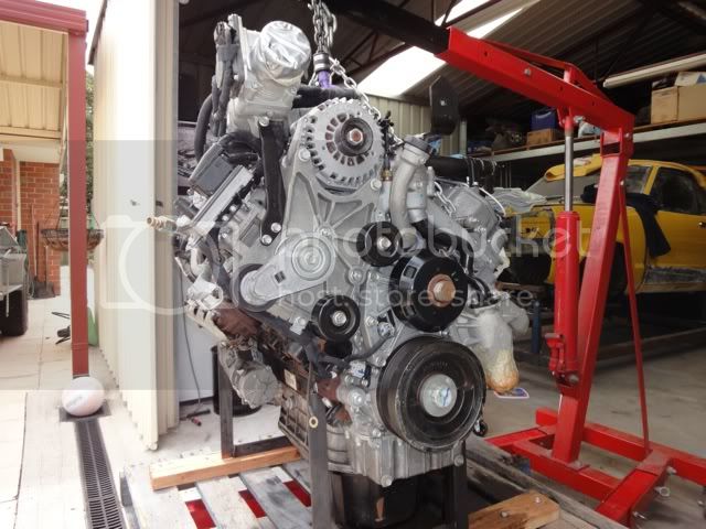

The one below is the only one I have taken from the front. I have already removed the accessories from the front but I can take another from directly in front if you like.

Awesome build Brad, interesting that the fuel filter and primer pump assembly are on the opposite side, I guess they have to be to accomodate the RHD steering shaft!
