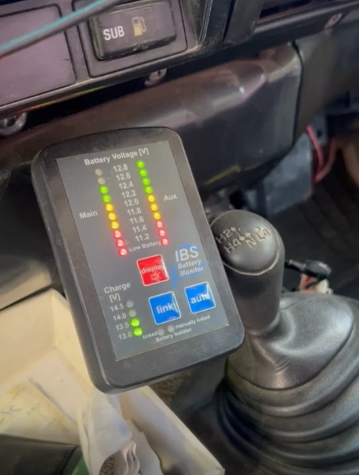

these are the two pictures of what my IBS is reading when my engine is turned off and solar is charging the aux battery.
usually the charge and link light stay on together, but here they keep alternating every 30 seconds.
and as you can see, when they are not linked my start battery seems low, but in reality i have been using the car all day before these images.
so something is draining my starter battery and i cant seem to figure it out.
are the battery voltages measured with dedicated leads to the batteries or is it just at the IBS device?
And what is that "charge" voltage, exactly, if not at the batteries?
So the relay of the dual battery system is connected each battery and then connected to the IBS display.
the charge voltage shows you how much charge is going to the batteries.
when the relay detects a voltage of 13.0V or higher the relay kicks in and connects both batteries together.
it works both ways, so if it feels the charge from the alternator it will 'link' the batteries and same goes with the solar input.
the strange thing is that it either shows charge but not linked, or linked but no charge, usually both LED's should be on the same time

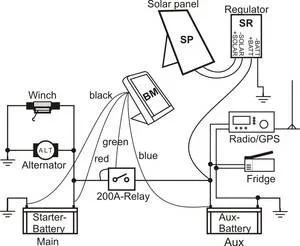

After re looking at this diagram, I actually have the negative wire from the solar charger/regulator connected to the negative terminal on the auxiliary battery, would removing that connection and hooking it up to a ground on the chassis fix this solution?
That doesn't sound like a factor. In fact it might make things worse if your grounds are less than perfect as the solar controlar might not get an accurate voltage reading.
It sounds to me like you have a parasitic draw on the starter battery. It doesn't sound like there is anything wrong with the IBS or the Victron.
I would put the solar/dual battery stuff out of mind and diagnose for a draw. You can disconnect that stuff while you diagnose or leave it in place - shouldn't matter.
The aux batt neg should be tied to chassis ground so no matter where the solar controller picks it up as long as connections are good. FWIW for me picking up ground at a battery terminal is bad just cause of corrosion unless you have agm or Lipo then that isnt such a concern. I have my solar controller grounded to chassis very close to controller.
The only thing I connect to the neg terminal on a battery are the engine/chassis grounds, so I agree with you, but in this case I would make no changes until the root problem is solved because:
1) we don't know the state of the vehicles grounds. if bad they could make troubleshooting more complicated
2) it is unrelated to the problem the OP is having
I'd look at battery recabling after determining what is draining the starting battery.
I would too but ... one thing at a time. This stuff about grounds is a distraction from troubleshooting the issue the OP is having.
OP needs to figure out why the starter battery is discharged. Bad battery, parasitic draw, or alternator not charging.
No it won't. But you should do it anyway. Personally I'd avoid getting distracted optimizing things unrelated to your problem until you have your problem diagnosed, but that's just me.
I re read the original post and it does appear his starter battery is crap. Grounds would not fix that.
