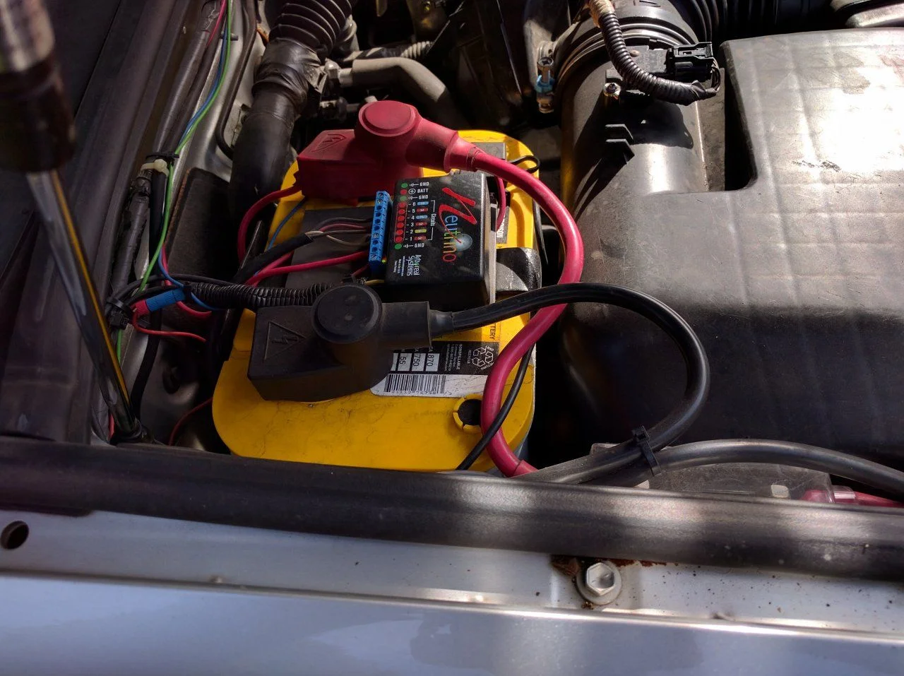

Here is the setup in my car, the previous owner had installed a second battery in the top left location of the engine bay.
that looks familiar :P

that is an idea, but I was thinking of putting the air compressor there, that why I am looking at putting the battery inside. I have done some measuring for both and both seem to be able to fit in that area.
