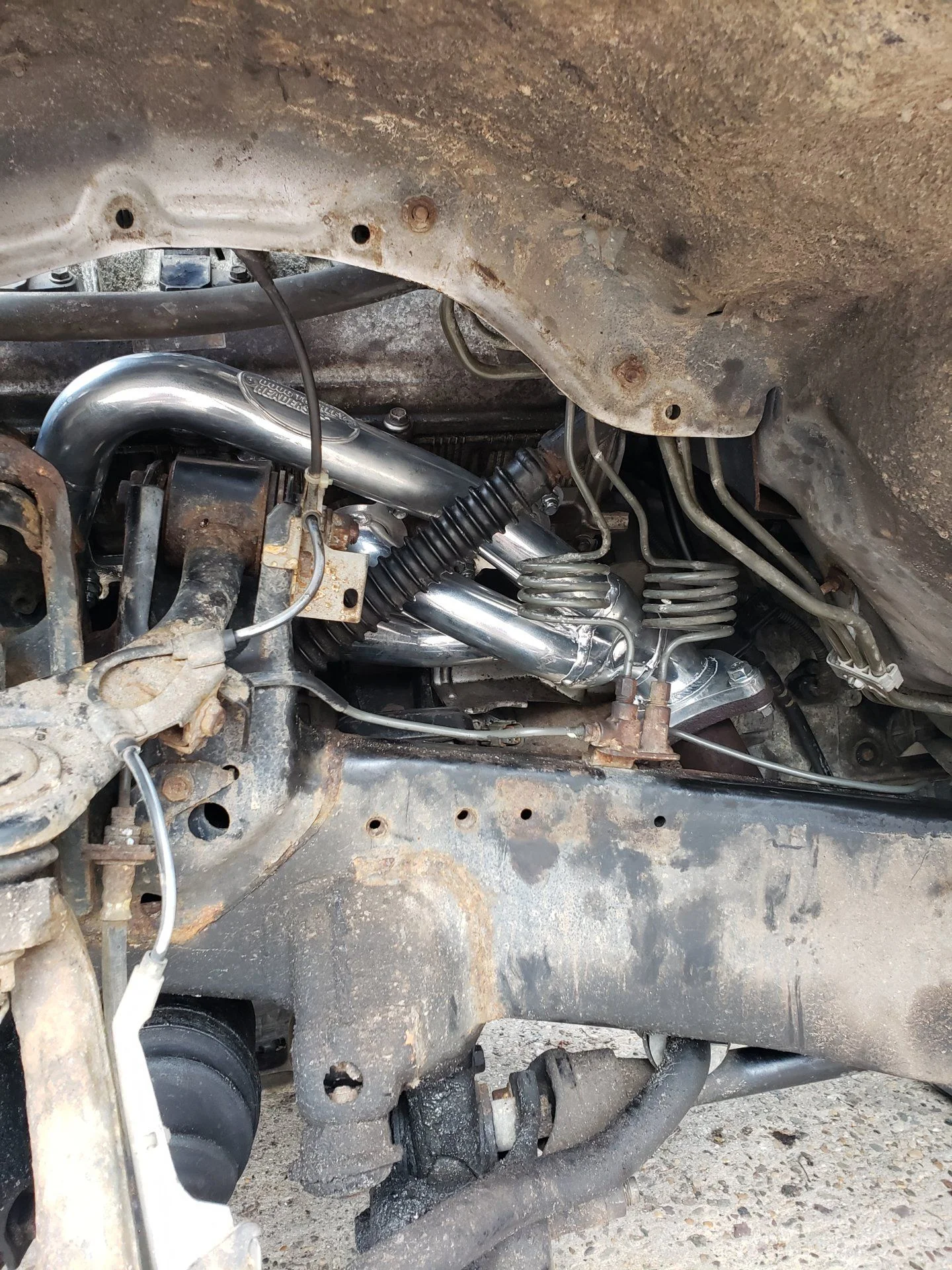

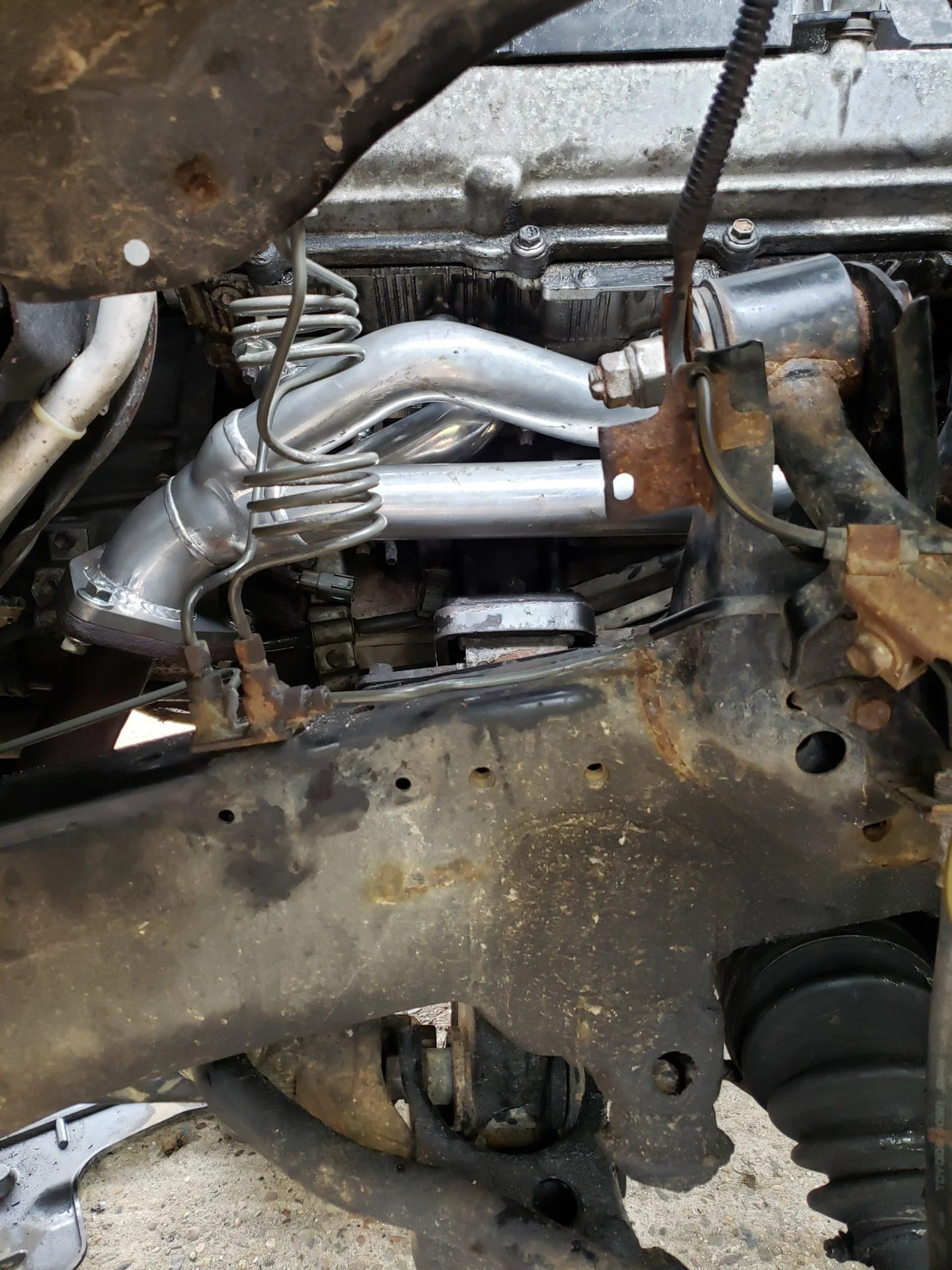

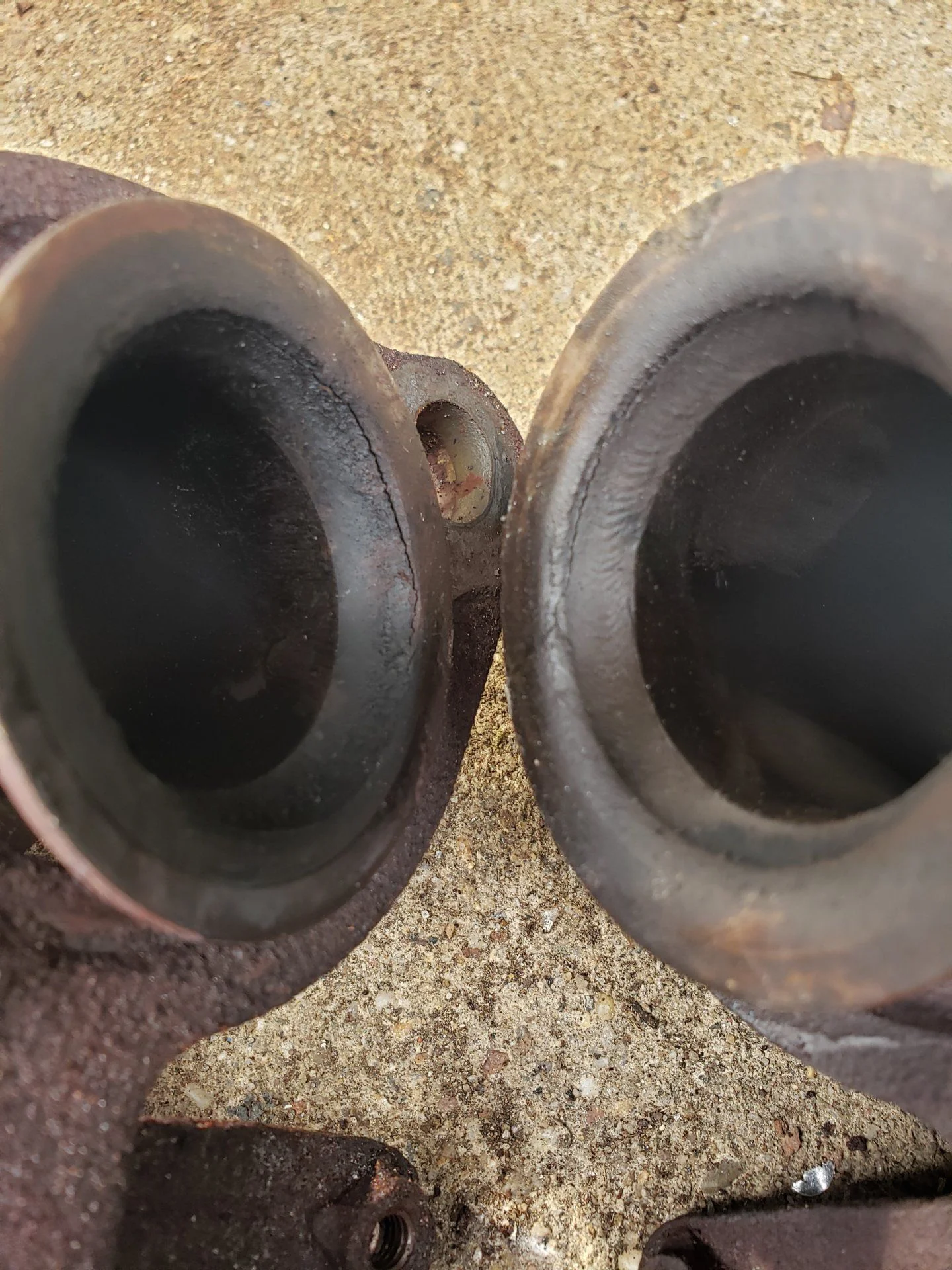

What a bear this job was and I was a mechanic for 10 years. My whole body aches. Granite I did the whole job on a jack stand. Both old manifolds were cracked at the front ports.
1952484
Non Vvti. Nothing was rusty that mattered. Passenger side 7 of 8 nuts came off studs. Driverside 7 out of 8 studs came out with nuts. Had to source manifold studs but already had 16 new nuts. I cant show the burnout videos because im still laying low from the 5-0....

Everyone complains about the install on these. I didn't think it was that bad actually.
Good job, did you break any bolts in the process? I'm starting to think removing the UCA and shock itself would make it easier to just stick your whole head in the wheel well and get access to the bolts easier.

I took off motor mounts loosen trans mounts and steering column maybe that's why? I'm not saying it was easy I'm just saying folks speak about it like it was a nightmare and scare others off from instalI, even had a broken bolt I had to cheat out. Anyway I think with enough clearance it's not bad. About the same as changing the starter I would imagine. I would not do it for others that's not my day job. I'm no mechanic.

is your hundy rusty? That makes all the difference, it doesn't look hard at all, all the bolts are accessible, i have plethora off wobbly sockets, flex head ratcheting wrenches, stubby wrenches, all will find a way to get to the bolts. The problem is getting them out without breaking is the key.

No mine is not rusty, I can see that causing issues. I still did have a broken bolt though.
Wobble sockets will only get you so far. The majority of what you can actually fit into there comes down to a shaved down 14mm box end wrench and small 14.gear wrenches. The job was a nightmare and I would want to do 4 starters before I did another manifold job again. You will see Fx. Its not fun. Also its harder AFTER you get the headers on to access the bolts so keep that in mind.

We did have to use a variety of special tools. We had stubby wrenches and a "L" shaped wrench. Definitely went to the part store to buy a couple of new tools to get in there just right. It took about 7 hours time, with breaks. PB blasting day before did wonders.
