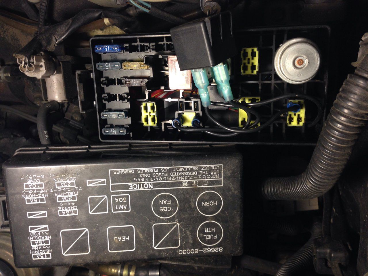

Hey guys,
My drl's have been bugging up and I want to go back to stock.
I took a pic of the relay in the fuse box, which was installed by a shop (no I'm not taking it back to get fixed, I just want stock back) And have no idea how the fuel htr works in conjunction with the headlight relay. How was this wired originally?
Sorry for the image being upside down lol
They are likely using the fuel heater relay location for the ignition hot to trigger the DRL's. You should be able to simply remove the DRL relay and it will function as normal, once that's confirmed you can trace back and remove the DRL wiring if you desire.
Removed everything and it didn't work... sat on it for a little bit and realized that I need a Toyota headlight relay in there! Ha..
thanks for the advice though :)
