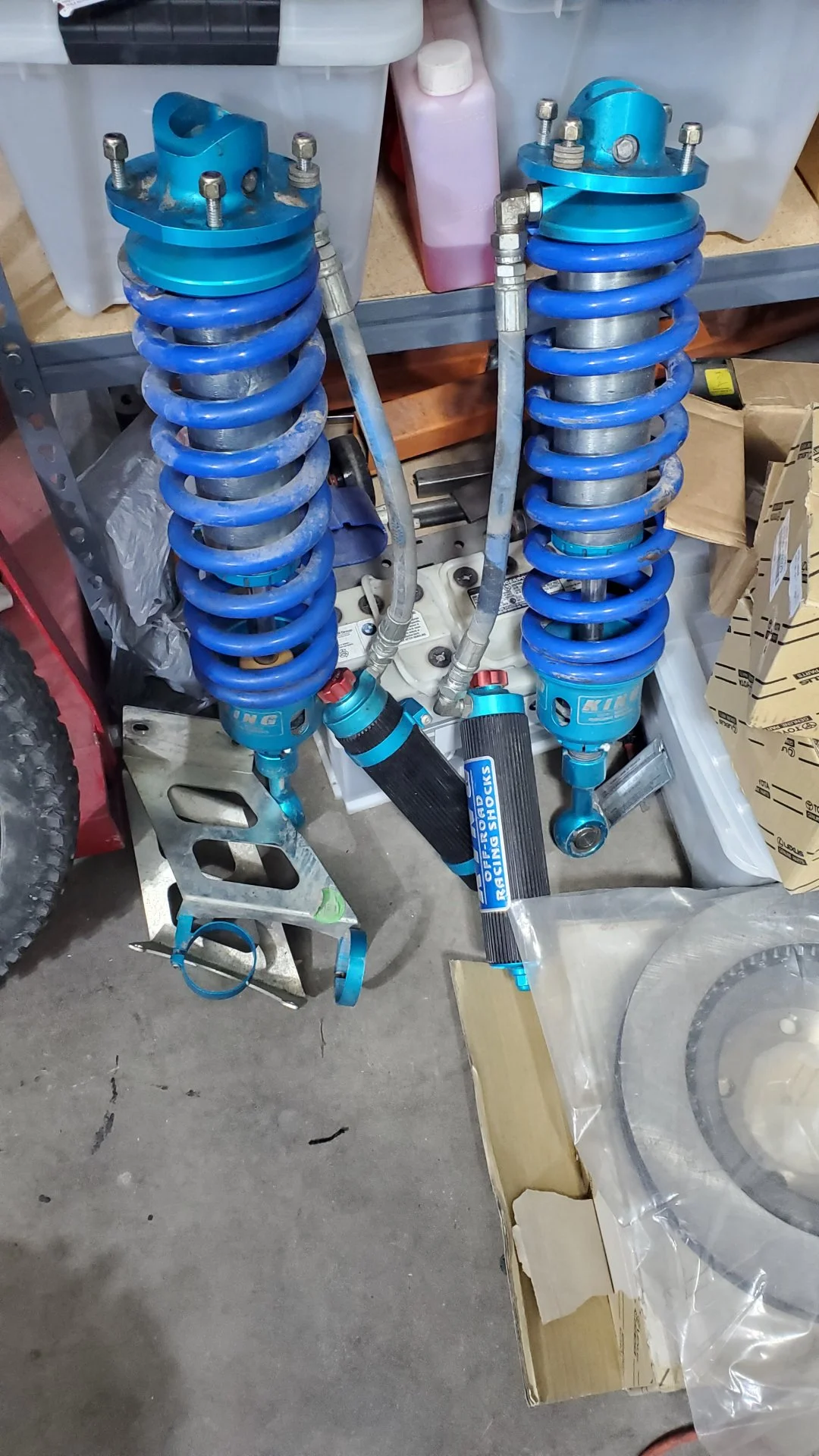

For someone converting over to a Tundra front end, I have a used set of King 3.0 shocks for the Tundra that I'll let go to a member for fairly cheap.
I think these will require LC specific reservoir brackets and an aftermarket Tundra upper control arm.

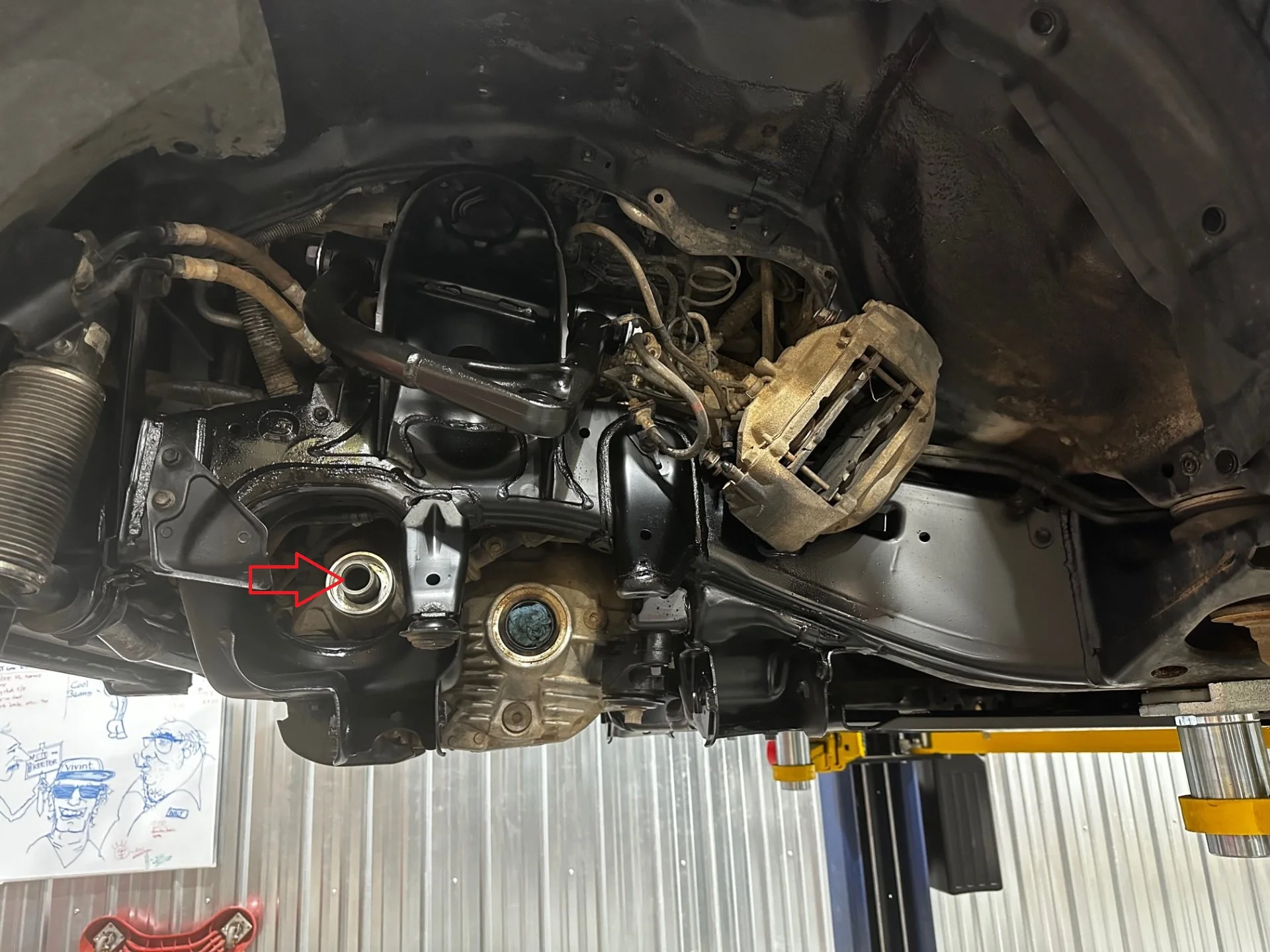

Has anyone considered the use of a steering rack limiter to keep the tire/rim from rubbing on the KDSS arm? I'm open to sacrificing a bit of turn radius as a layer of protection if/when others drive the 200.

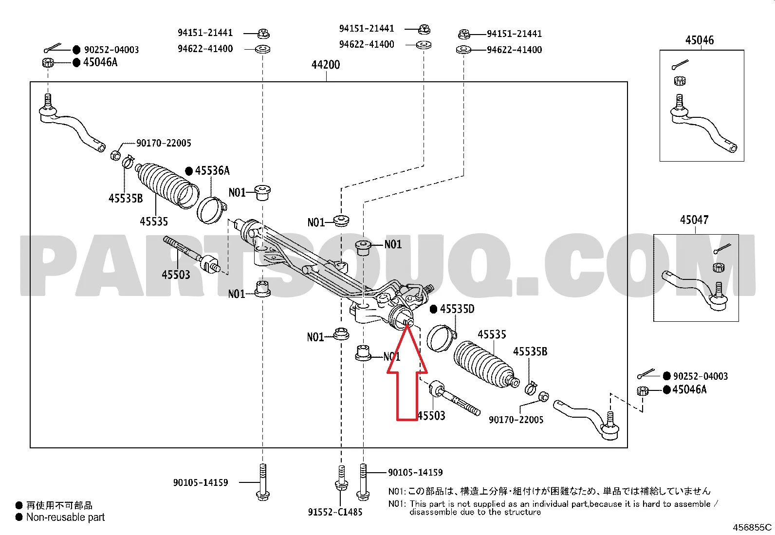

Does anyone know the outside diameter of the steering rack (just inside of the inner tierod) or have the rack opened up to measure it? It'd be nice if someone already had the measurement or has their suspension/rack apart to install the tundra/200 hybrid inner tierod ends.
Picture stolen from Cowzilla's thread and partsoup.

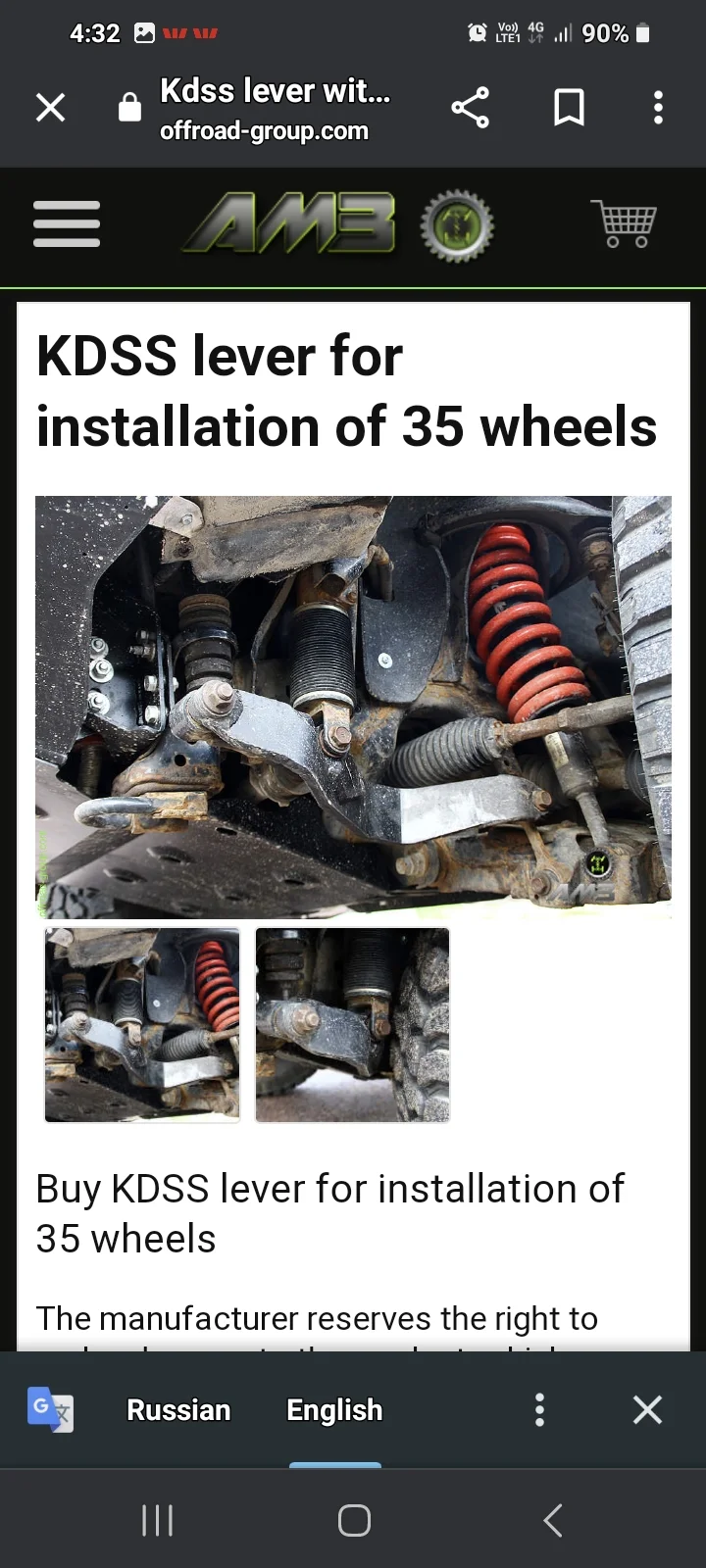

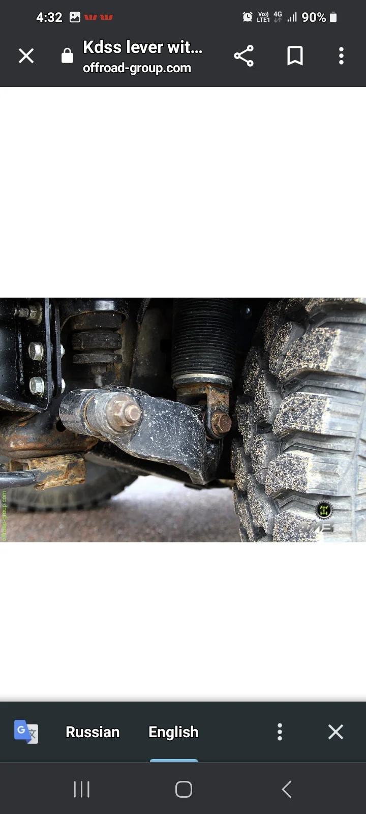

I use a totally different method for the KDSS arm. The plates that lower and move the whole arm forward cause way more issues than they solve and cause binding. I keep the center hole where it is and remove 23mm from the front of the arm and add it to the rear, effectively moving the bends 23mm forward. Can fit a 35" tyre with ZERO scrub.
Pictures? I’m having trouble understanding this.. which center hole? Which arm? (KDSS or LCA?)
I reached out to @VooDoo2 via pm and this is what he said:
"Yes we made a jig so the arm geometry remains in place then remove 23mm from one end and weld it into the other (cut and weld) to move the section that rubs forward."
I ran out of time trying to deteremine if the KDSS arms on a RHD and LHD vehicle are the same. Partsoup wasn't allowing me to look up other markets... looks like I need VPN.
If the PNs are the same, his jig could potentially work for LHD markets. From what little research I found the KDSS arms are $400-500 and aren't available new. This said, all my research was done before a work trip over a week ago and wasn't very in depth. I'd love for some one to prove me wrong and start modding them here in the states with a core exchange to limit down time.

Following that same method looks like you could create an arm that would accommodate 37's too, although the angle of the KDSS piston would have to come forward a little too 🤔
I don’t understand how someone on mud hasn’t just cast a replacement bar for this, but for <$200 this would be worth trying.
For 37s you could always combine this with the KDSS relo to gain another inch
Seems like some 1/4" stock, some heat and some leverage could get you close......may have to try
You'll need to do much thicker than 1/4" to handle the forces on the system. Note that the factory bar is approximately 1.25" thick in most places.
