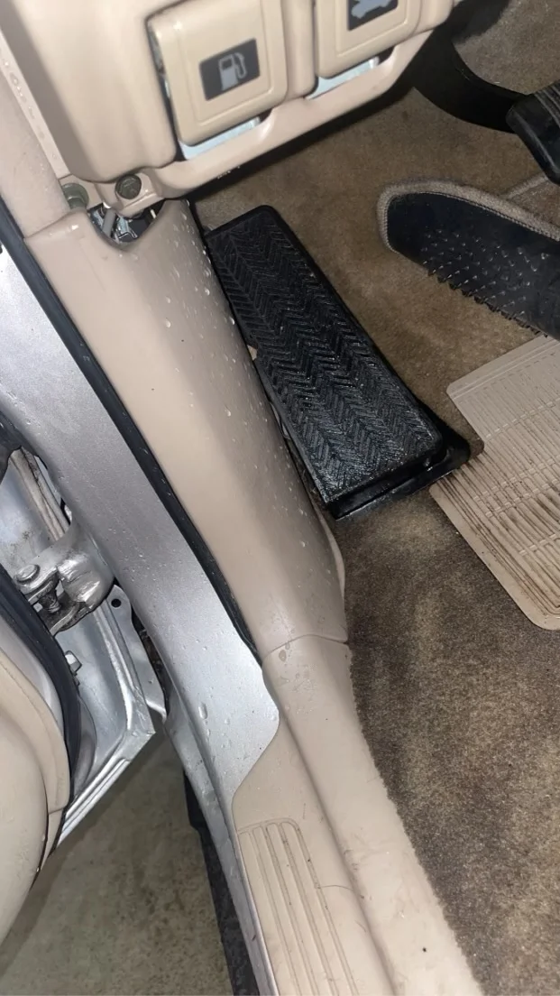

Hello all,
This is my first post on IH8MUD and also my very first Land Cruiser. For some background info, it is a 1999 with 294,000 miles. Relatively low rust but by no means perfect. I’ve owned it for about 2 weeks now and love it, but this is the first major rain it has seen and boy… does it leak. The leak appears to be coming from the top left of the A pillar trim. I’ve read a lot of posts about this but relatively no definitive answers to my specific issue. I’ve seen a lot about the Cowl and windshield being the issue especially on aftermarket windshields. Mine is a replacement windshield from God knows how long ago. If anyone has any clues feel free to let me know, my current suspicion is the windshield.

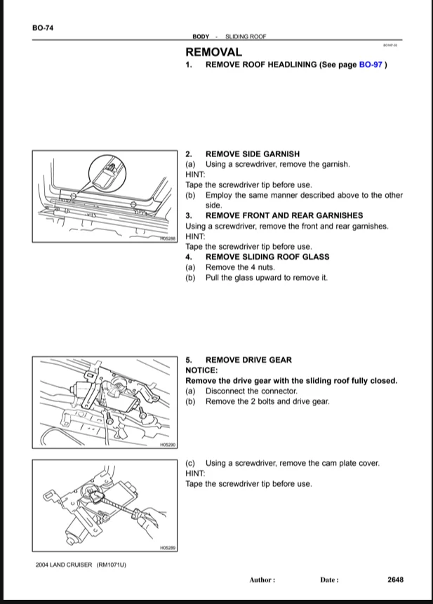

If the sunroof is permanently sealed shut, make sure that it has been sealed all the way from the glass to the body. If not permanently sealed, you can remove the glass by popping off the interior trim and removing the nuts that attach the glass to the track brackets and then removing the entire piece of glass.

Could you elaborate on this more. I looked at a post on someone repairing their broken sun roof and it seemed like the whole headliner has to come out. Is there a way to remove the glass just to clean the rails and drain gutters? I’ll take some more photos of the water marks I’m seeing. Also for whoever mentioned it, the sunroof was mentioned to not work in the comments.

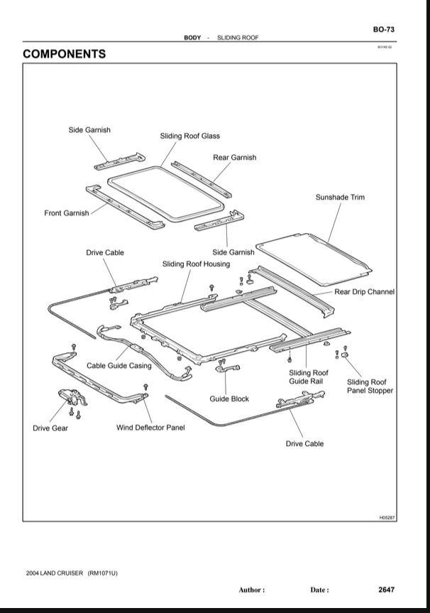

If it’s not siliconed in, it is easy to pop out the sunroof to check the drains. Slide open the cover, carefully remove the black plastic trim from the perimeter which are covering the four gold nuts. Push the glass up and lift out. Check all four drains but pouring some water in the channel. Personally I’d do that sooner than later.
Sorry for such a late update. I’ve done nothing to the vehicle until now so didn’t feel a need to update on no update lol. I had some time today to remove the sunroof Glass like TahoeZ stated. It was super easy and I did see my drains were clogged. I was able to clean them out and get them running water again. In Kentucky about 2 weeks ago there was a massive rain storm and the car collected a good 20 or so gallons of water. I had to rush it to a buddies apartment just to keep it from flooding. It was misfiring like crazy the whole way over. Turns out 2 of the coils were original to the vehicle from 1999. Super impressive for 296,000 miles and 26 years… Got those replaced and no more issues. But that night before the storm I had removed the A pillar Trim to try to prevent water from getting down to the fuses and stuff. I saw the water coming from the windshield ugh… The sunroof was leaking in the super heavy rain too but now that the drains are cleaned thanks to y’all’s tips I’m sure that’ll stop. Toyota unfortunately won’t be able to get a windshield in for over a month so I don’t think I’ll have any more updates until then… thanks for everyone’s help that sunroof glass pop out was super appreciated. I was worried I would have to remove the entire assembly just to fix that.
