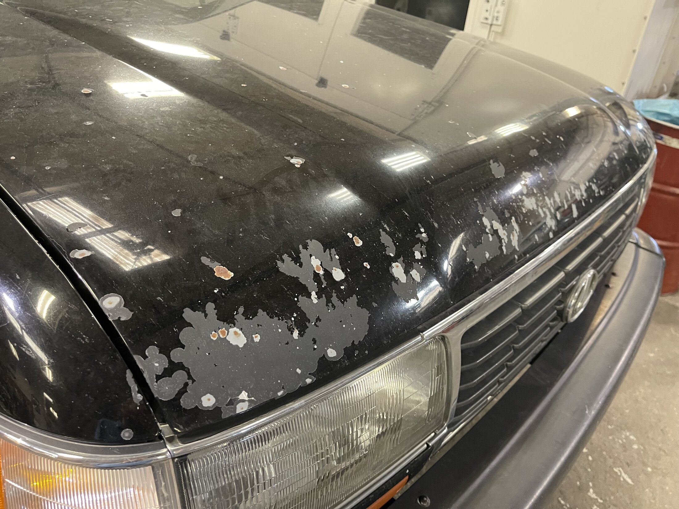

All apart. Sanding many of the parts to bare metal and fixed a couple of dents.
Zero rust so that was good. No telling how many Lx died from mud and rust trapped behind the moldings
