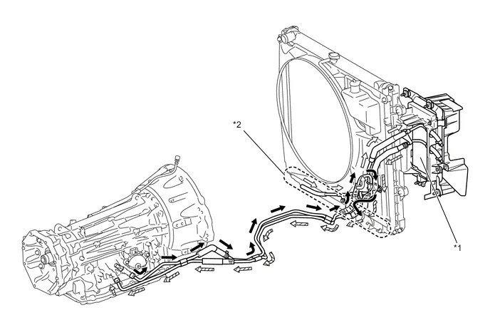

I think an under appreciated 100 and 200 design element is that the trans isn’t just cooled it’s controlled. By flowing through the bottom tank,
trans temperature is managed both up and down, warming it up quickly and preventing it from cooling too much in extreme cold.
This is the level of engineering that goes into the top shelf vehicle.

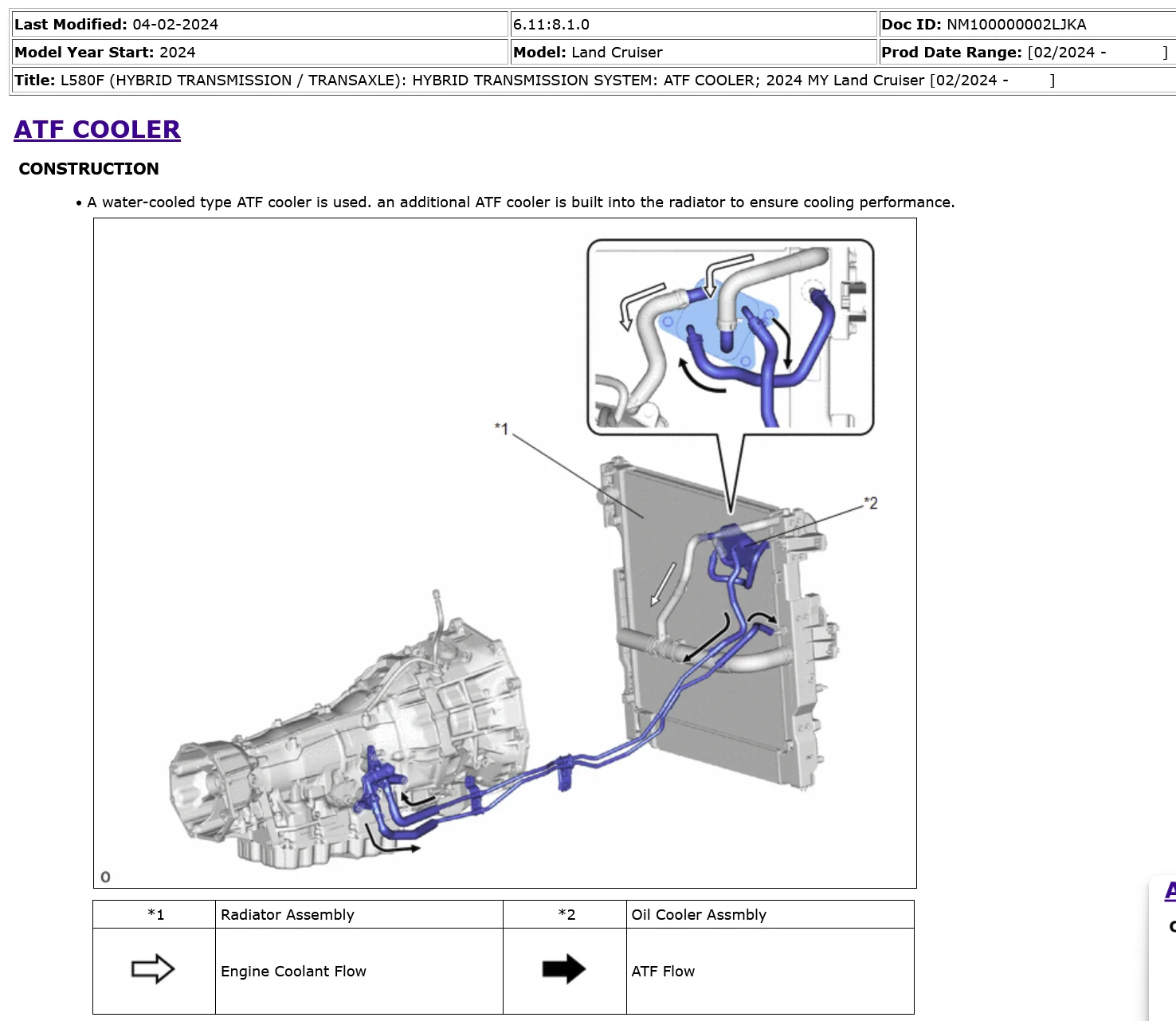

This is pretty universal on all automatic tranmissions. The LC250 uses both a dedicated part of the radiator and a liquid to liquid cooler.

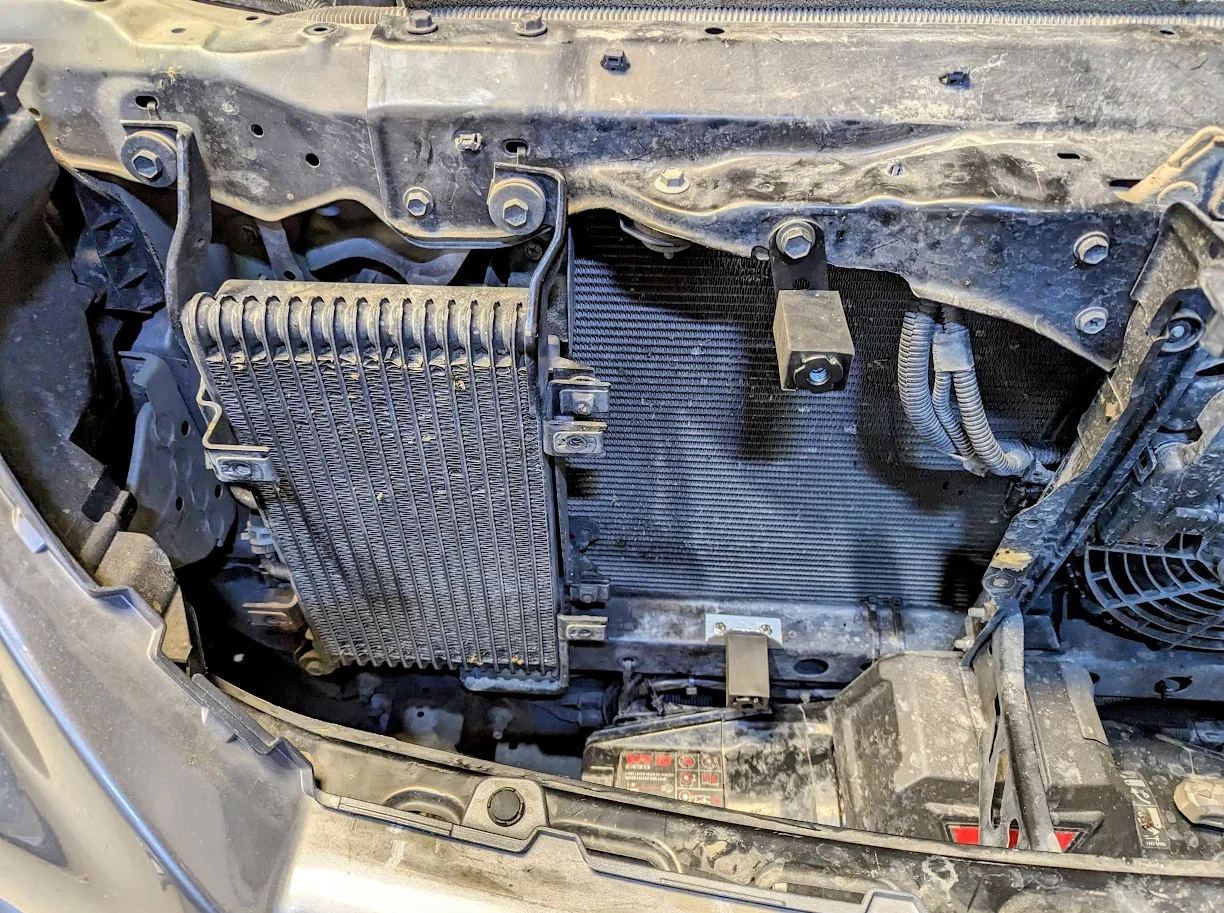

No, that’s just a heat exchanger using the engine coolant to warm and “somewhat” cool the transmission fluid, but it’s cooling capabilities are very limited since the actual transmission fluid is not flowing through a radiator.
What I’m talking about is the 200 has a dedicated transmission cooler and a heat exchanger where it can thoroughly keep the transmission at safe temps under extreme load situations by running hot transmission fluid through radiator fins to keep the transmission fluid cool.
Does the 250 have a dedicated trans cooler or is it using coolant for heat rejection? I'd be interested to see a report from an OBDII monitor to see how quickly the trans temp comes up. On the Ram 2500 it has no such 'standard' coolant integration and in the winter takes 45-60 minutes of highway driving for the trans to come up to full operating temp.
^ This is my understanding of the 100/200 design as well.
