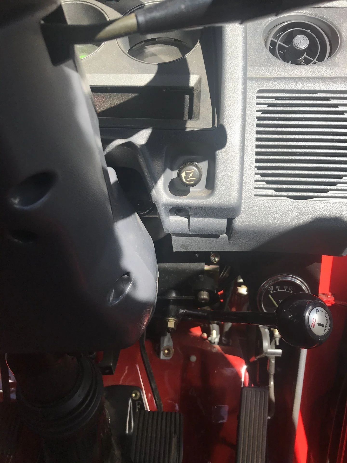

Don’t know what this dial is in my 94 Dyna fire truck

I am trying to take off the dash board of my 94 Dyna fire truck to put a new outlet into the electrical system. Anyone know what this dial is? Looking at a Dyna manual it could be a rheostat? What ever it is, how would I go about safely disconnecting it?
Looks like the hand throttle, used to bring idle RPM up for winching and other electrical high-load things. You use the gas pedal to bring the RPM up to where you want them, then pull and twist the knob(I think, it's been a while since I've used it) to lock it at that RPM.
Does the water pump for the fire fighting unit run off the gearbox? The hand throttle (I think the official name is "accelerator") is often used to increase engine speed to run items connected to the PTO. As you turn the dial , it pulls on the accelerator cable. It works best if you put your foot down a little as you turn it. I use them to bump up the RPMs for a few minutes on cold starts.

Haven’t ran the pump but I believe it does run off the gear box
You know if I should keep it twisted clockwise all the way in out counter clock wise all the way out during normal times?
You’ll want it all the way CCW, otherwise the throttle pedal will be partly depressed.

Twist CW to lock in your target RPM, twist CCW to release, assuming it's working properly.
