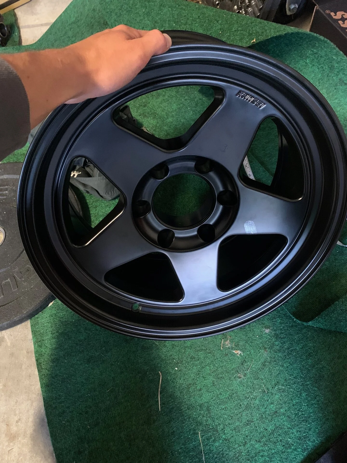

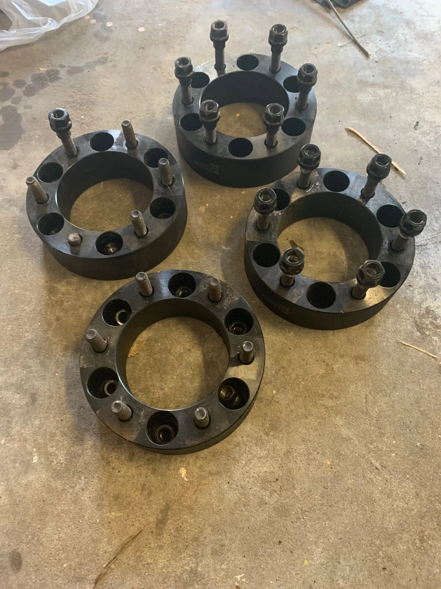

Just a PSA, was needing some new wheels for the land cruiser, as the PO had a set of sketchy 2" spacers (with a snapped stud!) was looking at SCS wheels for a set of their 5 spokes. After hearing about lead times and seeing that Kansei had a sale on, I picked up a set of some pretty slick looking rims.

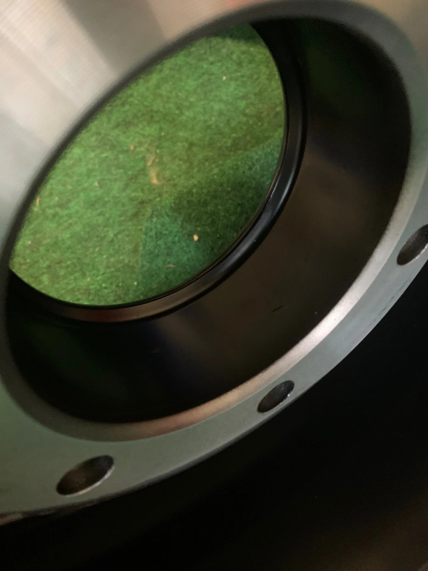

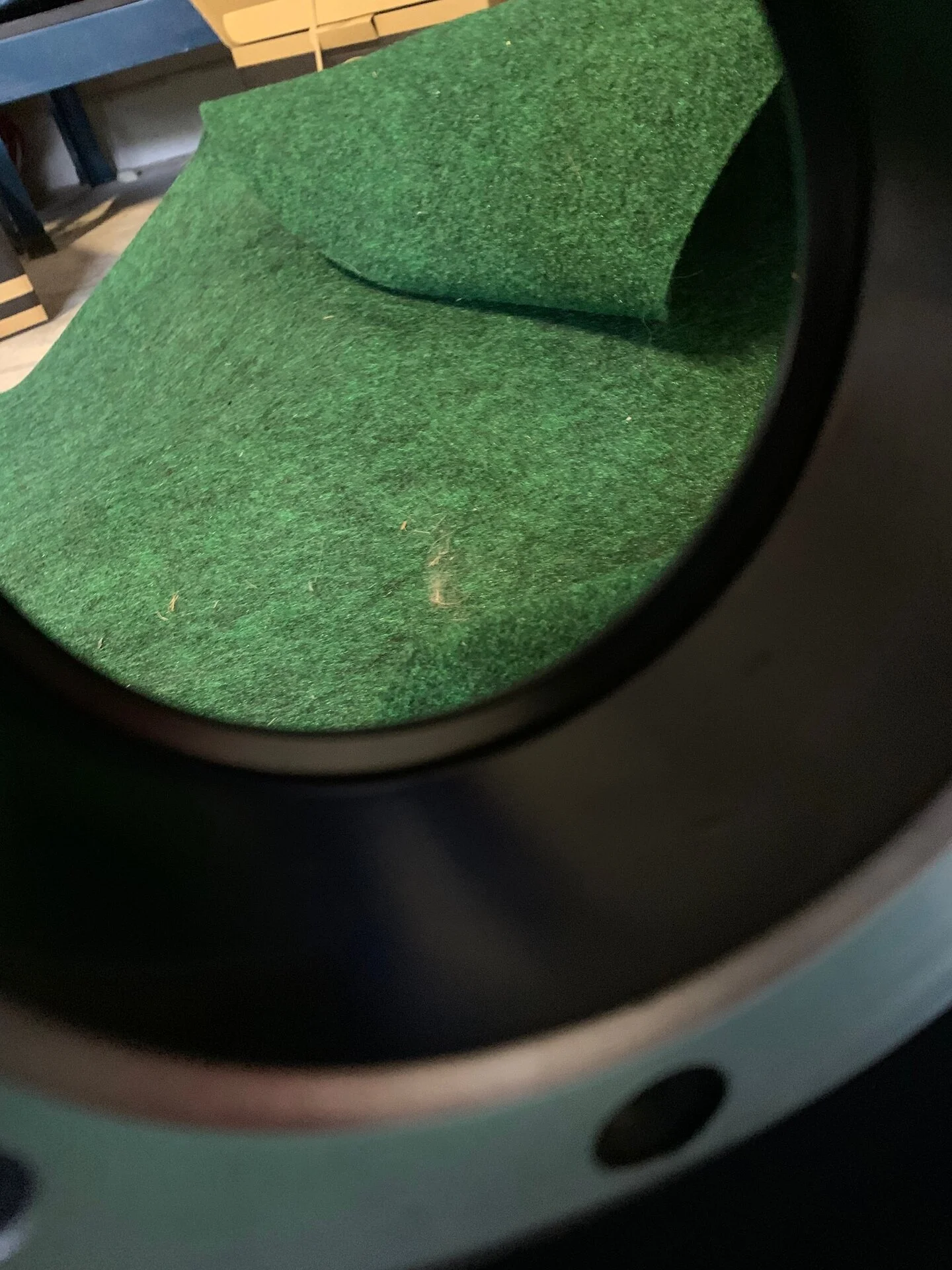

I measured, researched, yada yada what I thought was a sufficient amount before buying. right back space, right offset, 106mm bore, 8.5 width, right bolt pattern. seemed dreamy! Just got back from test fitting before heading to get my new 37s mounted, aaaaaaaaaaaand these wheels have a lip (that wasn't disclosed in the spec sheets or when I called them) that makes the bore more like a 100mm than a 106. they won't seat on the hub.
Shame love the wheels, might have to try and get the lip on the bore milled out? anyone done that?
