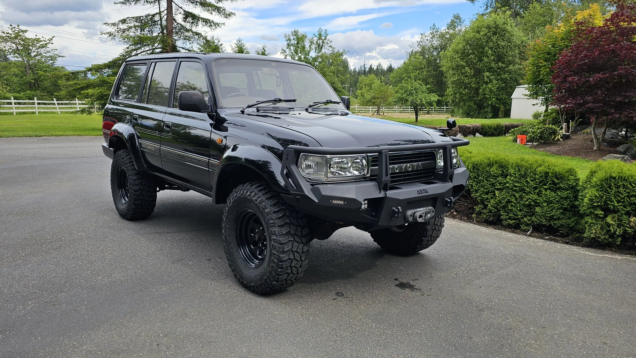

8" with 4.25 BS and -12 offset gets you flush on flared models. 285/75s btw.

as stated on an 8" rim a -12 puts it right at the edge of the fender. a 0 is just slightly tucked.

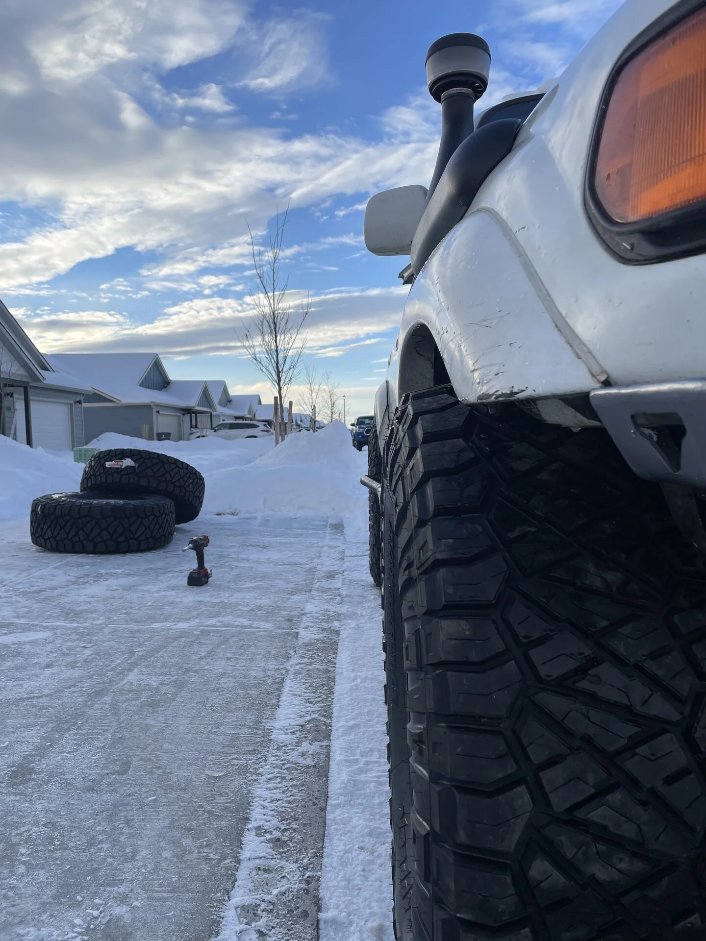

These are a 16*8 with a -12

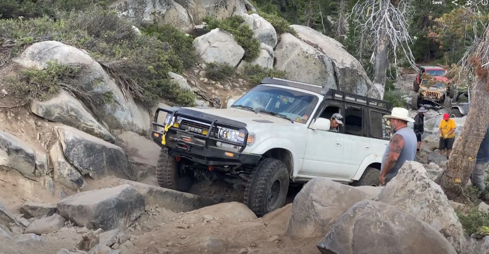

17x9 -12 offset tucks in with a 37x12.50.
