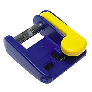

Get yourself one of these ratcheting tighteners per car seat and you will be able to get those whippersnapper seats nice and snug. I'm guessing that with the kids the 2nd row will be reserved for kids' seating for quite a while, and thus it's easier to strap those seats in and leave them there. You can also run a strap back to the D-rings behind the middle row seats. I bought my 80 when wifey was preggers with #1 10 years ago. When #2 came along 27 months later, #1 would pop the seatbelt loose on #2's seat just to be a sneaky monkey, so I ran straps back to the D-rings and kept them tight, and those seats were not going anywhere. I also added anchor points to the metal frame feet of the 2nd row seats in order to strap down the rear-facing seat base (it was the click and carry type of seat). It might take some creative thinking, but I'd feel safer with my kids, or anyone else's kids, in my 80 than in just about any other vehicle. Are your kids rear-facing, forward facing, or in boosters...what's the combo?
^^^DITTO^^^
x2 on this. I use this in combination with the rear latch belt and my 3rd row anchor points.
