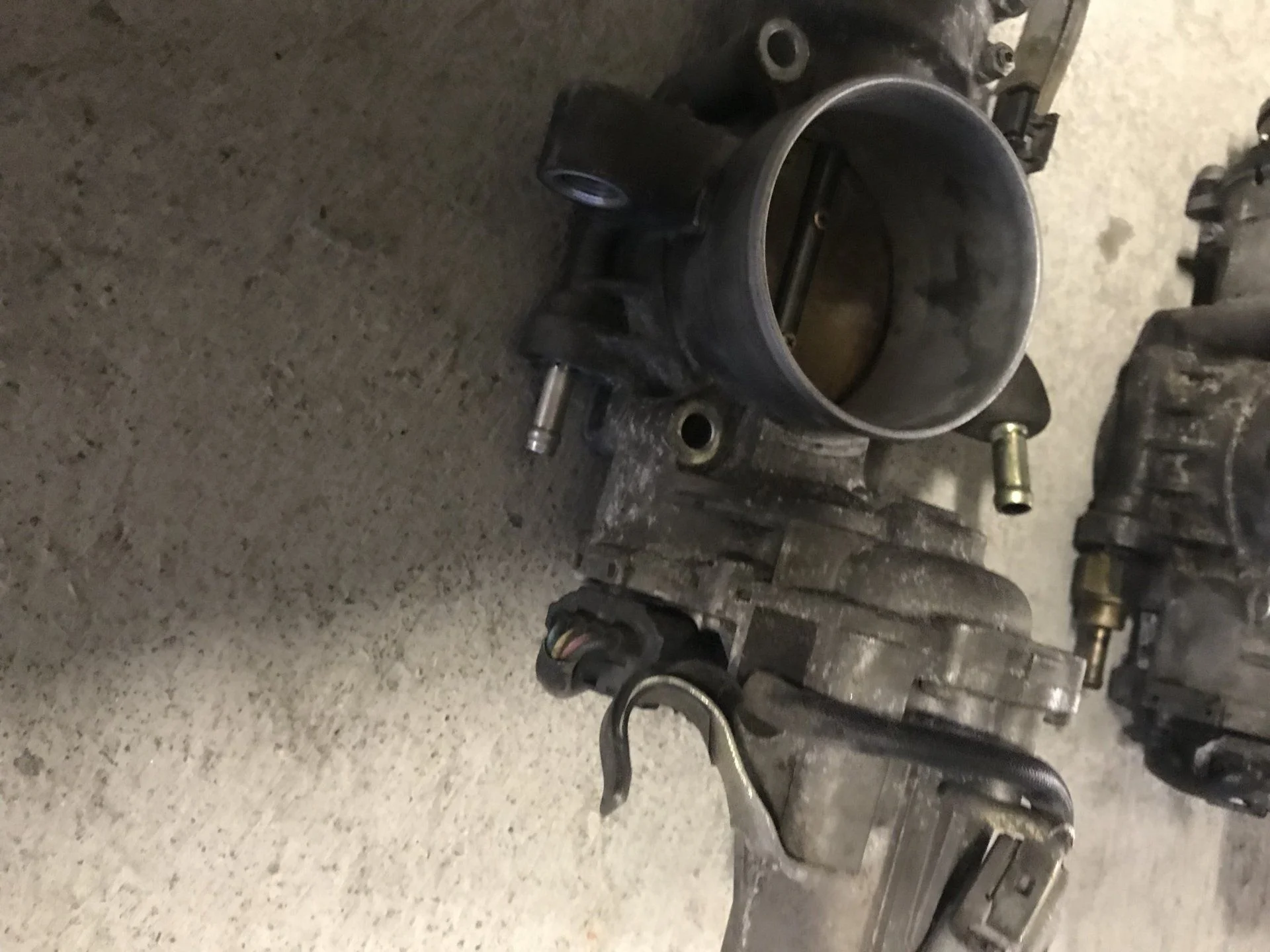

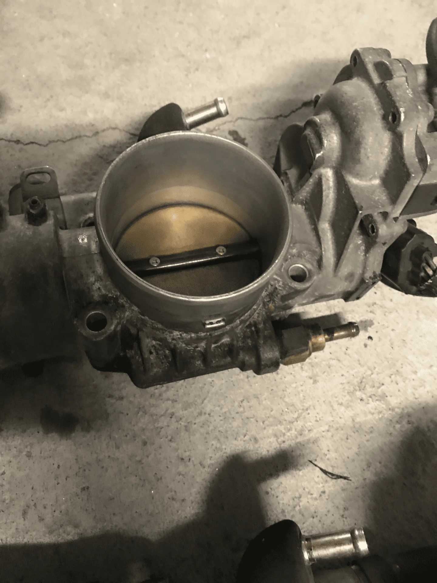

Hey All,

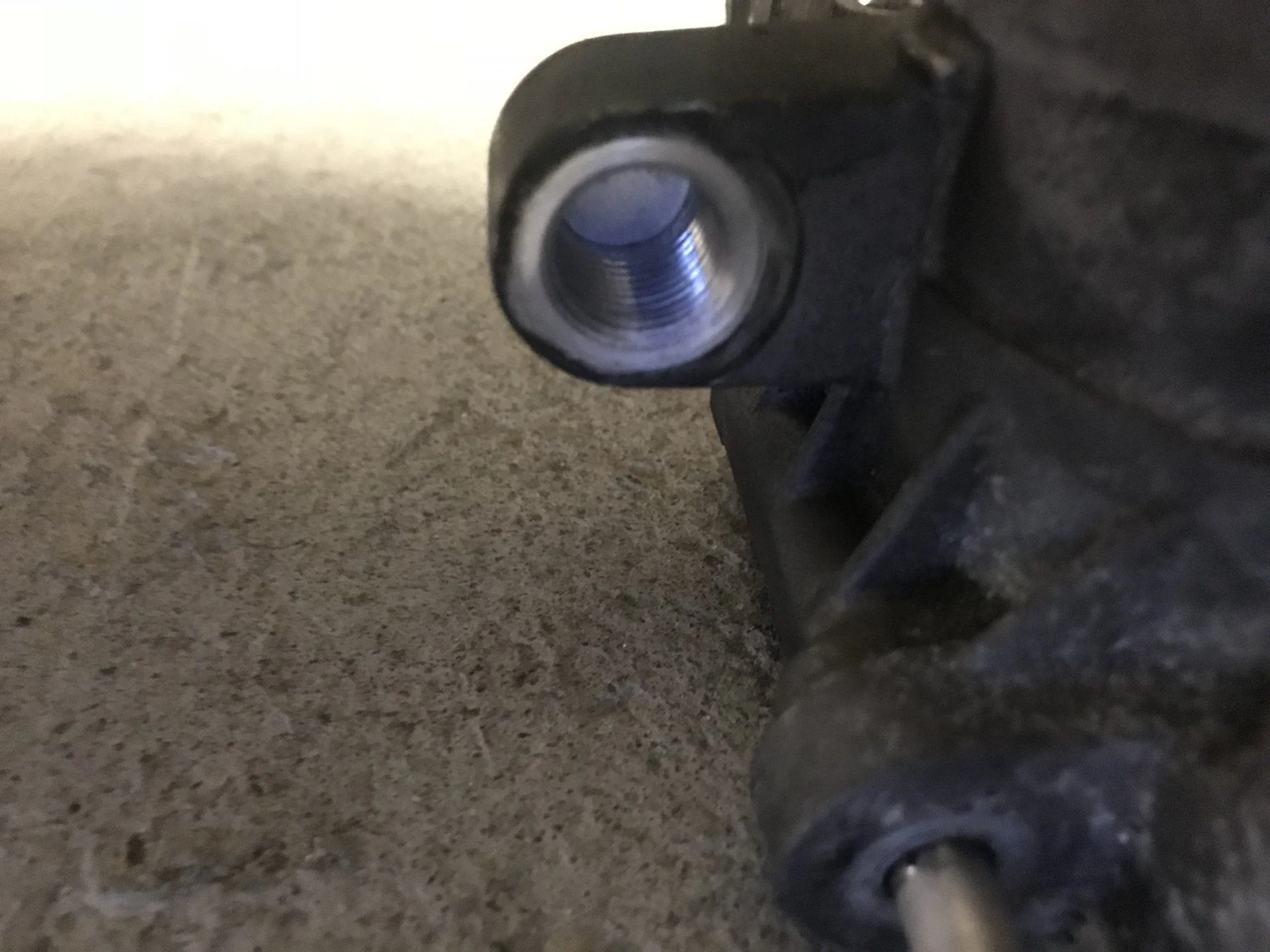

I recently got an entire throttle body from a junkyard that was from a 02' Sequoia. Everything looks the same as my 98 LX470 throttle body, except for this metal screw in pipe (as pictured) that is in addition to the regular body. Can you guys tell me if I can just go ahead and unscrew that, and be on my way? Do I have to do anything special or will it adversely impact performance of the throttle body/ engine?
For those wondering why I replaced the entire throttle body: I was experiencing engine speed hunting that was causing the revs to jump from 700 - 2000 rpm in an almost pulse like fashion consistently, so after a bit of narrowing down I believe it is throttle body. Ended up cheaper to get one off of a salvage title car than to attempt and fork over cash to the stealership.
Looking forward to your guidance and comments, thanks in advance!
If you can hook up all your vacuum hoses without it, loose it but plug if off.

If it was me, I'd set-up the older you're going to use, to same configuration as your taking off. If no screw on tee water pipe on yours, then take off and put yours on. Your water hose configuration should then work without altering.

Yes I am going to do just that and see how it works out; I don't think it should be too much of an issue, it seems as though it wouldn't be too bad if I remove the pipe. I'll keep everyone updated. This is going on after work today.
I'll unscrew the pipe and hope for the best! Going on this evening so I will take photos and update everyone.

I'd use some FIPG sealer on water pipe connector threads. The correct 1282B FIPG is pricy so just see if hold with any seal rated for coolant. It will be easy fix in future if need be.
1282B is coolant rated FIPG. 102 is oil rated FIPG. (Form In Place Gasket)

Just a quick update- I ended up installing the throttle body with no issues; everything is running as good as new! Thank you all for the input. I ended up just unscrewing the extra piece and calling it a day. This is a swap that is definitely a great alternative if you are considering the costs at the dealer.
