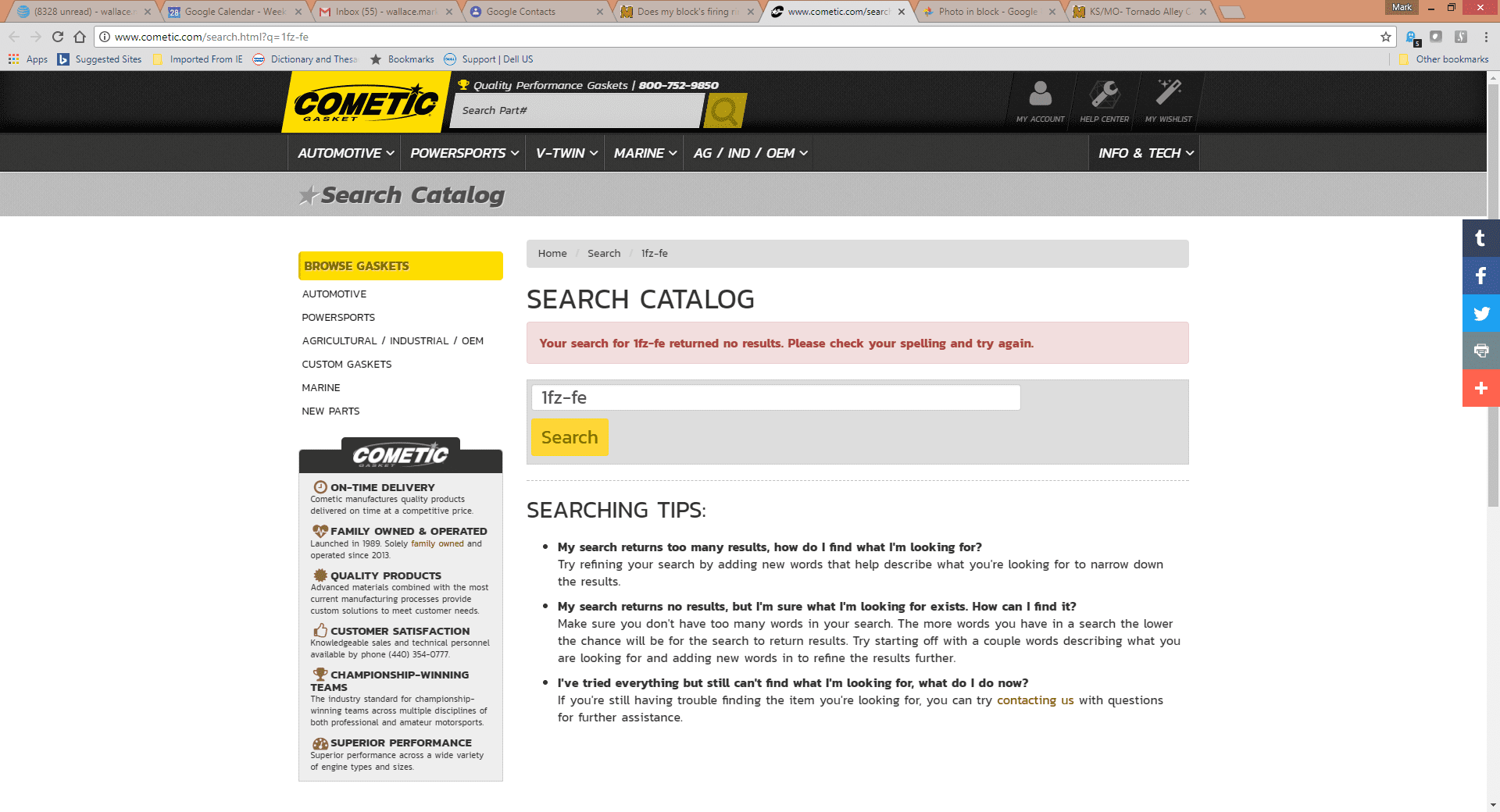

Cometic Gasket
Exactly. No results. Did I miss something?
OK so I already have the toyota HG came in my valve grind kit how are these different? And I have a 93 the specific application on cometic are for 95-98.
Well, the Cometic gaskets can come in varying thicknesses in order to offset the effect of decking the block and milling the head. This way, it will not affect the cam timing or the compression ratio.
But again, unless I have some blocker here at work that's causing this, I don't see anything for the 1FZ-FE engine on the Cometic site.
They have them.
