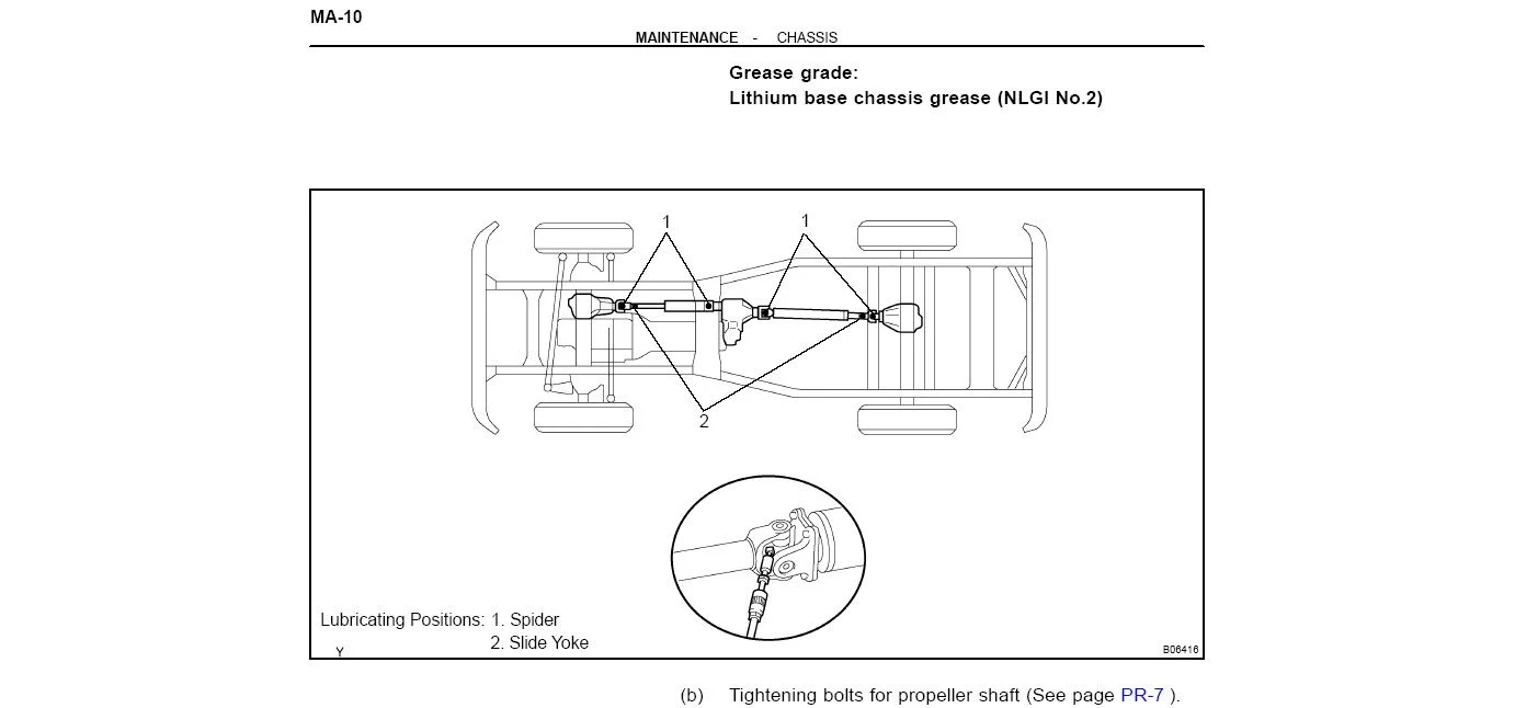

I've not looked at this procedure "Stop when extends" in 200 series FSM. The 100 series FSM uses the standard statement which is how any typical lube job is done. "Add until old grease flows out", just like we do on spiders and the old serviceable ball joint, UCA, LCA and steering idlers, etc..
This is old recommendation for 100 series. Toyota changed recommendation to: Pump in grease until first sign of extension of slide yoke.
