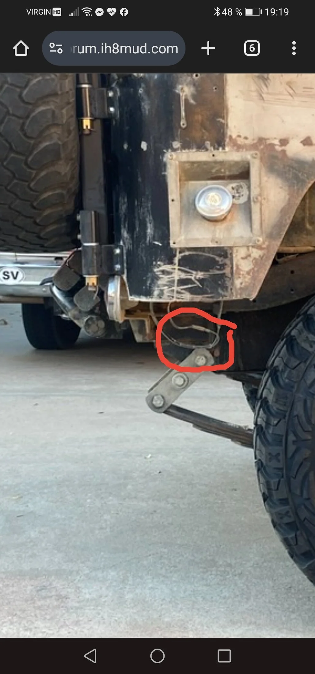

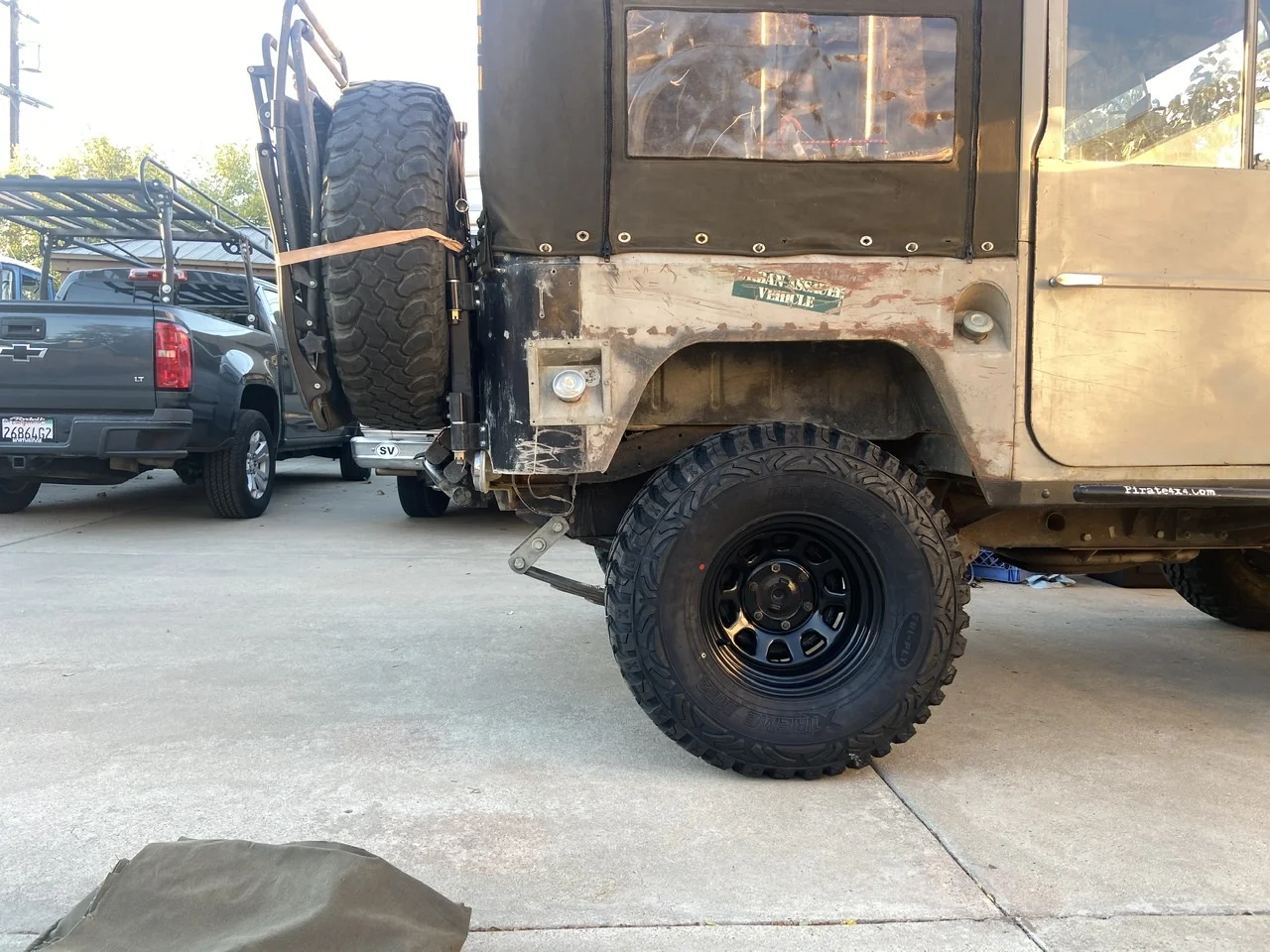

65swb45 (Mark) posted this pic of the ironman springs installed...they look to have the best shackle angle and axle position of any of the springs on the market.
Double check but I'm pretty sure Mark relocated one of the spring hangers.
Perfect shackle angle, and with long shackles, too! My guess is that the spring hanger was probably relocated. Would love to see the front angle also.
I was wondering, it definitely looked too good to be true. The post I saw it on made it sound like they were in the stock location, but I tried to contact Mark to verify, but for some reason I can't send him a message. Does anyone know how to tag him into this conversation to see if he can verify OE spring perch location or not?
