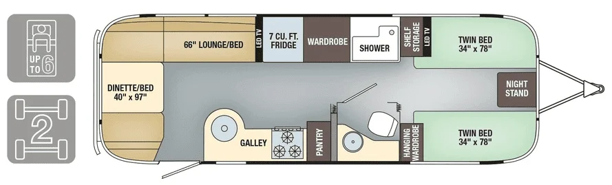

In regards to bunks, yes I'd like that too and perhaps will modify mine to add a bunk over one of the twin beds. And make the other side a small desk and day bed/lounge. The kids sleep like kings/queens and get the bedroom. My wife and I sleep on the 66" pullout sofa that turns into a pretty descent full size bed. We don't full time, so it's plenty of storage and space for our trips.

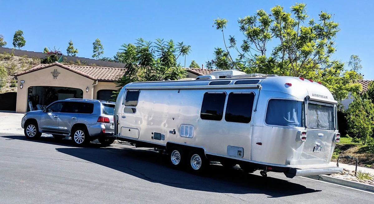

Are you towing your 27ft Airstream with the LX570? Wife and I are considering a 25ft Flying Cloud.
Yes. I'm actually headed out to the mountains tomorrow. She's handles it with aplomb. I seriously wouldn't tow with anything else: no pickup, no 3/4 ton, no slade or expedition. Biggest asset by far is its incredible maneuverability. I can get her in places long wheelbase pickups can't even comprehend. Range is a bit limited with the stock tank, but there's aftermarket solutions now.
Awesome. Thanks for the reply. Very encouraging considering all the talk on the Airstream forums that you "must" have a truck to tow anything over 23ft!
