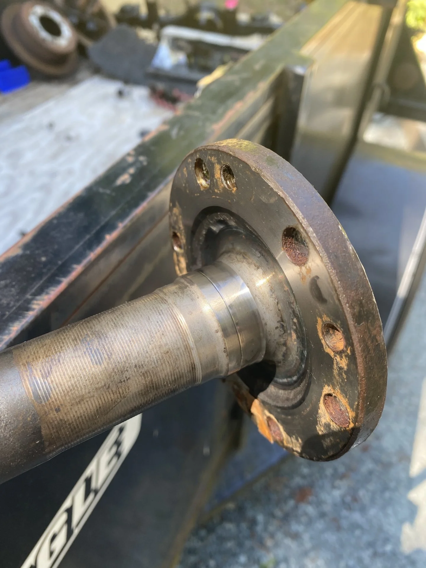

Hi all, I have a 62, but putting an 80 locker rear axle out of a 94 in my truck. I bought a locked rear rear axle at the local salvage yard and am pulling apart to replace the seals, etc. They have some grooves in the axles from the seats, so I am considering putting speed-sleeves or decreasing the seal housing depth to move the seal inboard of the groove. Any other options? Has anyone used a Speed-sleeve? I found a part number, but wanted to make sure if works before I order it. Part number 99820 or 99139 is what I have seen here on mud.
Picture is worth a thousand words…
I thought you could buy 80 axle shafts. I would do that before what you propose.
Before either of those Id space the seal out by like 30-.040 and just ride it on a new spot. Ill take your old ones though if your are ditching them.
What's the spindle look like?
IDK how an axle/spindle seal could have even remotely caused that groove.

Thanks all for your input. The grooves are from the seals. It’s a common issue. The axles are not compromised, only issue is a potential leak. Certainly doesn’t warrant spending $500 to $800 . I didn’t see any evidence of leaks, but don’t really know. Speedi-sleeves are a common fix, but not sure if they work on the 80 axles. I am leaning towards moving the seal so that it doesn’t ride on the same groove.

That's why I don't see how they wore a groove in the axle. It must have been well placed and dry when they installed it.
I don't see why you cannot use a speedi-sleeve on the axle shaft, but it could weep gear oil under the sleeve, but it would be minimal.
