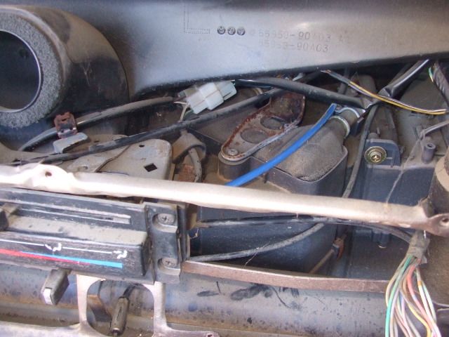

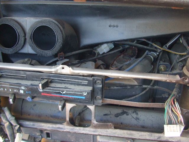

Here you are.
Hmm... I've only ever noticed the black one. What/where is the blue one?
I'll get some pics when the sun comes up. (I'm parting out an FJ62 and have the dash mostly apart)
Butt Ugly Chuck got the "U" shaped cable clips.
Yep. It's definitely the black one that I snapped. Is there a good way to get at the actaul open/close recirculate door to see why mine resists motion so much. I betcha a dollar you tell me I need to pull the glove box and dash.
