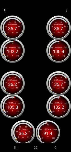

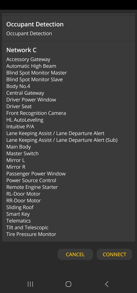

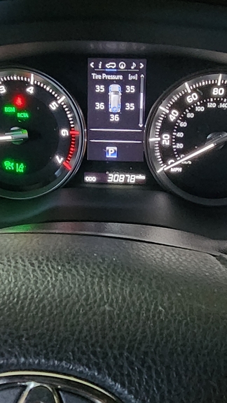

Here's what I did. It's a bit of a pain because on my app using OBDLink I have to connect to the alternate Network C interface which disconnects everything else. I don't use it much.
The PID's are:
  • ID <1,2,3,4,5> Tire Inflation Pressure psi
  • ID <1,2,3,4,5> Temperature in Tire F
My display:Displays match the dash:
Connection to Network C:
The PID's are:
View attachment 3723003View attachment 3723006

It's my inderstanding that the entries in the computer's array for each tire can be mapped to any tire with software (techstream?). So whereas my ID 1 for pressure and temperature was my front left, yours might not be.
So what I did was deflate the tires starting with the spare and then checked which one showed the lowered pressure.
