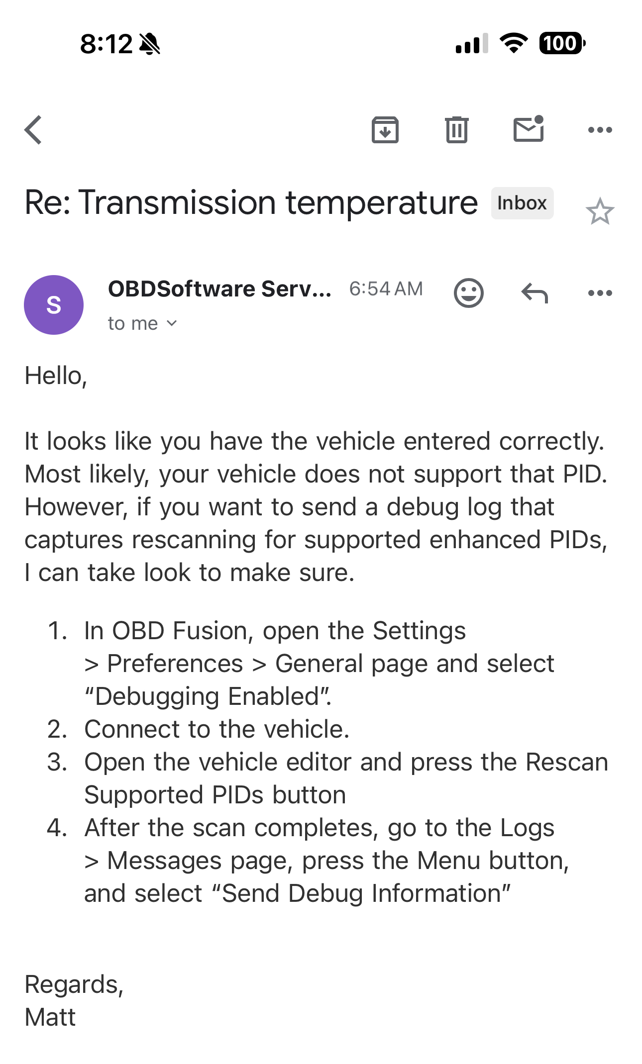

I tried to go back in an relink the PID but the AT temp doesn’t show up in my PID’s for some unknown reason.
Here is the email that I got back from OBD Fusion
It looks like you own the only Land Cruiser in Toyota's history which doesn't support the transmission temperature monitoring, or Matt is a real rookie.
I vote for option #2
Yea thats what I am thinking lol. I may just delete the app and try redownloading it and then scanning it again and hope the PID is there.
So I deleted and downloaded it again then rescanned it and I’m in the same boat. It’s not working.

I’ve tried but the transmission temperature PID’s don’t show up in my Engine and Electronic controlled transmission. 🤷🏼‍♂️

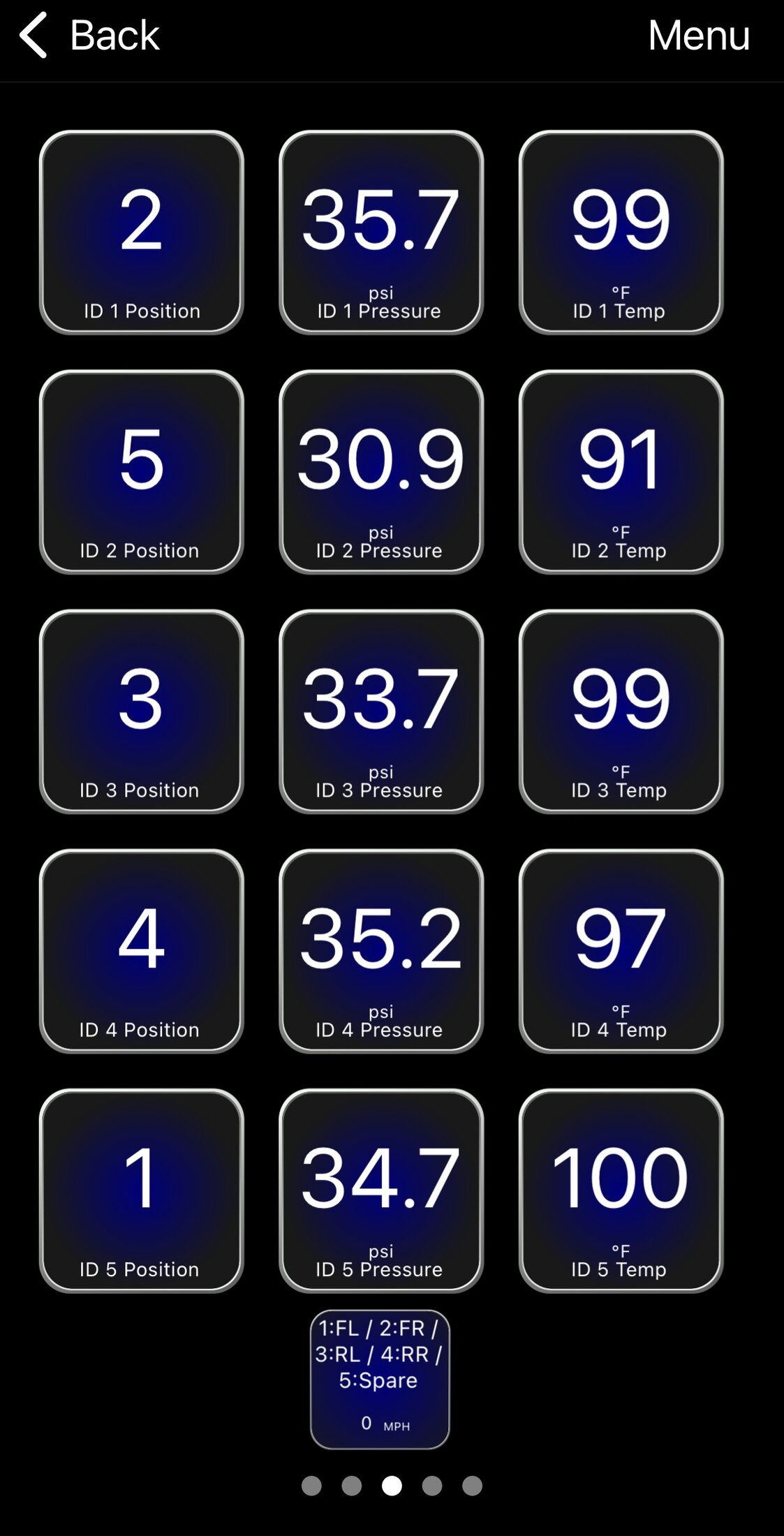

There’s been discussion on other threads about reading tire temps with an OBD tool. Tire temp for OBD Fusion is found in Toyota (paid) PID > Network C - Tire Pressure Monitor > ID x Temperature in Tire (in system setting units).
Where x = ID # (1-5), indicating which TPMS is which. The vehicle reads the TPMS based on where it is located (also 1-5), with the parameter “Status of the ID 3 Tire Position / No Information, FL,FR,RL, RR, Spare or Judging” listed in order from 1-5. (I don’t know what Judging is… but I believe Judging comes through as “0” until it figures out where the TPMS sender is located.)
Wish there was a way to make this look more like the dashboard readout showing the pressure by tire location, but this tool is too crude for that, so this works.

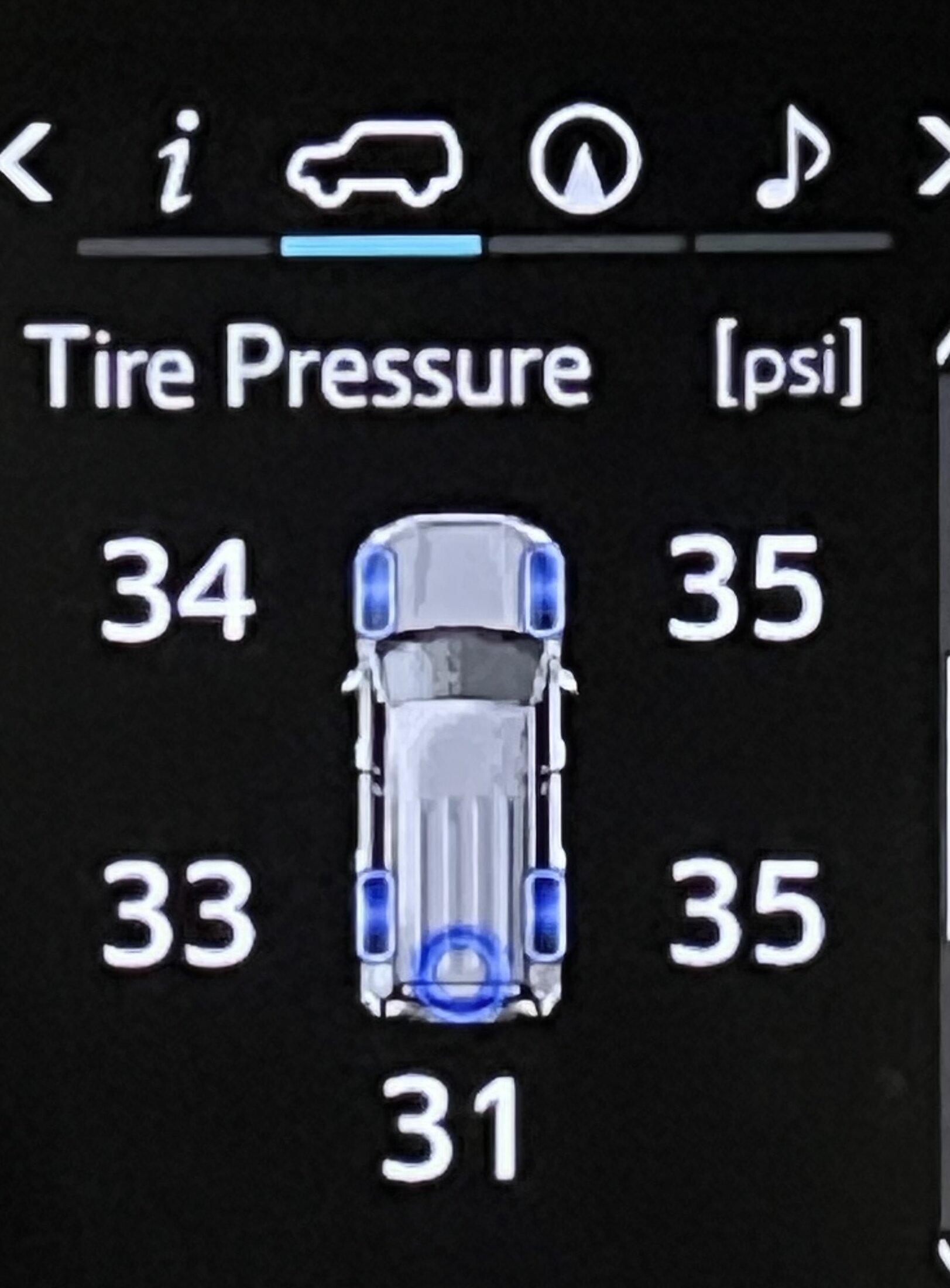

I made a simple dashboard of the Position, Pressure, and Temp. Here’s the result after driving around a bit to test it out. Also took a pic of the dashboard display in the LC. For example Position 2 is Front Right.
Note the TPMS does read tenths … but the rounding done by the car is not what you would expect. Above 9/10, it will round up.

I think you’re asking if you can see different networks at the same time… If so, yes, at least for OBD Fusion on iPhone, once it is “connected” I can see data from at least two Networks at once. Said another way, a dashboard can access and show data across different networks.

Once you tell fusion to connect it brings up the screen with different networks. I believe mine is always defaulted to the top one… “Network A” or whatever. Which one is the tire one?
I use one of our old iPhones as a dedicated fusion gauge so it doesn’t connect to the cruiser for anything else. I’ll mess with this today since we are back in civilization for a couple days before heading back east.
Edit: I just checked and now see that it connect to both “A” and “C”. Sweet… I’ll make a page for this today.

One more question about your positions…
Position 2 being front right… is that “ID 2 Position” or your position “2” in the blue box?
I’m just orienting mine to match what the car shows, front left will be in the front left corner, and so on. I don’t have room for labels so positioning is going to be how I sort mine..
Edit: scratch that, I went back and see you have a square with the details in it at the bottom. Facepalming myself now.

Right. It’s a bit confusing with two sets of 1-5 numbers. If you orient them where they are on the vehicle now, I think they’ll be in the “wrong” place after the next time you rotate the tires.
