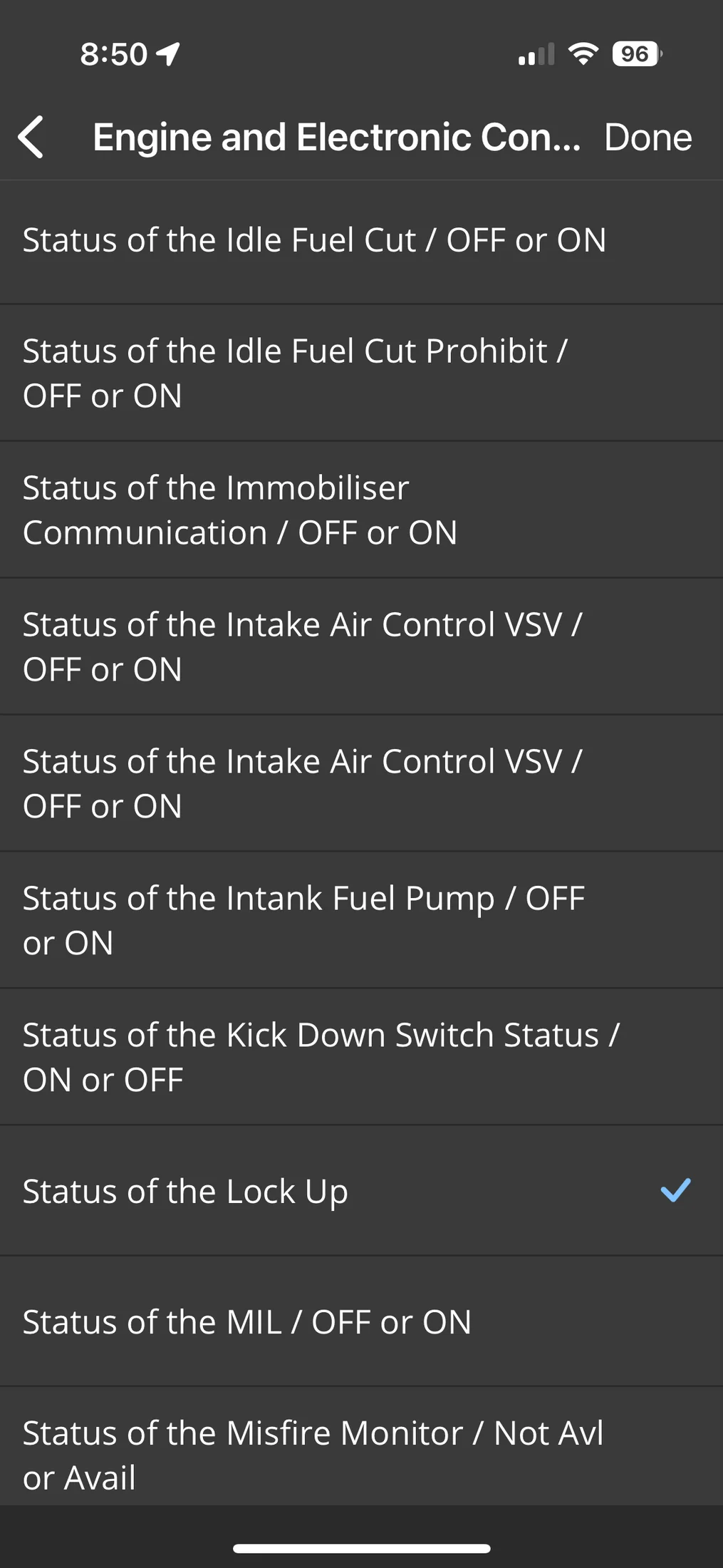

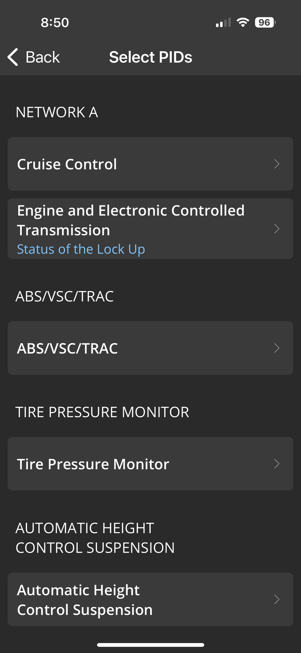

just realized when i imported the layouts, the PID for the torque converter lockup status didnt carry over. can someone point me to where/what PID youre using for this? thx!
For my 100 series it was in the PIDs as shown here: Toyota/Lexus/Scion -> engine and electronically control transmission -> status of lockup.

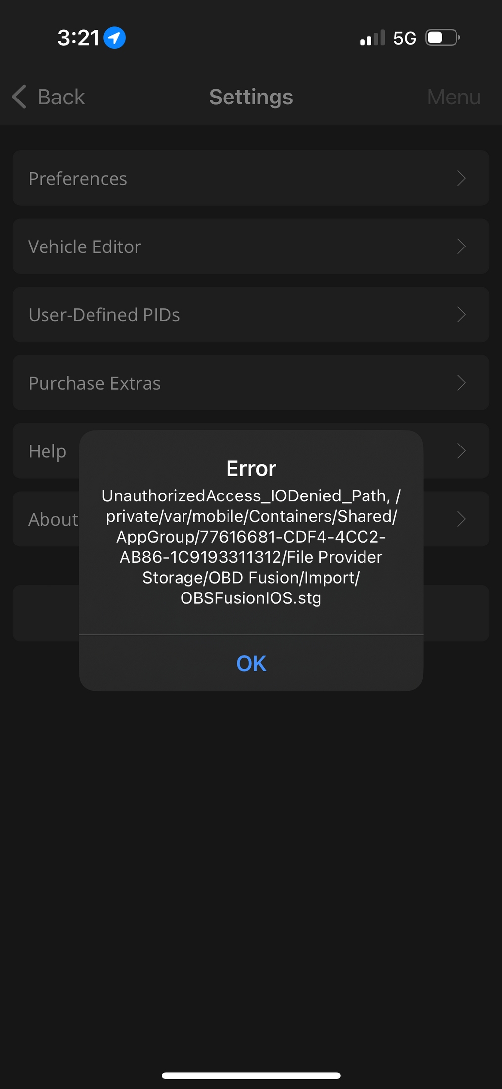

Here's a better photo of the error message:
Wondering if anyone else has cracked this barrier. I am getting the same error on my iOS.
I have the files downloaded to my phone and to Dropbox. It can see the files on my phone but not in Dropbox.
I get the same error and have read through all 15 pages. The only thing I haven’t tried is loading dashboard when connected to the OBDLink receiver.
