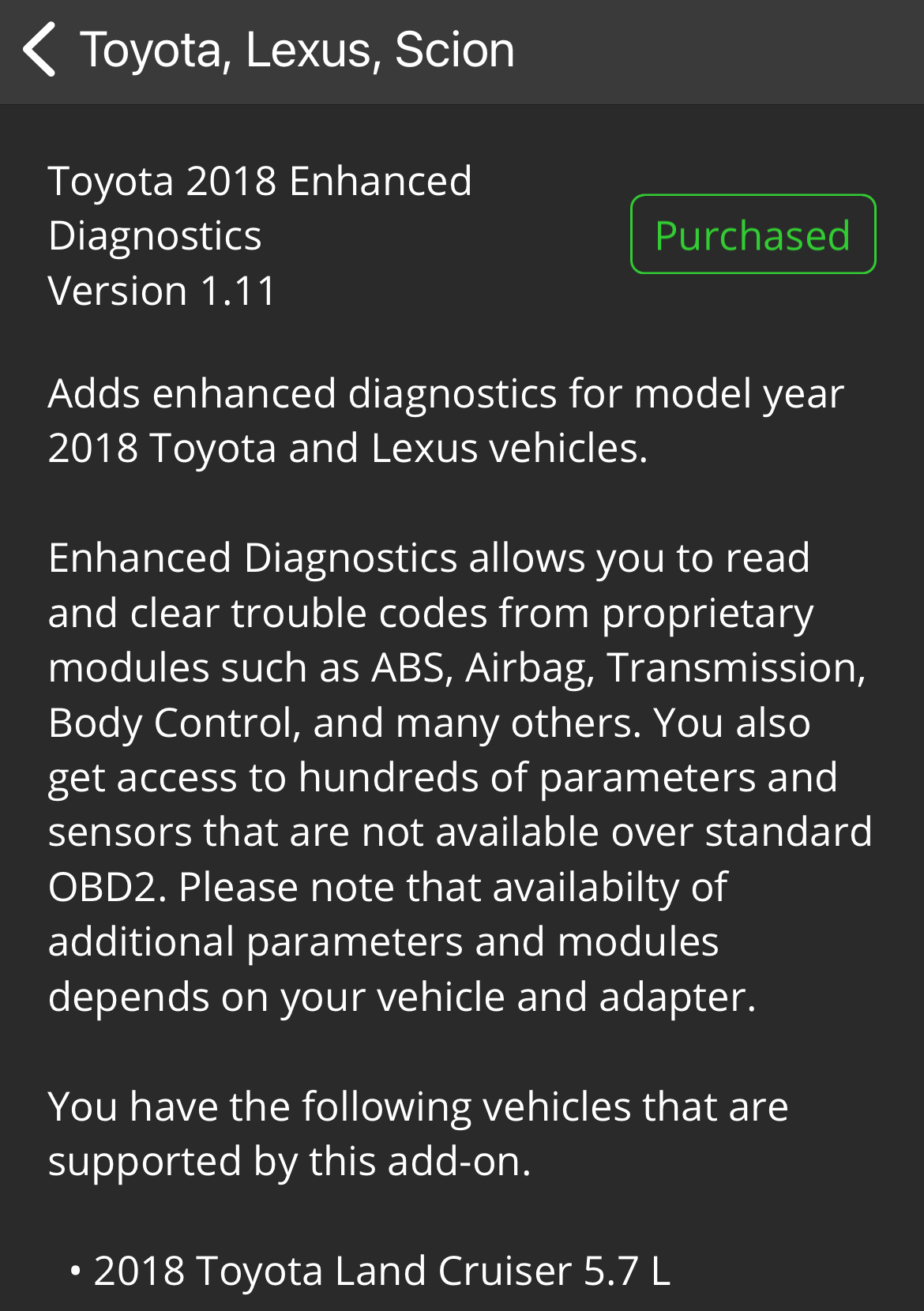

Thanks 2HundyJTex. I’ve tried all that up in post #55. I have not tried DropBox. I’ll probably try that. But what year of Toyota’s “enhanced diagnostics” have you purchased? I purchased “Toyota 2018 Enhanced Diagnostics” and “Toyota 1996-2021 Enhanced Diagnostics.” Could it be that you have to have the same year as the person sharing the dashboard?

I don’t think the dashboards are dependent on having the same year; I adapted mine from others with a different year.

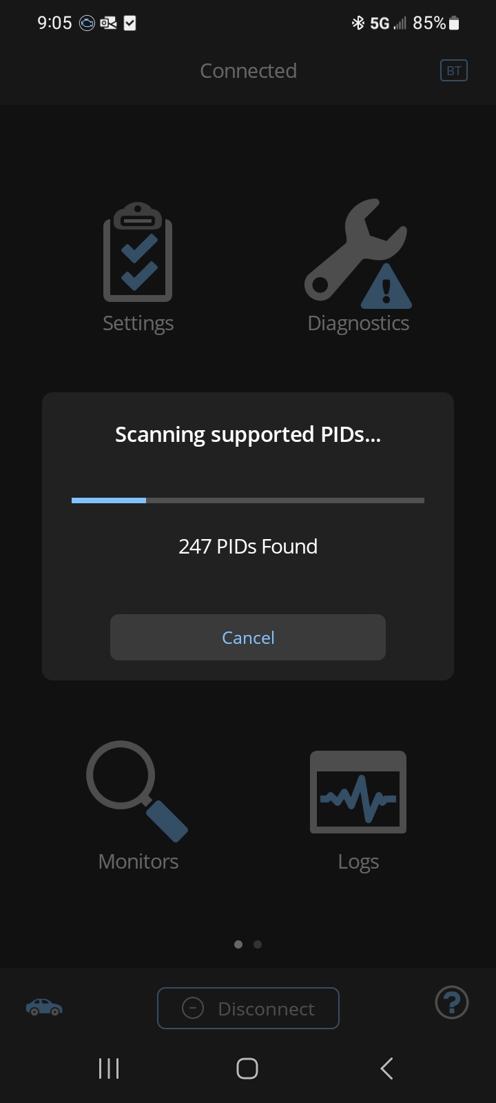

YES! WORKING! Data didnt start streaming until this process initiated (screen shot1). Must have been due to the default network setting being 'prompt.'

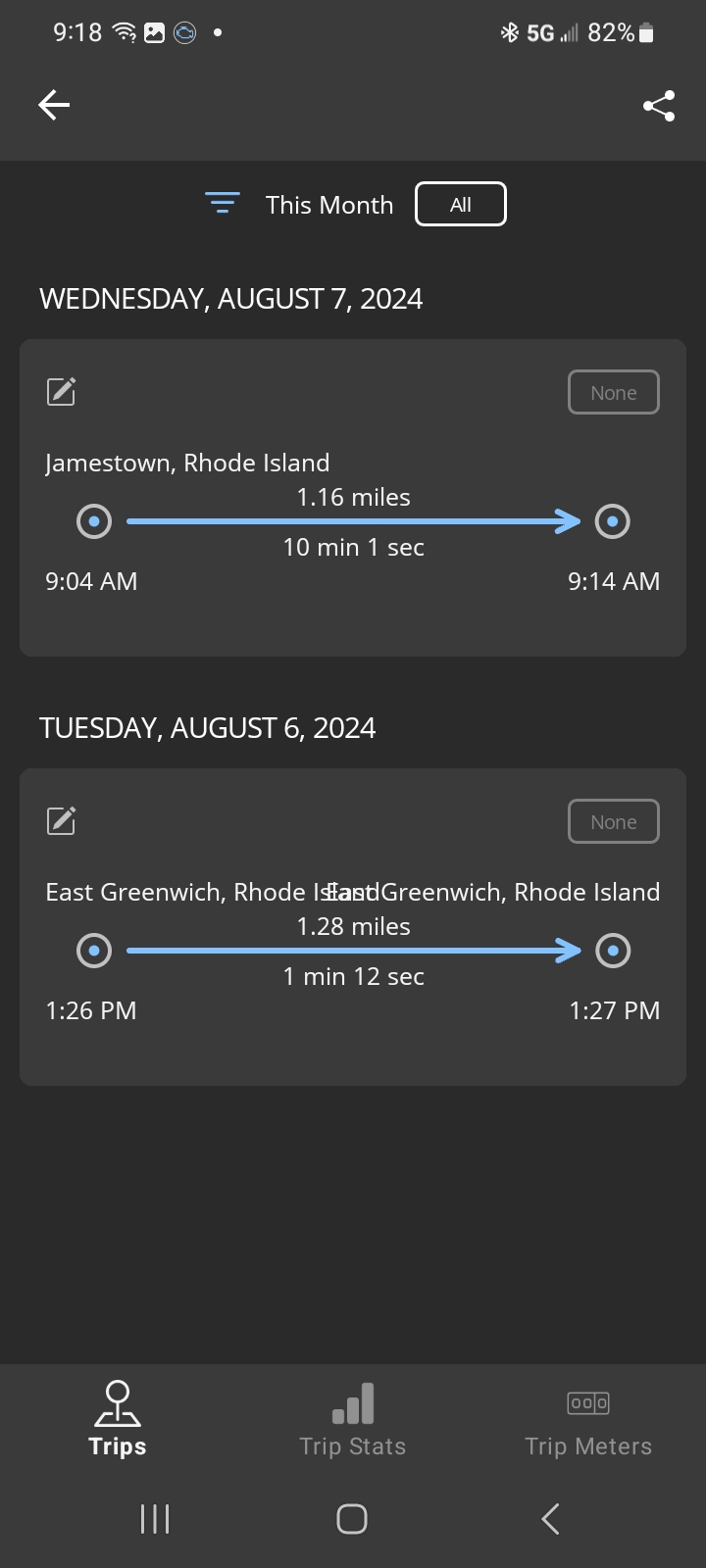

on another note, i noticed my trips are being logged (screen shot). how would i disable the trips? not really big on that.

There are settings to turn off all the logging. Not exactly sure where everything is, but it's in there. Altitude is coming from your phone and not the vehicle. So I'd look at that.

newbies: go to Settings/Preferences/Logging. Mine was set to automatic. i changed it to manual so i can log when i choose.
