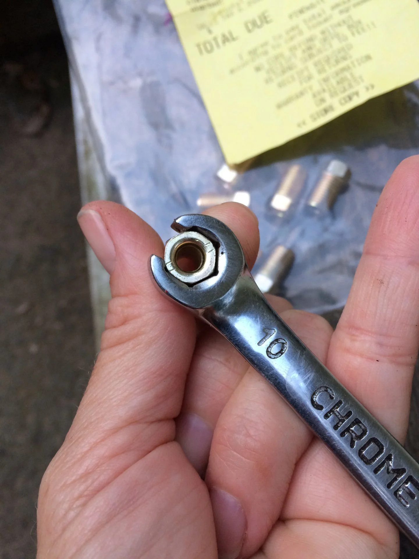

I hate needing multiple size wrenches when working with brake lines. A lot of the aftermarket M10 tube nuts have a 11mm or 7/16" wrench hex. These will be good, stainless too.
Amazon product ASIN B01KNGVPCC
I think so.

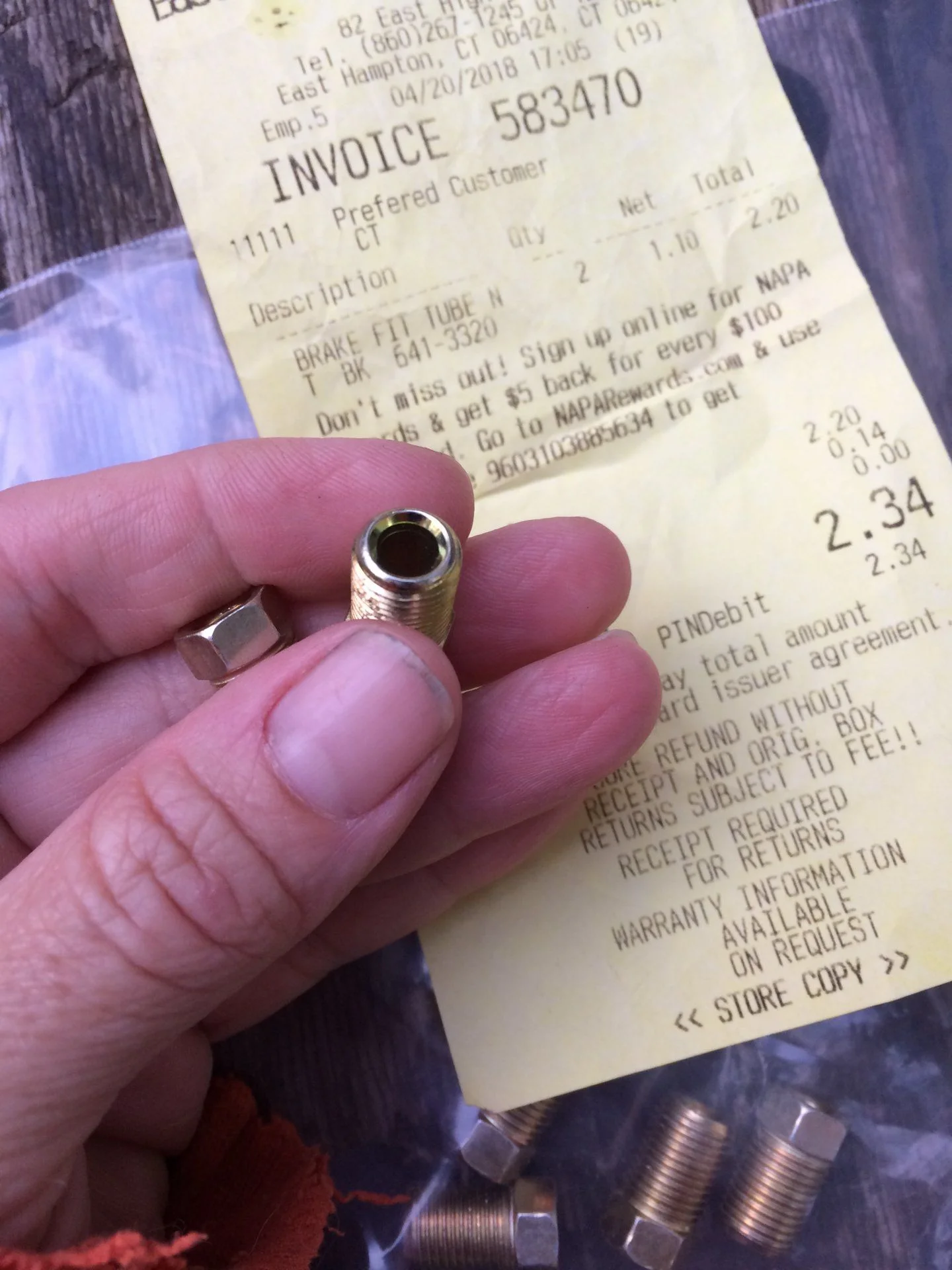

Napa has the long line nuts. P/n 6413320
10mm wrench.

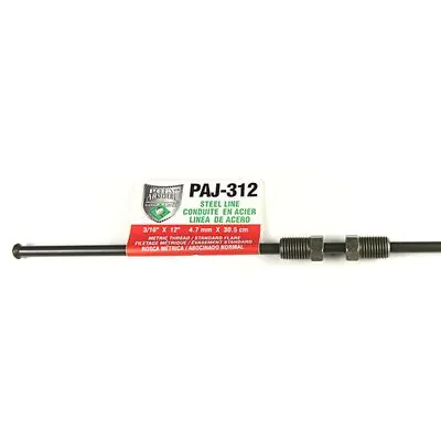

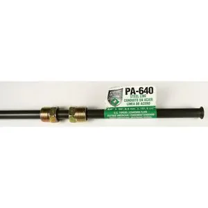

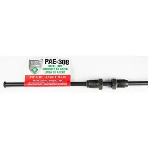

Oreilly and autozone all carry the same stuff. The 10mm japanese lines have a PAJ in the part #, the 3/8 domestic start with PA and the
10mm bubble flare is PAE (european). The numbers refer to lengths. It's best to go into these stores educated. Many of their associates have no clue about the J and E designation

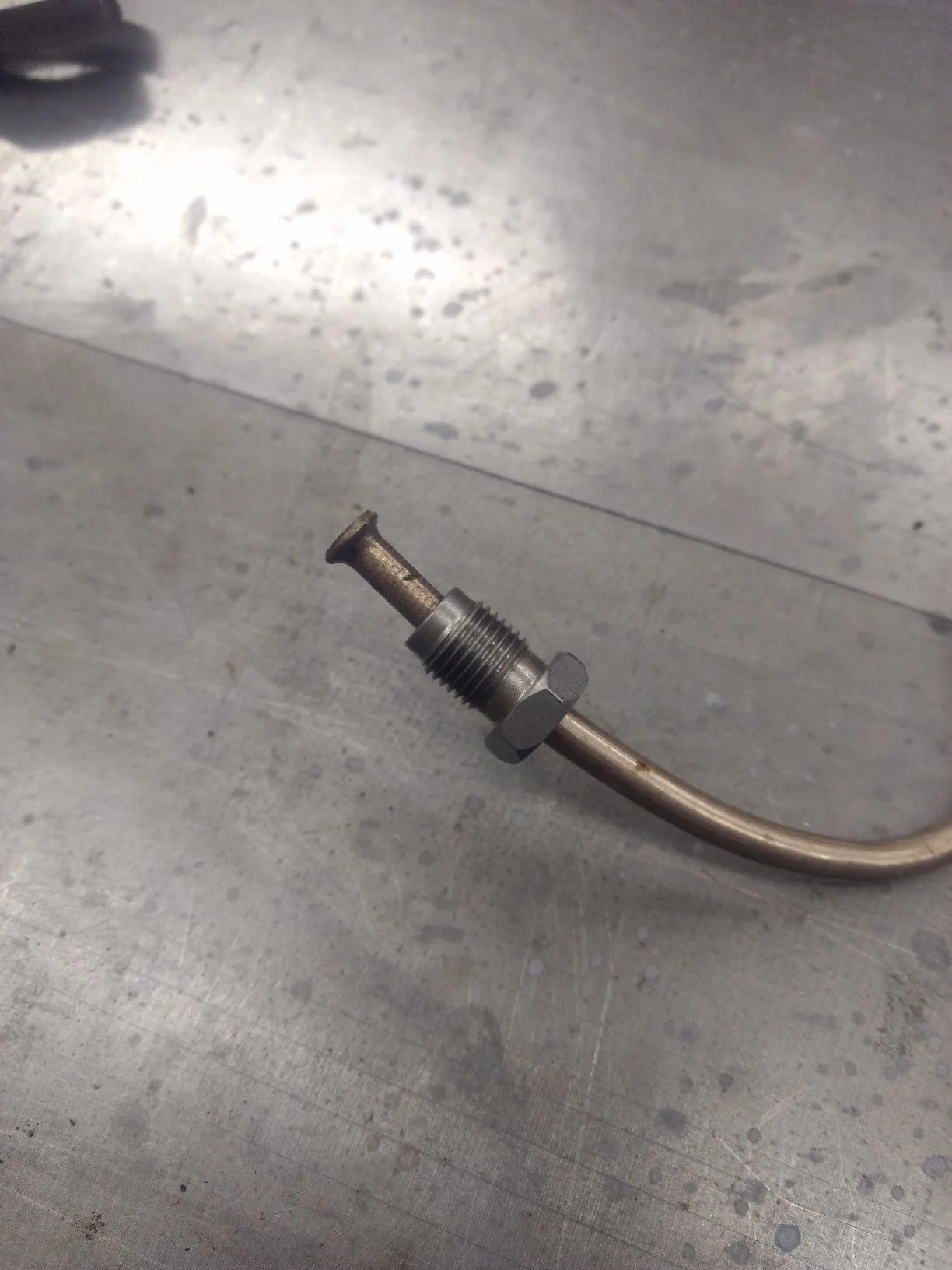

none of the nuts shown (other than the summit racing ones) have the unthreaded part like the OEM nuts. will they still work or is there a toyota specific nut i need to find?
