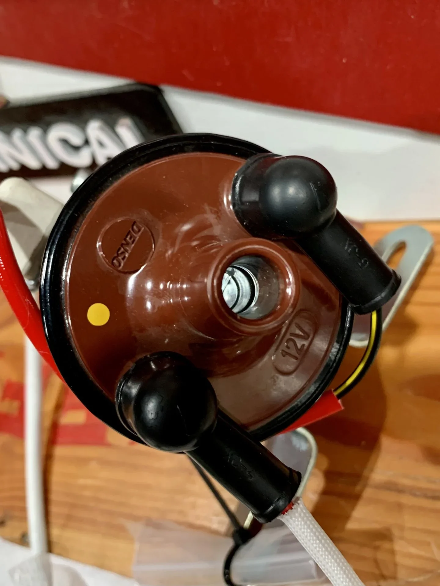

what your dealing with now is a bunch of aftermarket ignition parts , and some OEM ones like the small cap dizzy , these are all various Applications parts ,
- the aftermarket WEBBER carburetor is a separate topic , so we should keep it that way for now , for a bunch of good reasons ...:rolleyes:
- below is a LINK to my 100% TOYOTA OEM Genuine
NipponDenso Japan Spec. plug and play complete ignition system kit form product ...
- i personally designed and engineered each system component to meet and excede TOYOTA' s
Cold. Spec. / SNOW VERSION options package details and features
- i wanted to bring something to the table that is HEAVY DUTY & TOUGH as NAILS ...:idea:
- please take the time and make the time to review the TECH video below , its not only your information source , but installation instructions as well ...
thanks for supprt
matt
