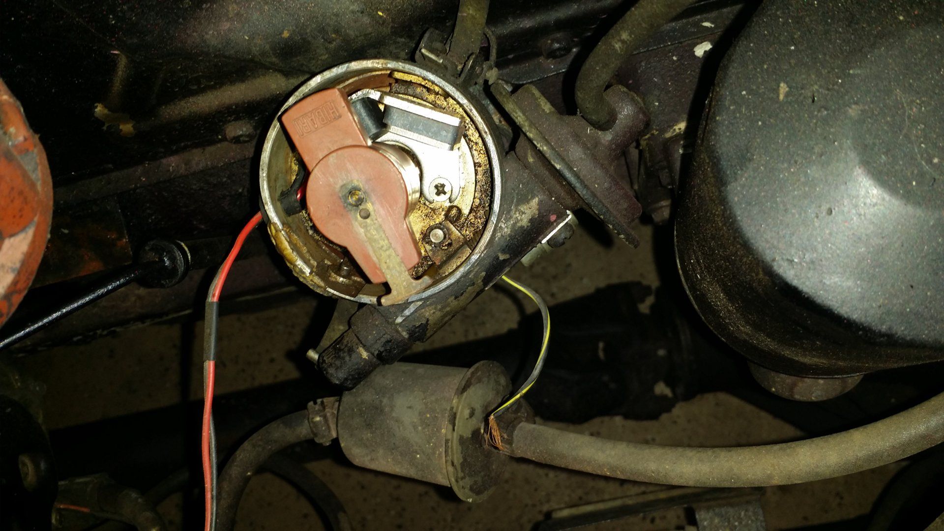

On the underside of my distributor, near the vacuum advance (line to the carb) is a new looking (shiney) round electrical thing...has 1 small wire (black/yellow) coming from it which is cut and goes nowhere. Can anyone advise me of what this is and where the wire should go? The picture is looking up from under the engine. Thanks
Condenser (capacitor). Supposed to be connected in the primary system to reduce arcing when the points open and prolong life of the points. It probably was originally connected at the primary connection of the distributor (IIRC, these was an insulated connection on the side of the distributor). It looks as if your distributor has been modified.

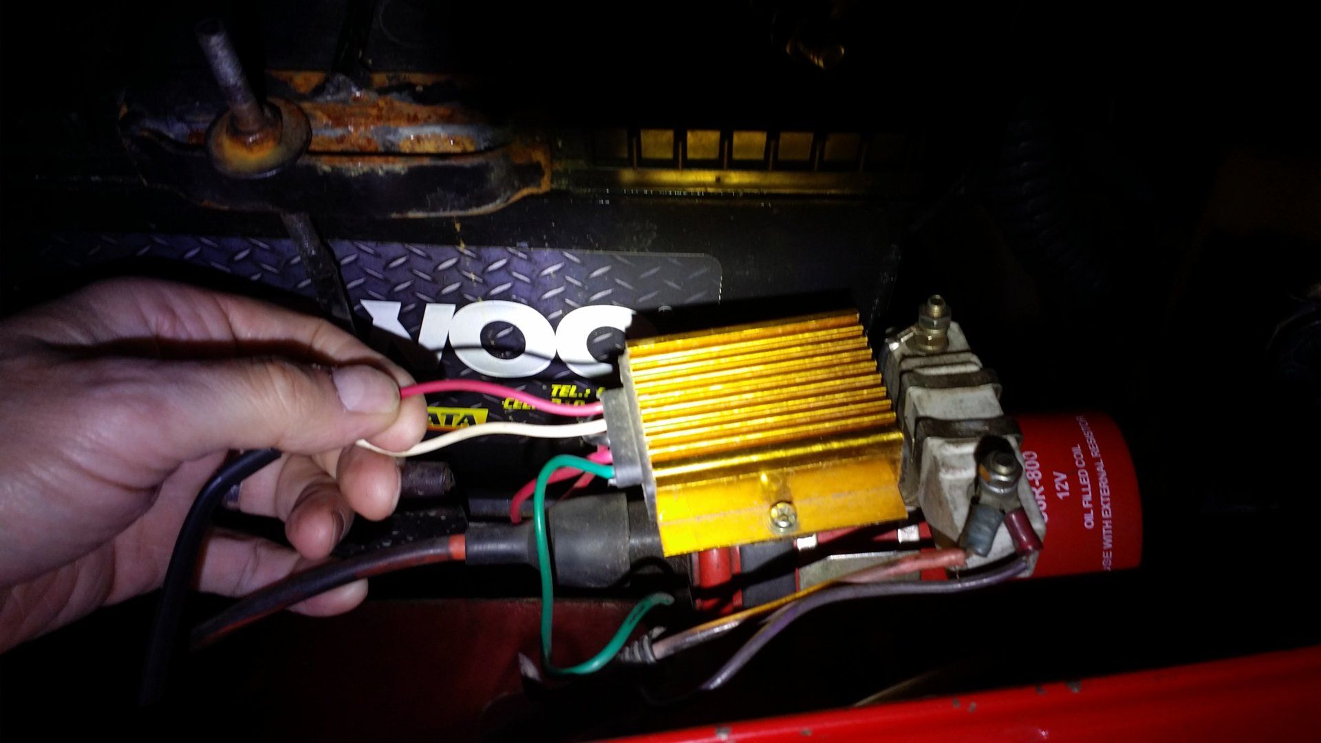

I assume the black and red wires going to the dist. pic 1 (that change to black&white) @ the next pic 2
(holding) going to the dist. indicate that its been changed to electronic...(I have no clue what Pertronix is) pic included.

Center wire from dist. goes to 12v oil filled
Wire he'd by pinky finger is center di
d coil.

Yes, you have electronic ignition, the module inside the distributor replaced the original breaker points.
The condenser in your original post was required for the points, but not for your current arrangement. You can remove it if you can get to the screw, but if you do, replace the screw since it likely plugs the threaded hole into the innards of your distributor.
Thank you sir...I will now eliminate both the obsolete part and my worries of a bare wire.

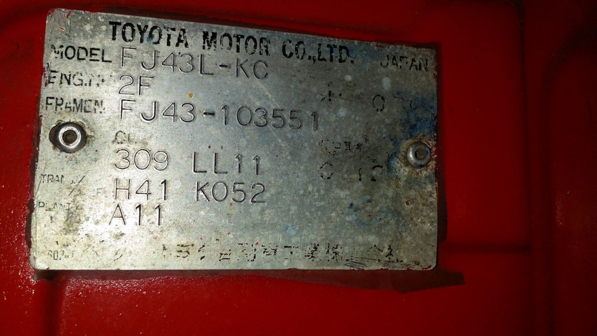

While I have you silver stars plugged in...can you enlighten me on the "missing vacuum line" on the carb..? TIA
Idle compensator for AC. Non US air cleaner and intake manifold as well. Goes along with the H41 of your build tag.
