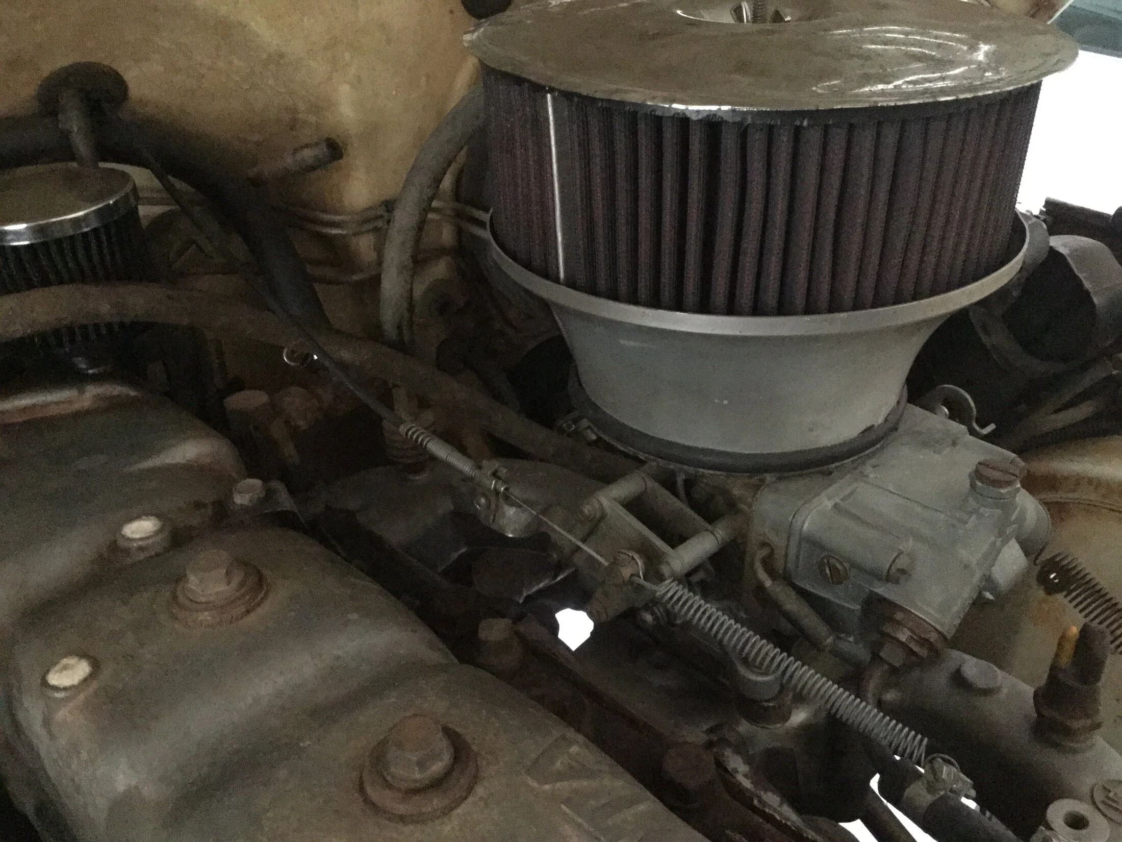

This is going to be my issue. I retrofitted a line to my air cleaner, I drilled a hole to get vac advance, as someone here suggested. I had my hood open the whole time I was working on my clutch slave cylinder, and it’s hotter than the surface of the sun in Ohio here today. It was definitely an explosion, not just the rotor hitting the cap!

That is how I vented mine, drilled a hole to mount it in my air cleaner. Seems plausible to get fumes from there in intense heat that build up in the cap, right?

I was disappointed to discover the cap is unobtanium :( Fortunately, I have a 78 parked in a field at my parents house and was able to battle the wasps under the hood (without getting stung) and pull the cap and rotor from that. Both of them appear to be new, I guess I am on the clock to find a dented side cover and get my 60 dizzy installed, or I should just bite the bullet before I get any older and weaker, lol, and stab the 60 series I bought from Gary a couple years ago. After I installed the cap and rotor, it fired right up and runs better than it did previously. The fuel vapors had to have traveled down the vac advance hose into the cap, but there is another vent on top of the cap that I would think would have exhausted the fumes enough not to combust. If my hood was as thin as modern day hoods, I have no doubt I would have a dent!
