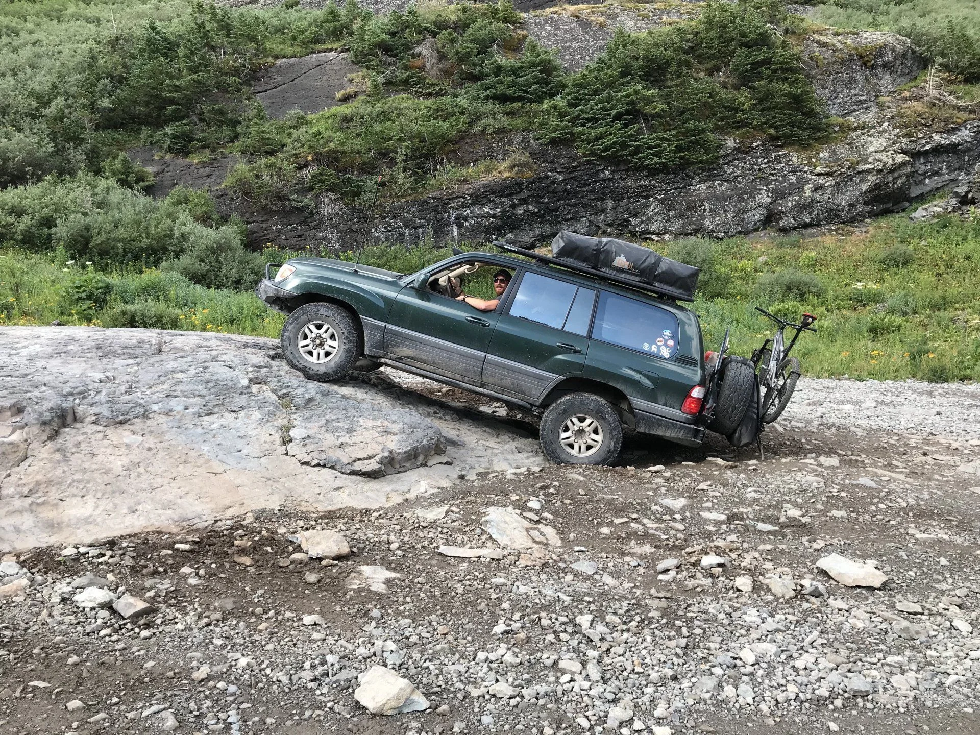

The only thing I've seen is a 1UP that @benc posted on page 46 of the mega modular rear bumper thread here.
Re-post of the picture:
Looks like exactly what I want but before I run out and buy a 1Up, I was curious if anyone else has done the same with another rack.

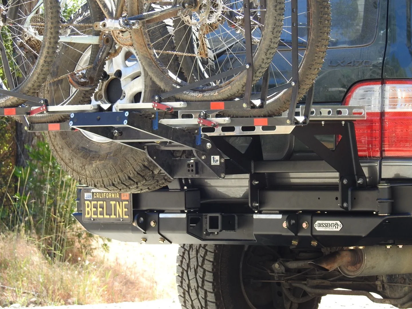

@whirlybirdbrewing The picture you posted is of my 100. I asked Ben if he could design a swing out that can take a tray style bike rack specifically to help with access to the back of the truck. This was particularly important for my wife who is unable to lower the rack when bikes are loaded on it. Ben hit it out of the park and we've been thrilled to have this functionality.
For the design work i loaned Ben two bike racks, the 1UP you see in the picture and a Thule tray rack. Since the Dissent swing out sets the mounting point off center, Ben only recommends the 1UP rack to use on the swing out. The 1UP allows bikes to be set slightly off center to help them stay behind the truck. My 29" full suspension bike does sit slightly wide of the passenger side of the truck, but no wider than the side mirror.
With the extra weight, and more importantly leverage, of a two tray bike rack it is important to not overload the rack and to check the swing out mounting bolts periodically. I tightened mine once and never had them loosen again. I'd only use this setup with two bikes since a third tray would just bee too much. With the Dissent design placing the bike rack mount higher, the clearance is great. Below is a photo from going up Imogene. The bumper or trasharoo hit things before the bike rack does.
Last comment I'll make about the 1UP is this. I've worked in the cycling industry for a few decades. I can buy almost any rack out there for below wholesale pricing and a number of big name brands have sent me racks for free. I paid retail for the 1UP and it is worth every dollar. Other racks work fine but am glad I paid for this one and ave gotten far more value out of it then what the price is. It is the type of rack you buy once and can use for a lifetime.
