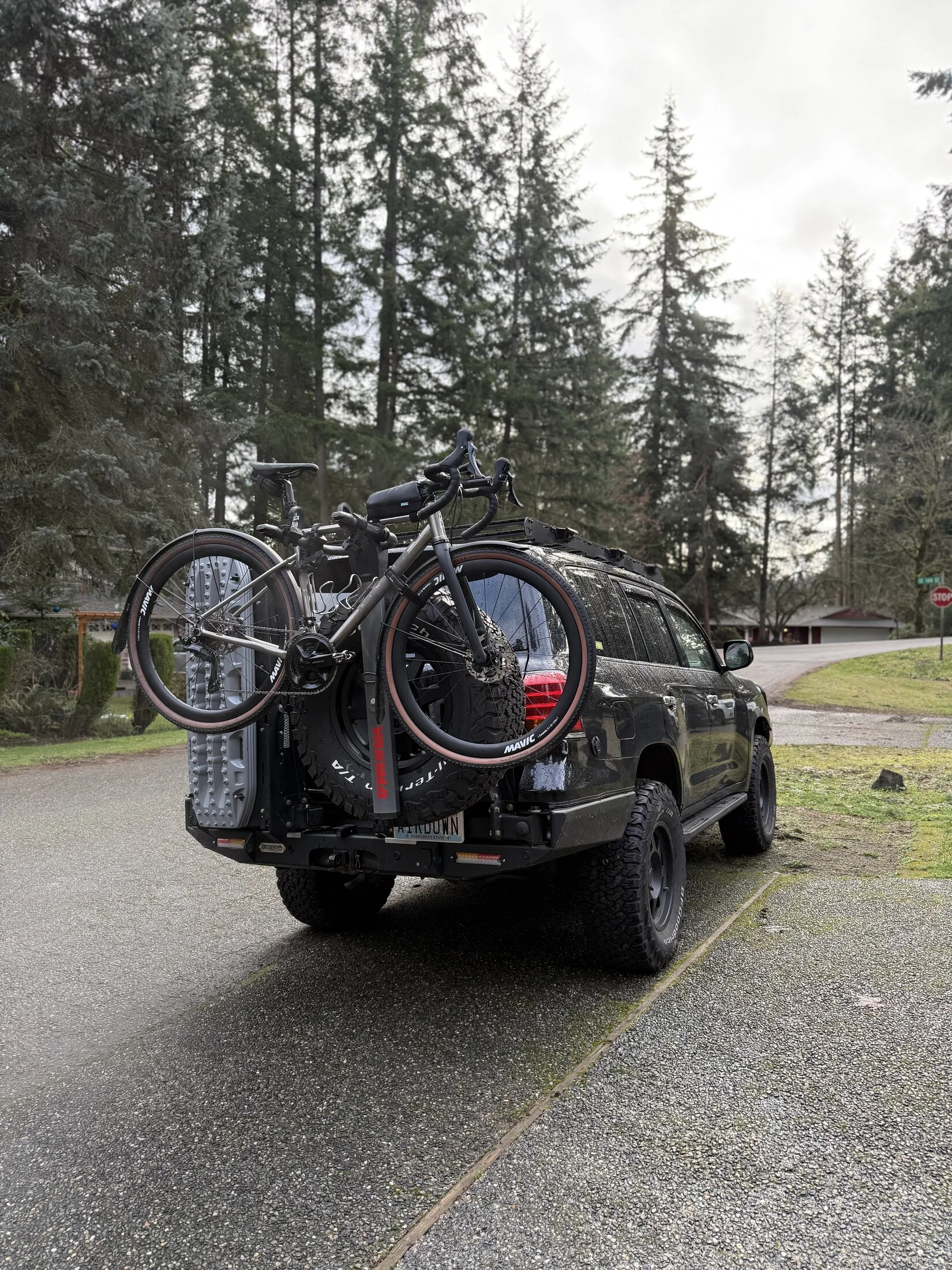

Following along. I’m running a Yakima spare ride and it’s pretty suboptimal. I wish @benc would make a hitch receiver that can be added on to the accessory panel.

Upon closer inspection, I think it's welded and you would have to swap out the entire accessory arm with the tray/basket.... otherwise you would have to go custom.

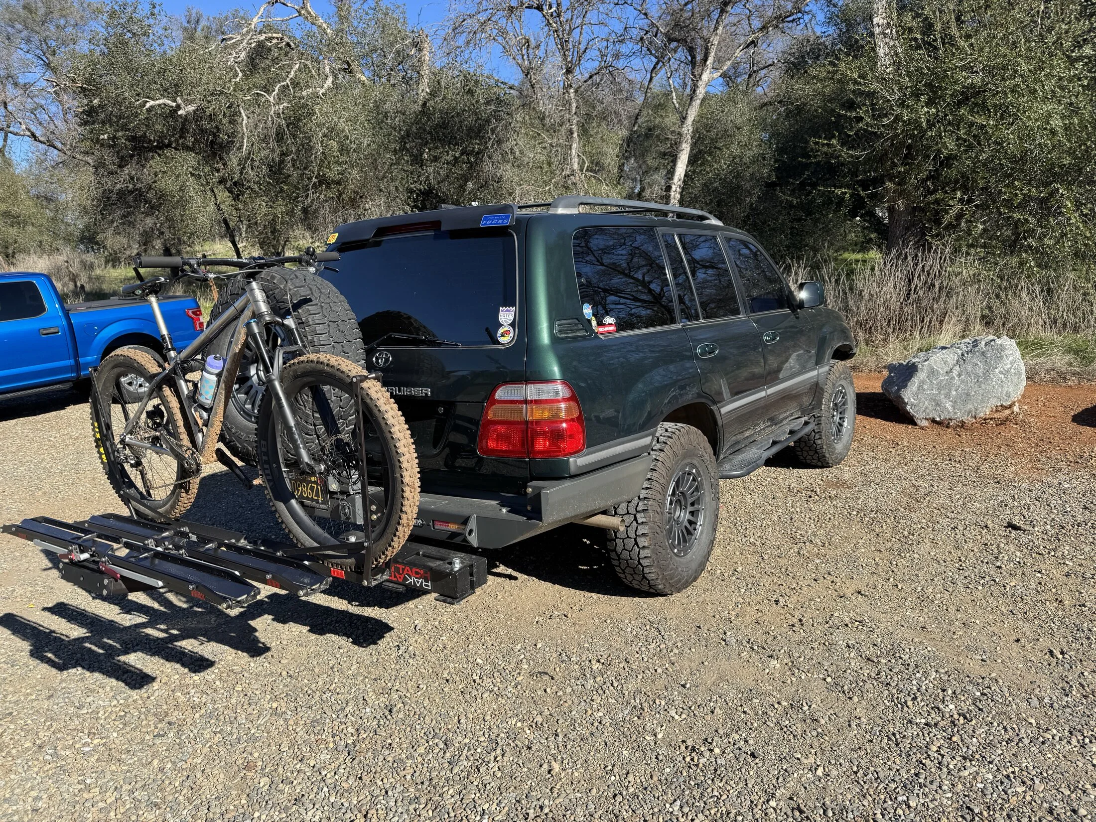

I had the Dissent jerry can swingout, but it was really only for use with my 1up bike rack. But then I found my old RakAttach clears the tire carrier swingout just fine. So I sold the jerry can swingout and just use the RakAttach when I load up the bikes. Impacts the departure angle for sure, but I normally don't drive technical trails with the bike rack on.
Dissent's latching mechanism is innovative and very easy (and probably too minimal if you ask me), but still, the tailgate access is much nicer with only 1 swingout bolted on.

Maybe I’ll go this route. Seeing this photo makes me miss my 98 100. Same color and everything.

w/r to "...to minimal...", I too have thought about that. Potential solution: match drill safety pin clearance hole thru bumper and hand latche. insert a short lanyarded ball detent safety pin, won't vibrate out (in theory), easy to install/remove. Just an idea.

Literally did exactly that after having my rack swing open with bikes on 2x on the freeway. no worries any more.
