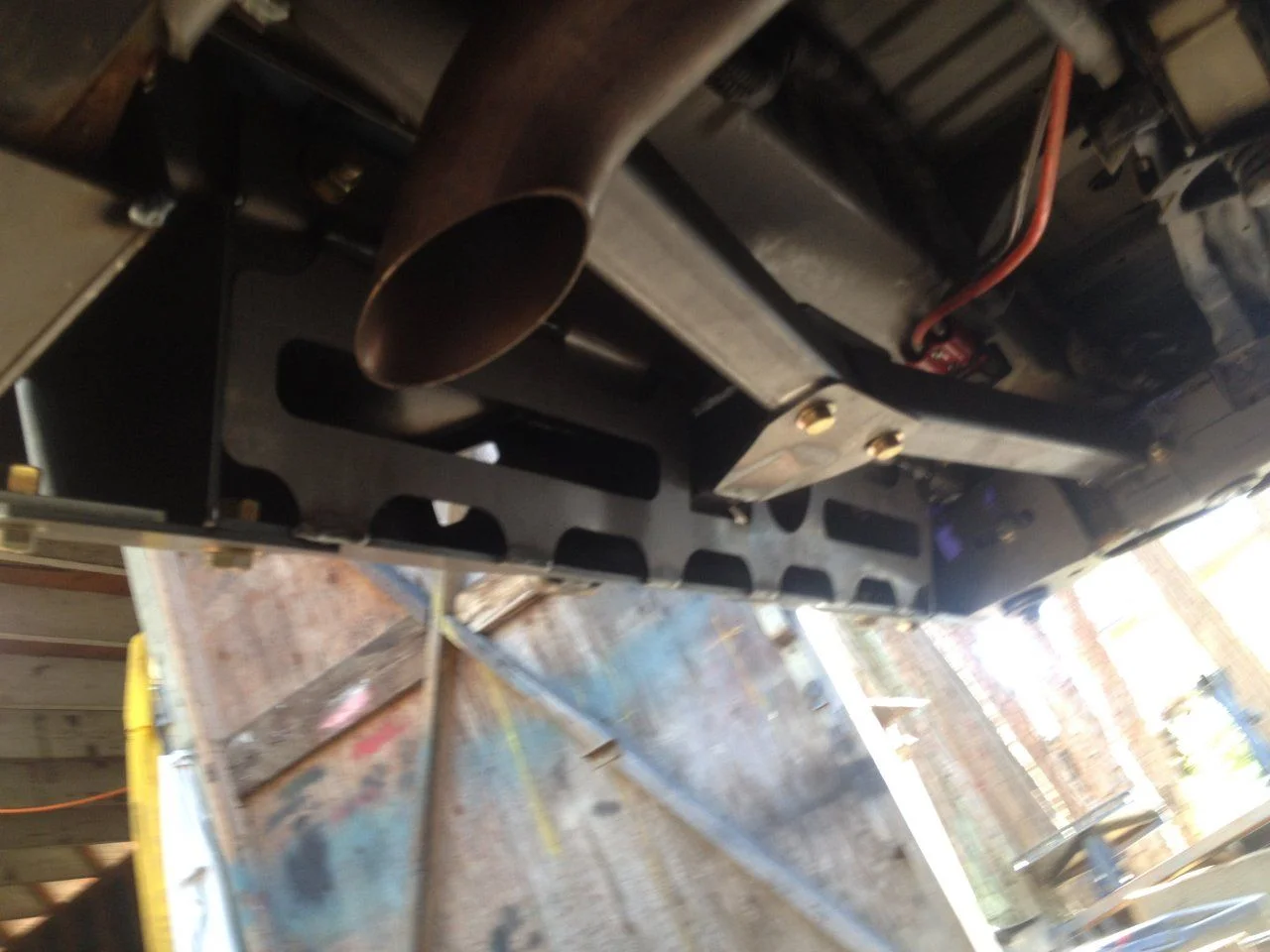

Since this is a modular design, could one get it dialed to his preference, bolt it all up and then weld together so it's all one piece then remove and fill in bolt holes with welds? This would be an even sleeker appearance than countersunk bolts. Your lines are second to none but it'd look so sweet without the bolts, IMO.

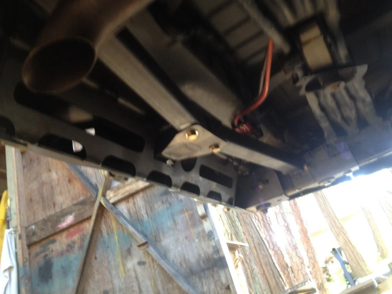

From my understanding of the way it goes together and seeing the pictures you would not be able to fit the wings back around the fenders/body once it's put together.
From looking under the truck it doesn't seem impossible to bolt it together on the truck and then do the welding on the truck to make it one piece. This method would certainly require cutting into pieces to remove it.

It could be possible to weld the the wings and center together but you could not weld the crossmember or end caps.

Great. I'll await final product to see how it all plays out. I personally don't care about not being able to weld the crossmember. What are you referring to when you say end caps...where diagonals bolt to wings? I'm assuming it could be installed/uninstalled with welded caps, albeit more labor intensive and 2 man job?

Sorry shoud have been more clear, the end caps at the fender well may not be able to be welded on.

Ahhh, got it. If that's the case I think I'll stick with the bolts then. How does one go about countersinking for a bolt head?
The bumper uses 1/2" bolts so you will need 1/2" counter sink bolts and the counter sink to match. Should be pretty simple just doesn't make sense for production.
