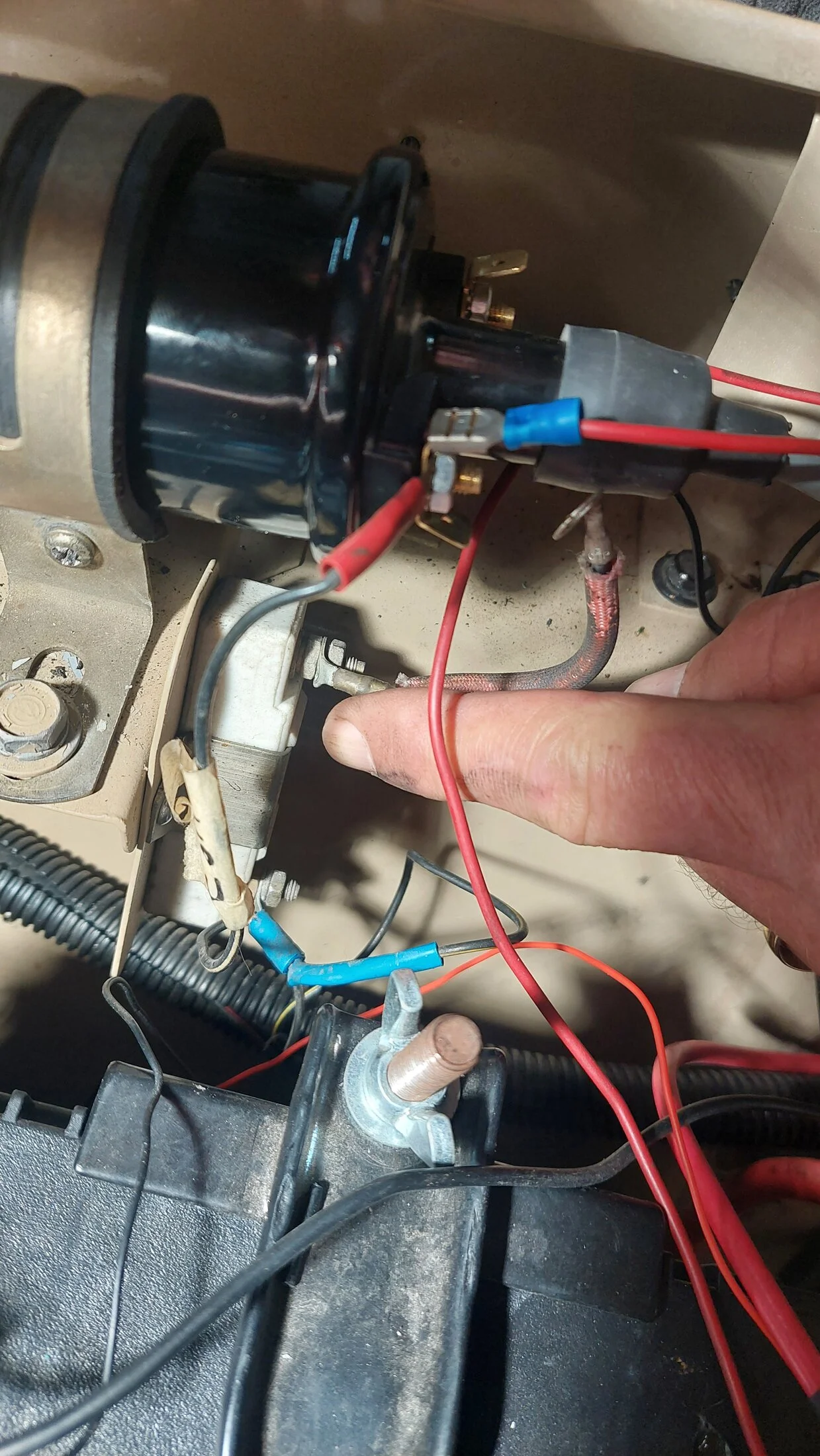

From the instructions it looks like there needs to be a capacitor between the coil and the pertronix.

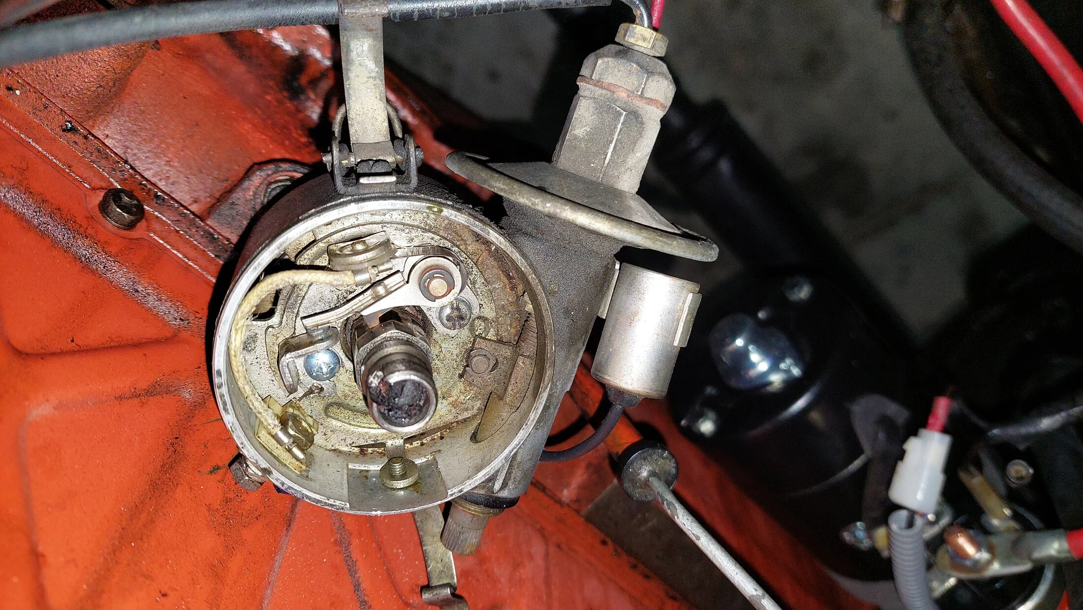

I do not see a capacitor on the coil. There is a capacitor on the distributor but I don't know if that will be in line between the coil and the protronics.
Will I need to add a capacitor to this?

The finger is pointing at a resistor. The capacitor would have been under the distributor cap. Round, about 3/4” dia x1” long with a screw down hold tab and a single wire coming out one end.
IIRC, it's a 15-mf capacitor that's required
Cvsn, the item you're pointing at is a blast resistor.
It supplies current to the coil during cranking via the crank wire from the starter.
If it wasn't there, the ignition feed in the run position would activate the starter solenoid and the coil.
With the blast there it can't put enough current through the system to throw the solenoid or operate the starter.
You need one with a pertronix, or it may not start in the crank position...
If you own a selection of 1n5404 diodes you can use one to do the same task for very cheap.
A capacitor is not needed nor should be used with a pertronix setup. The capacitor helps the points contacts from excessive wear ( burning)
The ballast resister (load resister) reduces the voltage to the coil (if the coil doesn’t a high enough internal resistance) - which also happen the points contacts from excessive wear and reduces the heat of the coil during operation.
