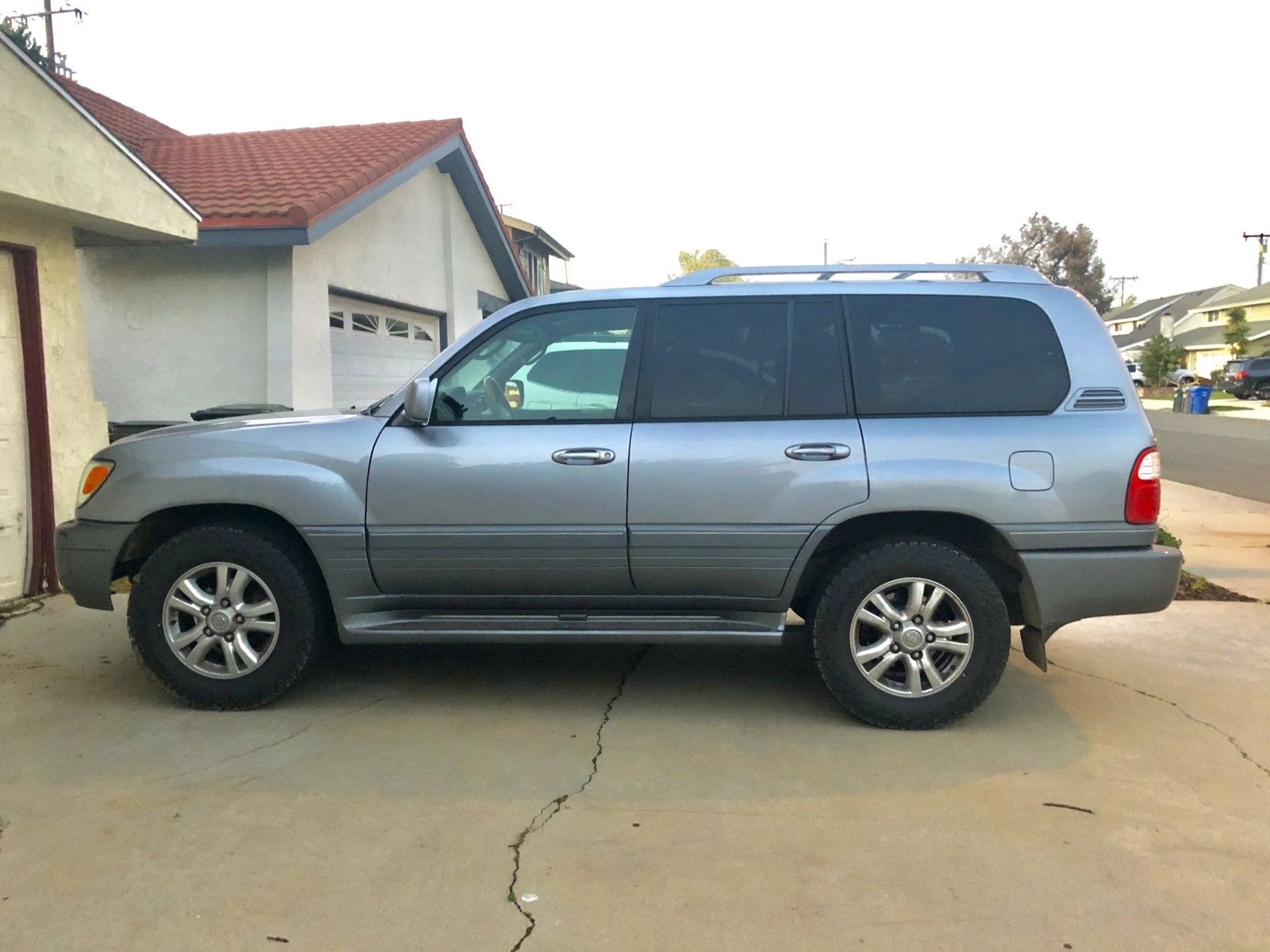

I took ownership of this bone stock LX on December 26 with 177k miles. It is in immaculate condition, it's history says that it spent its life prior to my ownership with one owner in Newport Beach, CA probably crawling the malls and living the easy life.

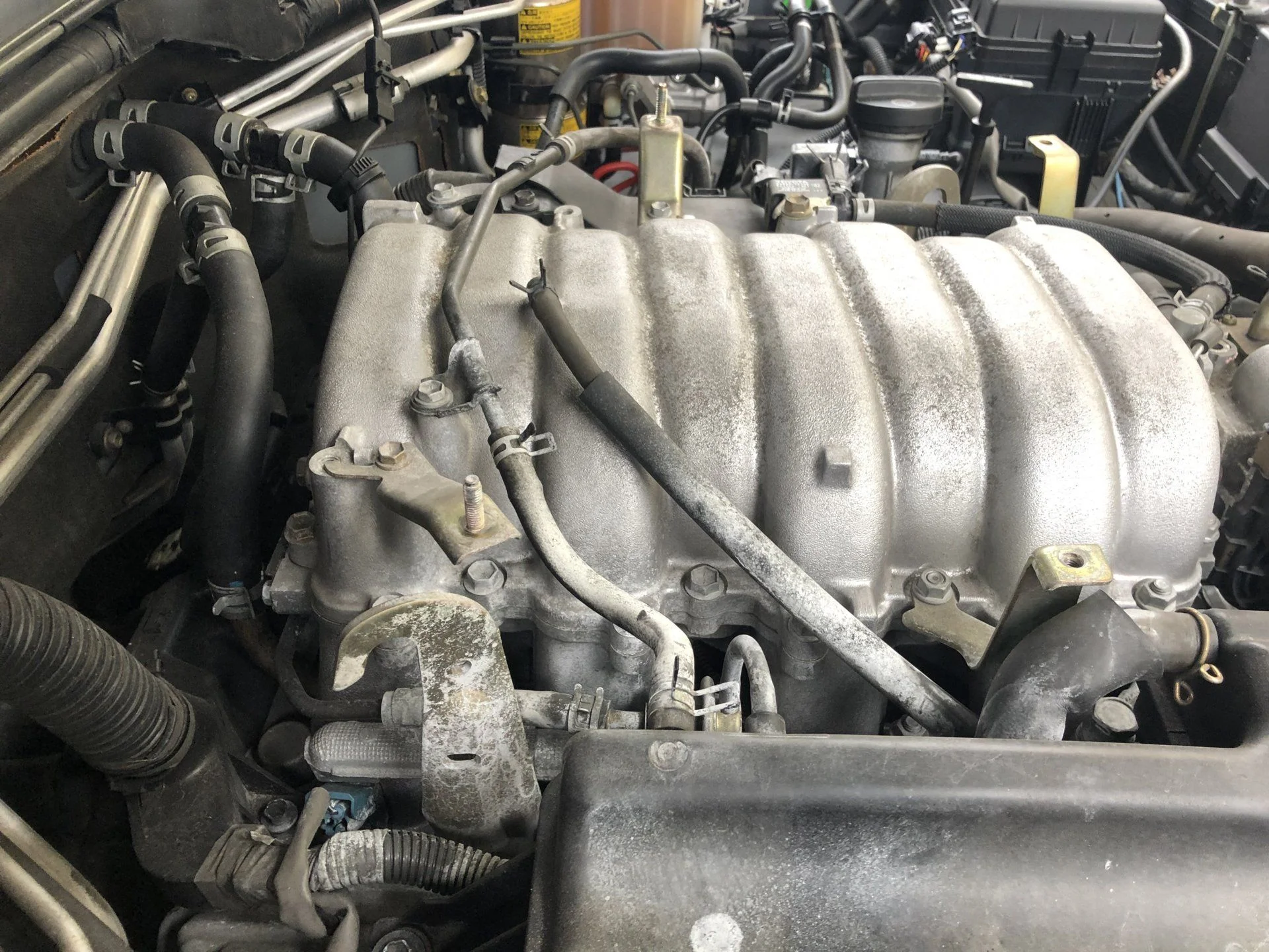

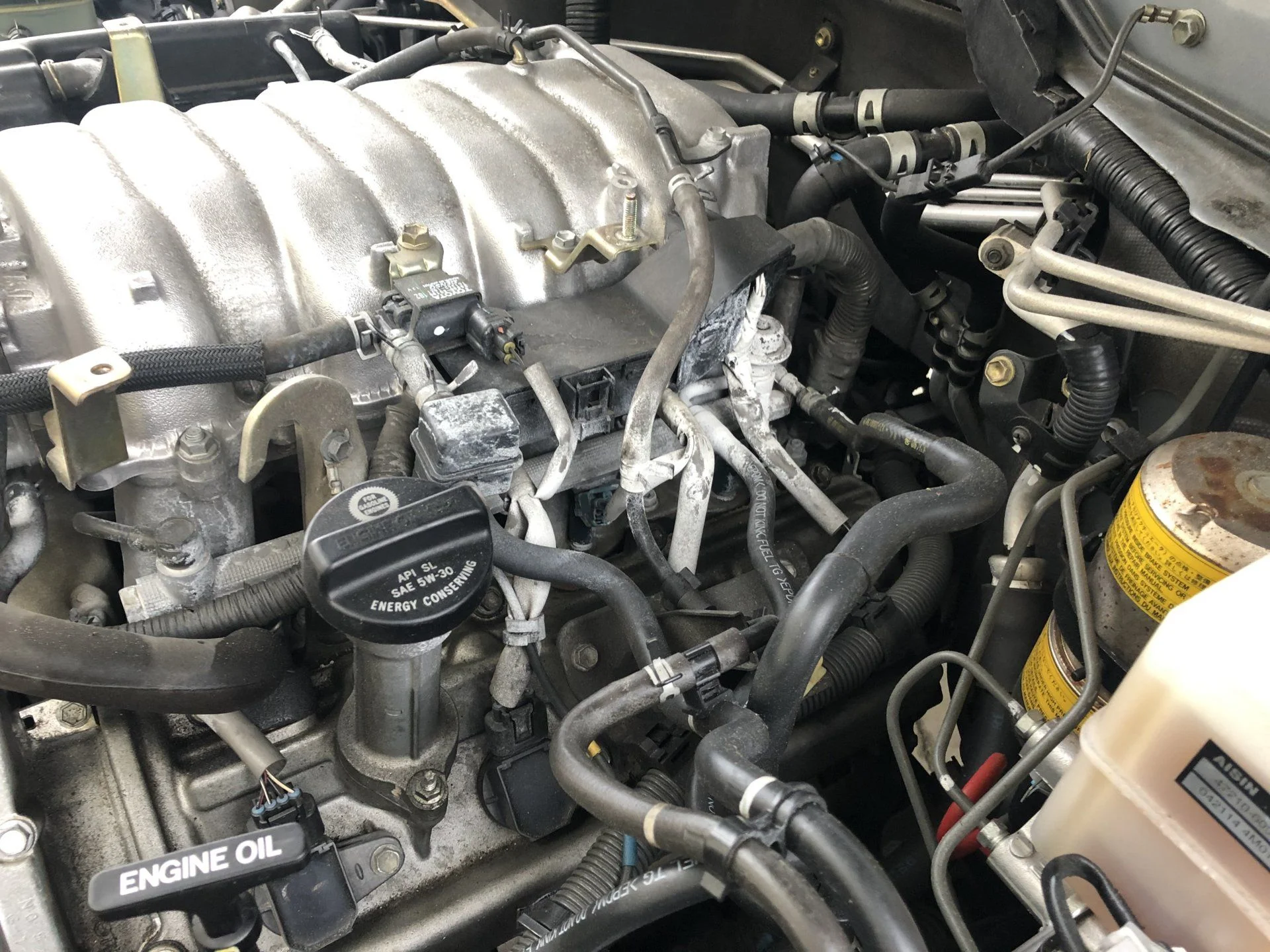

Thanks everyone for your comments. I went in to change my heater T's today and found that there is white stuff on a bunch of hoses and cable covers under the cosmetic engine cover. Is this coolant from a past leak? I don't see any evidence of a current leak FWIW. Is there anything I should be checking into in more detail?

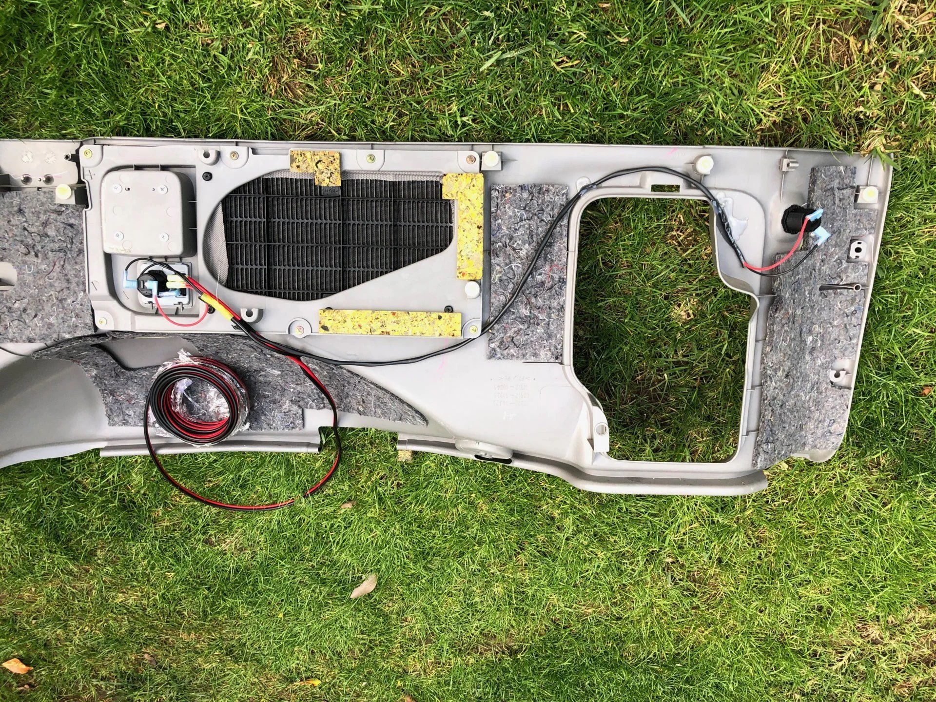

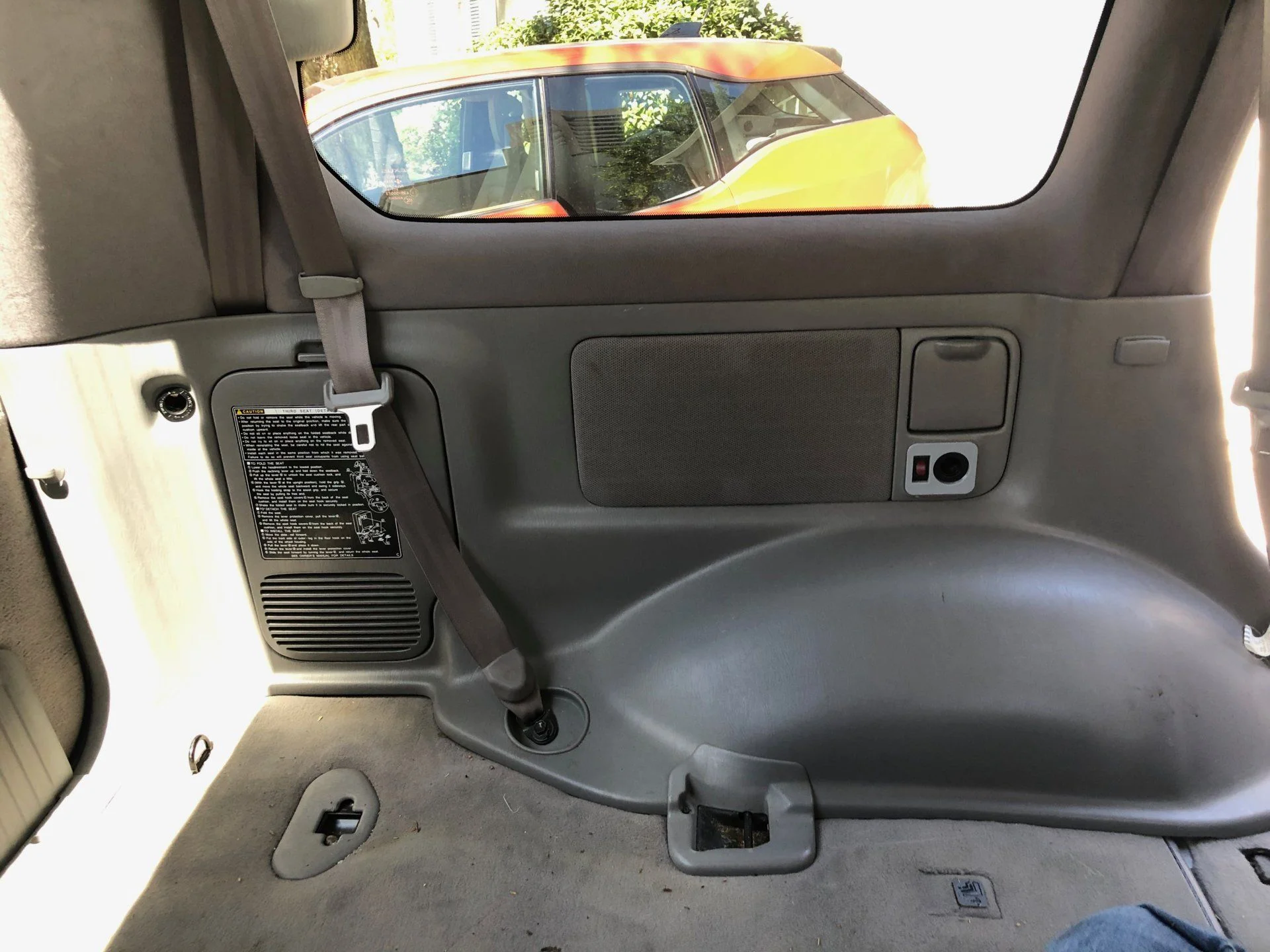

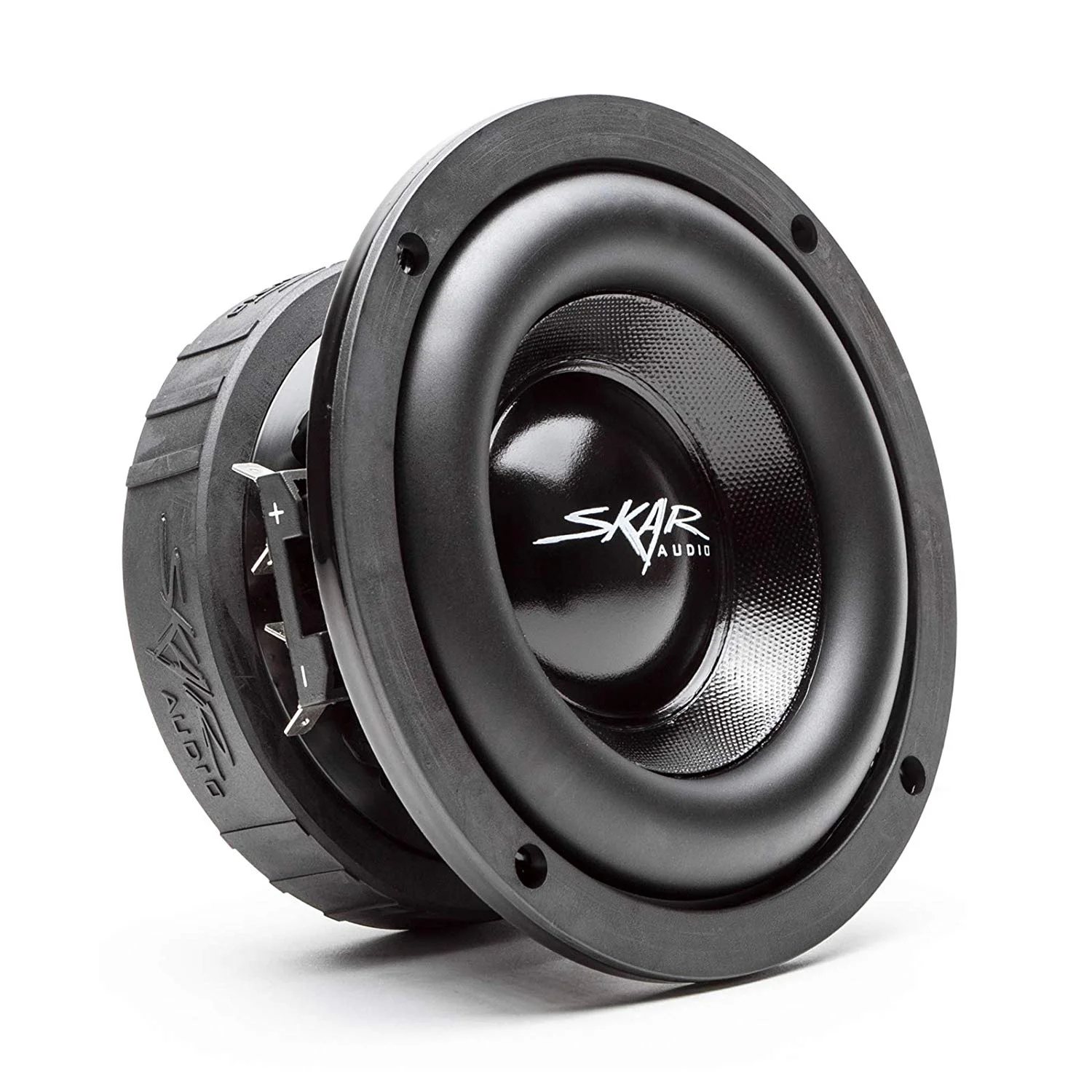

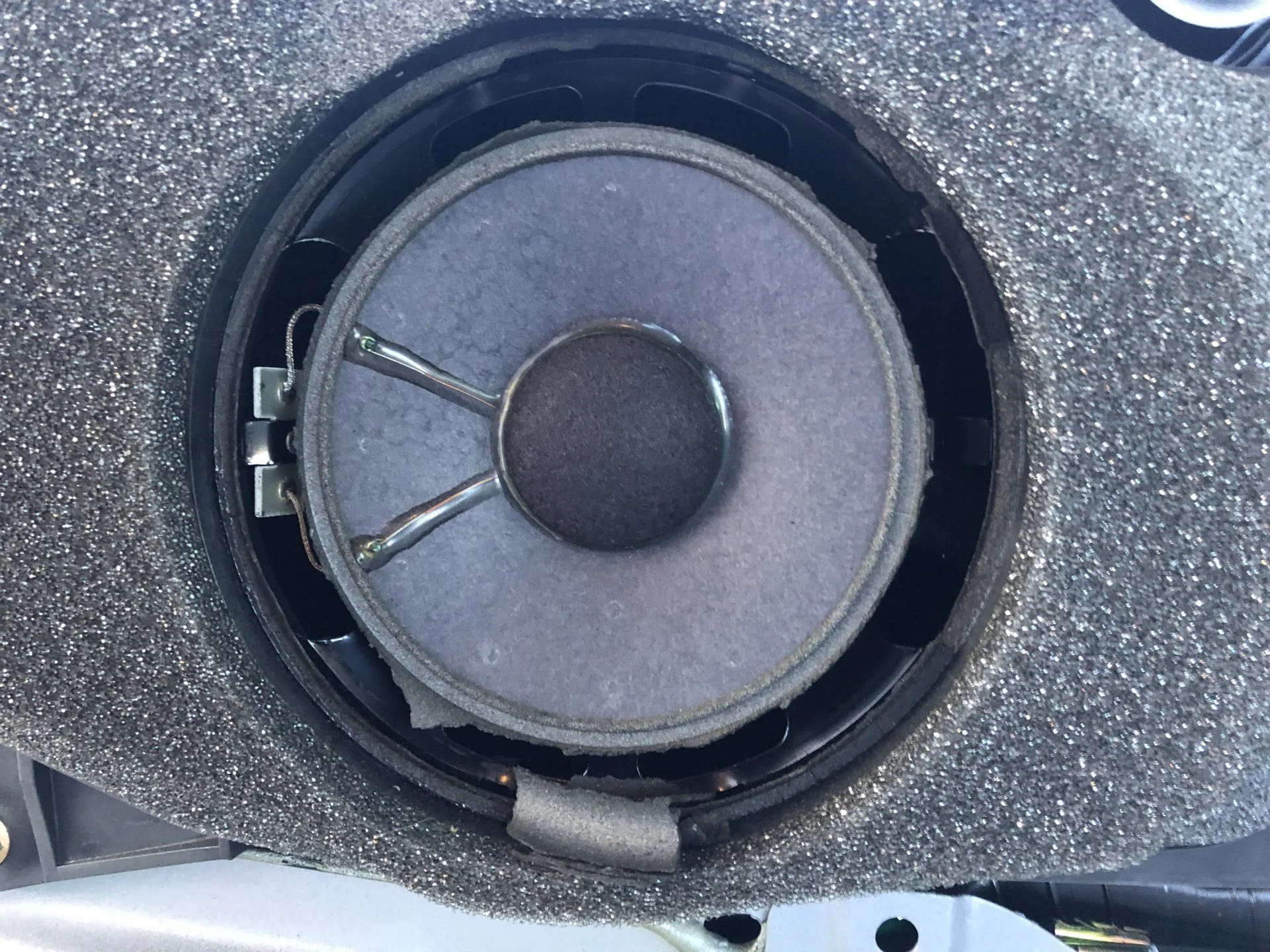

This weekend I tackled the horrible condition of the sub. The condition of the surround was not a surprise, what was a surprise was that the existing sub was not a dual voice coil as I was expecting.
I hooked up my Skar audio replacement in both parallel and series and found that the series configuration (8 ohm) sounded much better.
Amazon product ASIN B019WYPLIA
In a classic bonehead move I forgot to take a picture of the installed speaker....
It sounds much better now but the poor condition of the front speakers are now apparent.
I also ordered a Gamiviti Expo++ rack and am eagerly waiting the 6 weeks until it arrives.
1932253

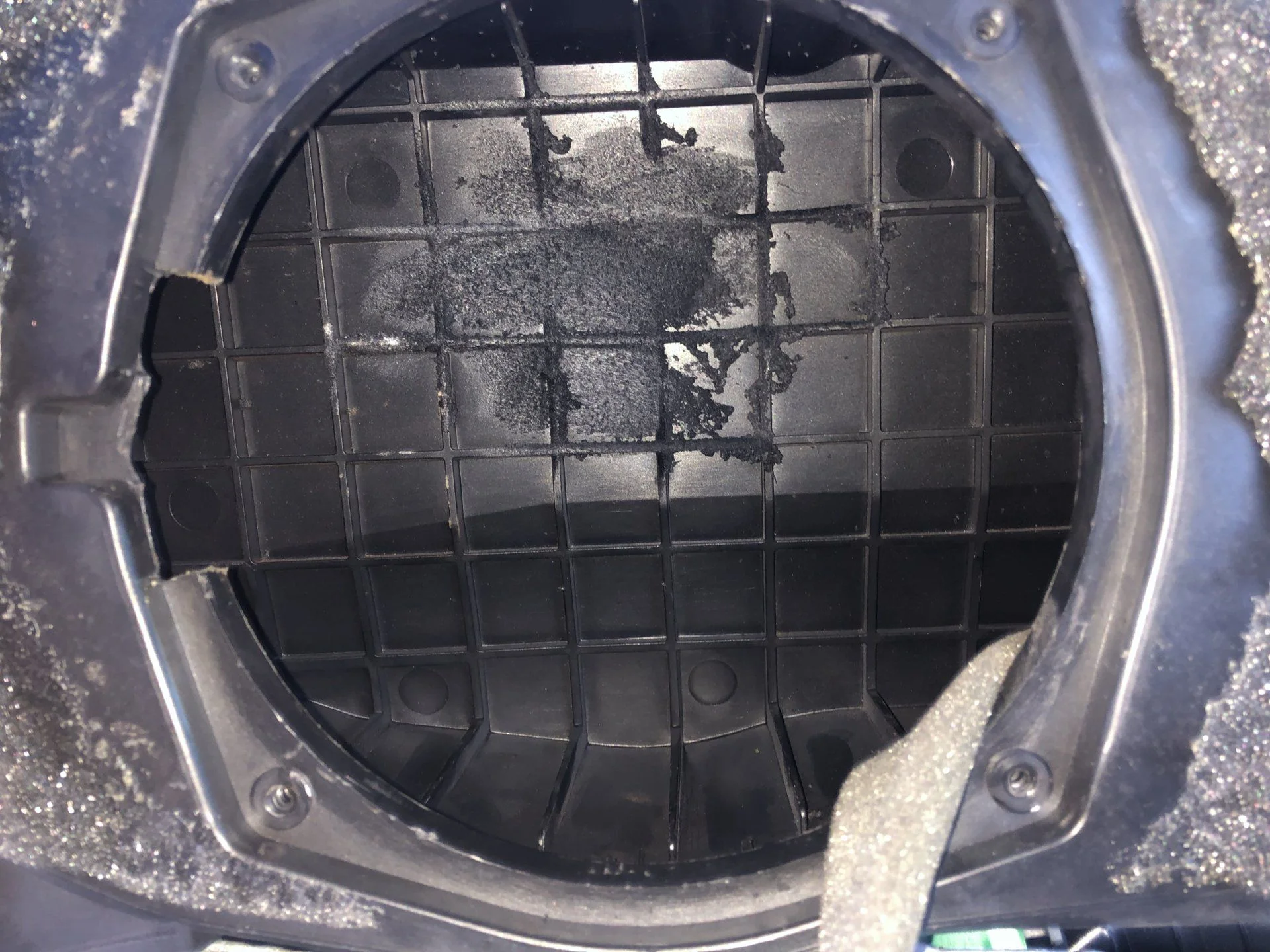

The back of the enclosure required some grinding of the grid to make room for the deeper than stock speaker.

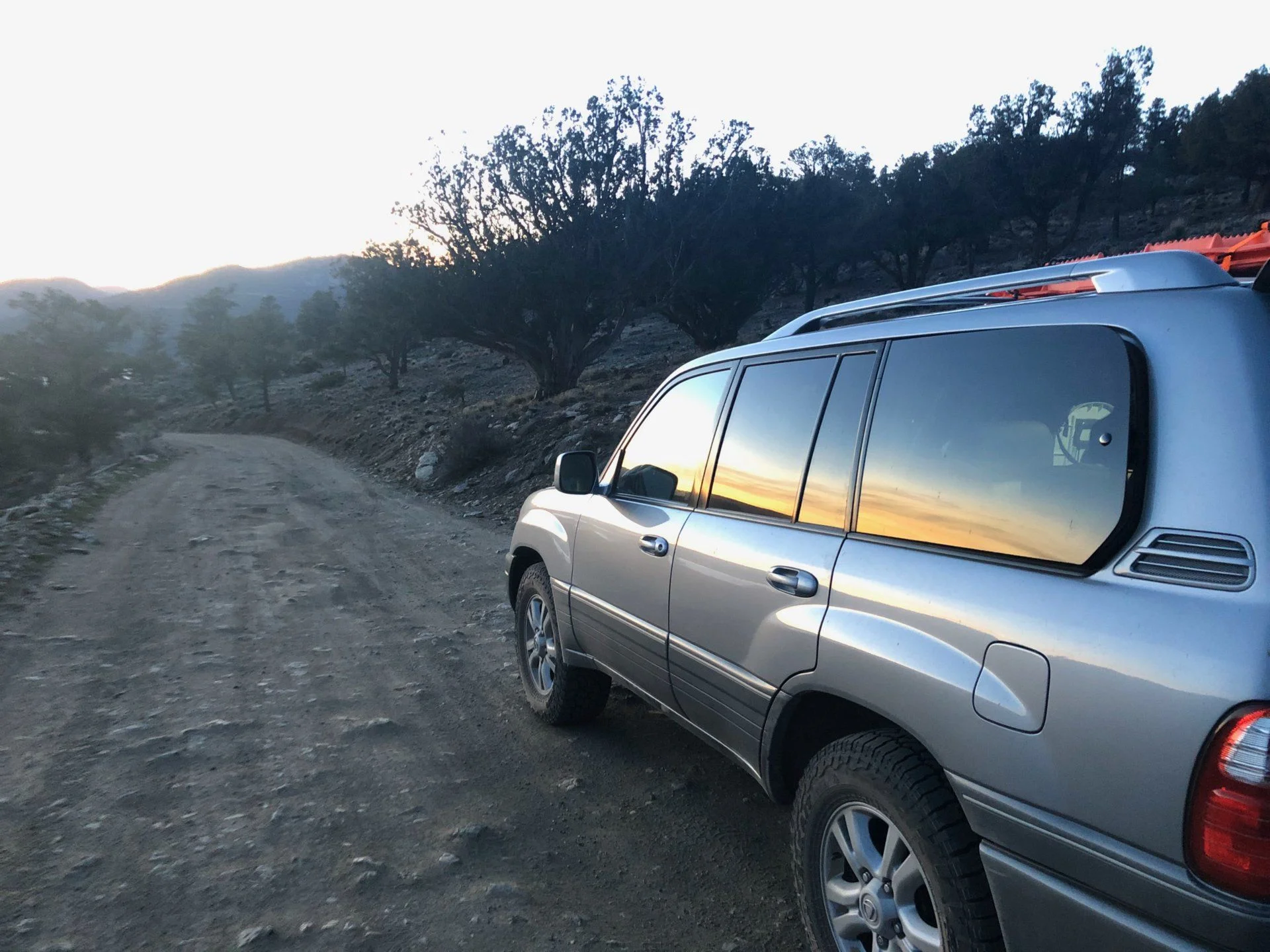

Our first real off road trip was to take the Burns Canyon Trail from Joshua Tree to Big Bear with a side trip up sidewinder canyon (by accident). We didn't finish the trail until after dark which highlighted the need for some additional lighting for our off road adventures.

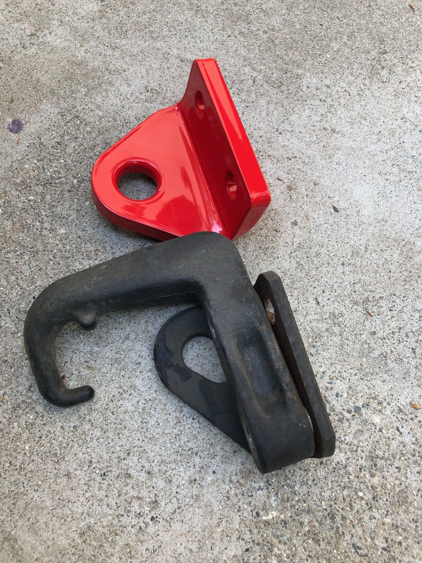

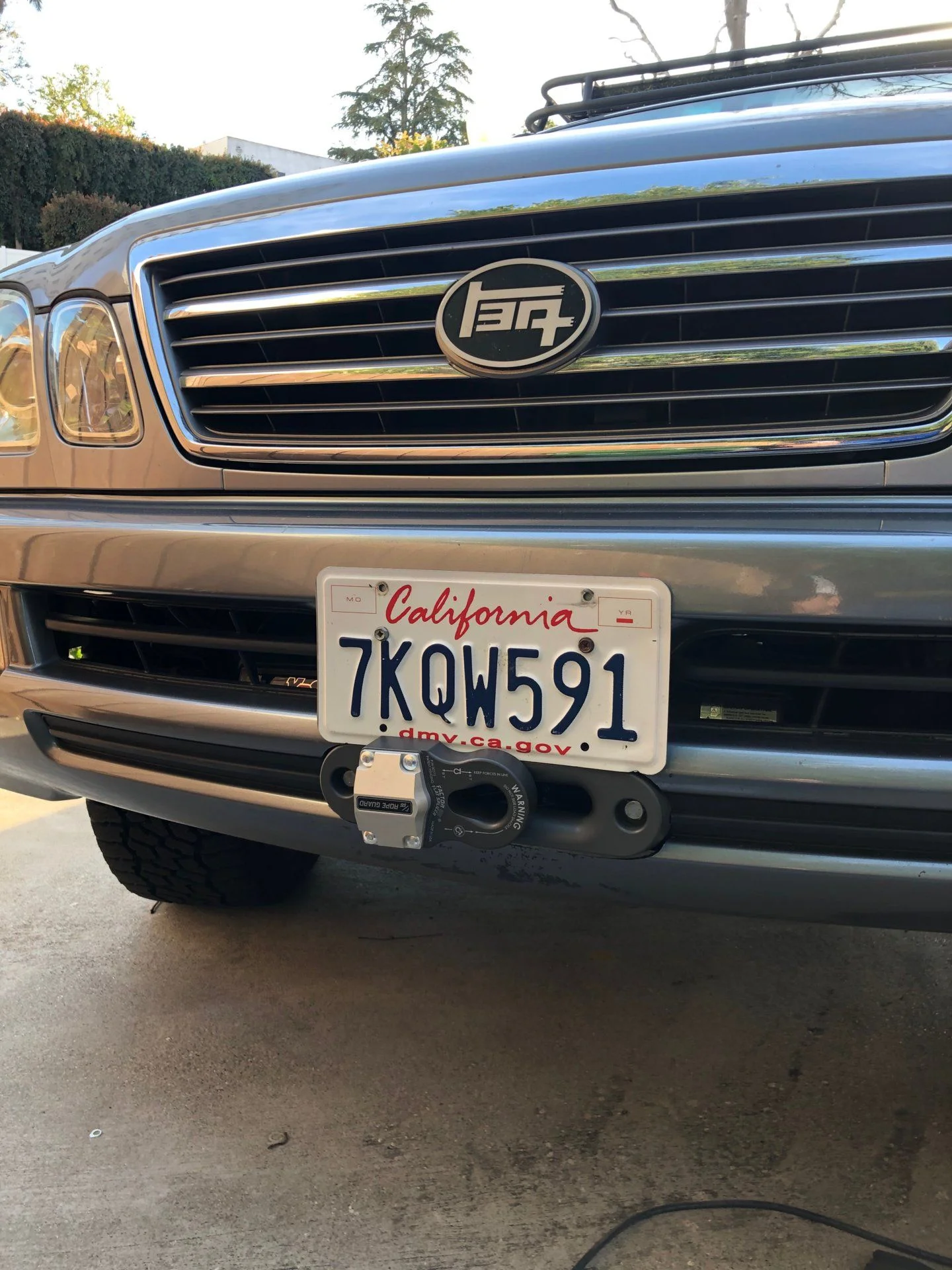

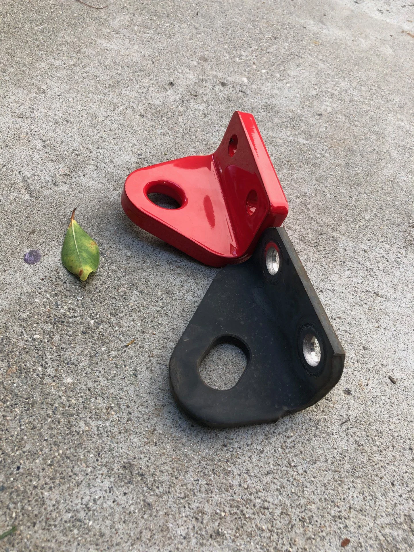

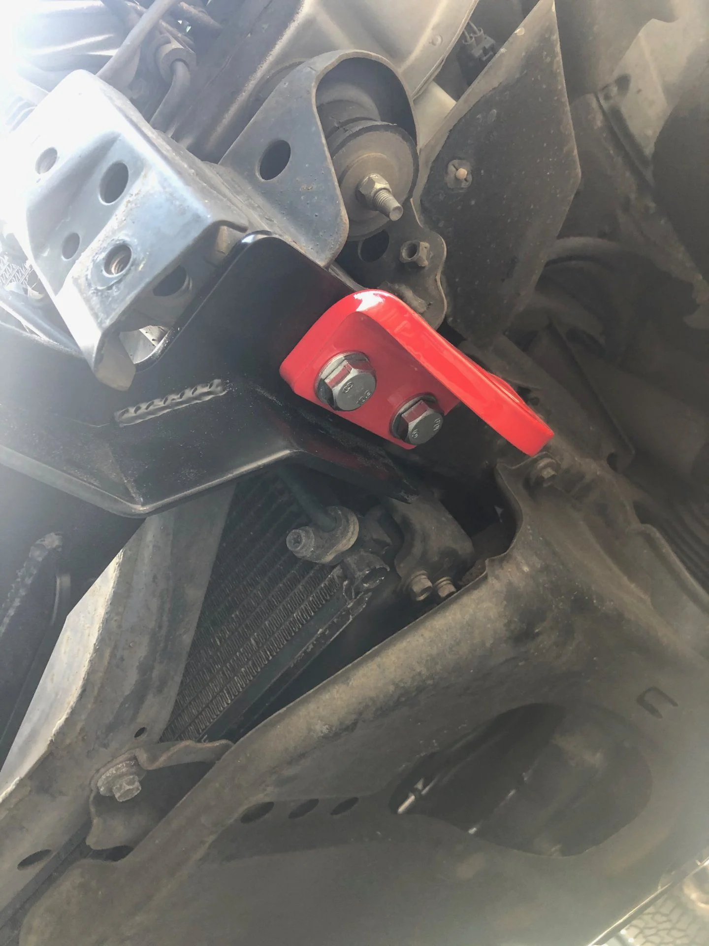

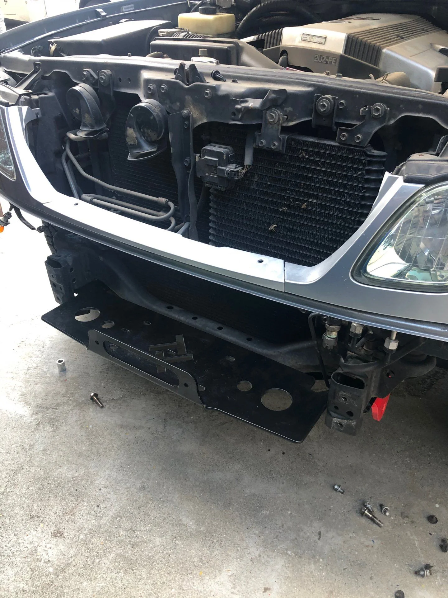

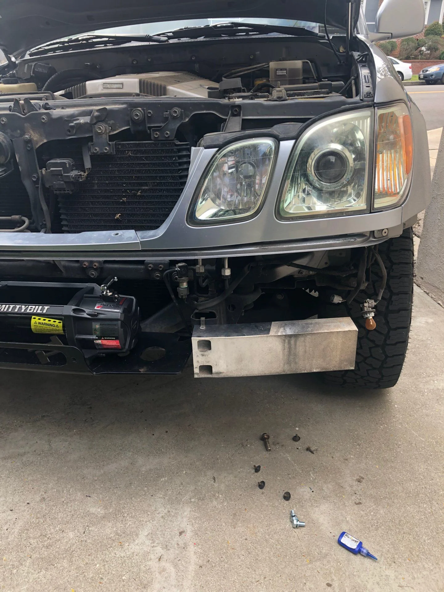

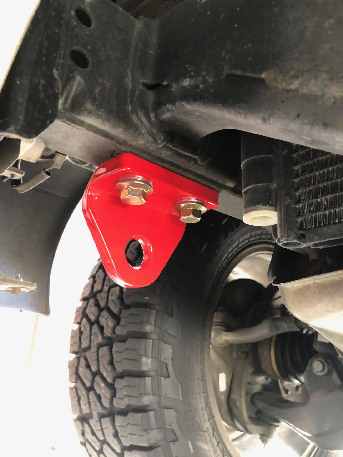

After installing the front recovery points I then got to installing the @TRAIL TAILOR hidden winch mount only to find that it uses the same mounting holes. Doh.
The instructions for this hidden winch mount are very good except for a couple of differences in my case.
When installed with the tow points the supplied bolts are not long enough. I ordered 55 mm long bolts from bolt depot which did the trick.
The fairlead included with my winch was quite thin and in order to get it to sit above the LX bumper cover I purchased the Factor 55 1.5" thick fairlead. This fairlead comes just above flush with the bumper cover and blends well.
Again the bolts supplied with the winch would not work so I ordered 1.5" long replacements from Bolt Depot.

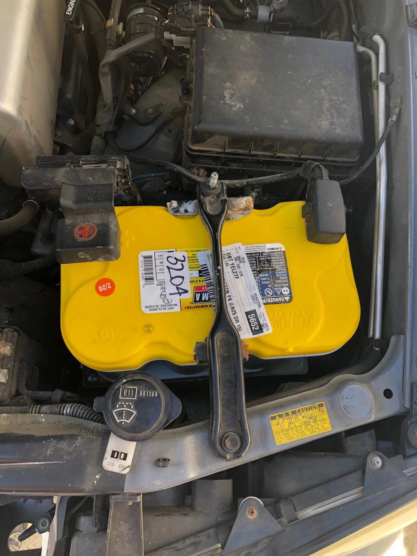

Dirt Baby got a new battery today, the Optima D27F YellowTop. Someday after the AHC dies completely it will be paired with another in that location.
I also ordered a variable voltage booster to charge the battery correctly. We'll see when it shows up, with the coronavirus thing going on I'm not holding my breath.

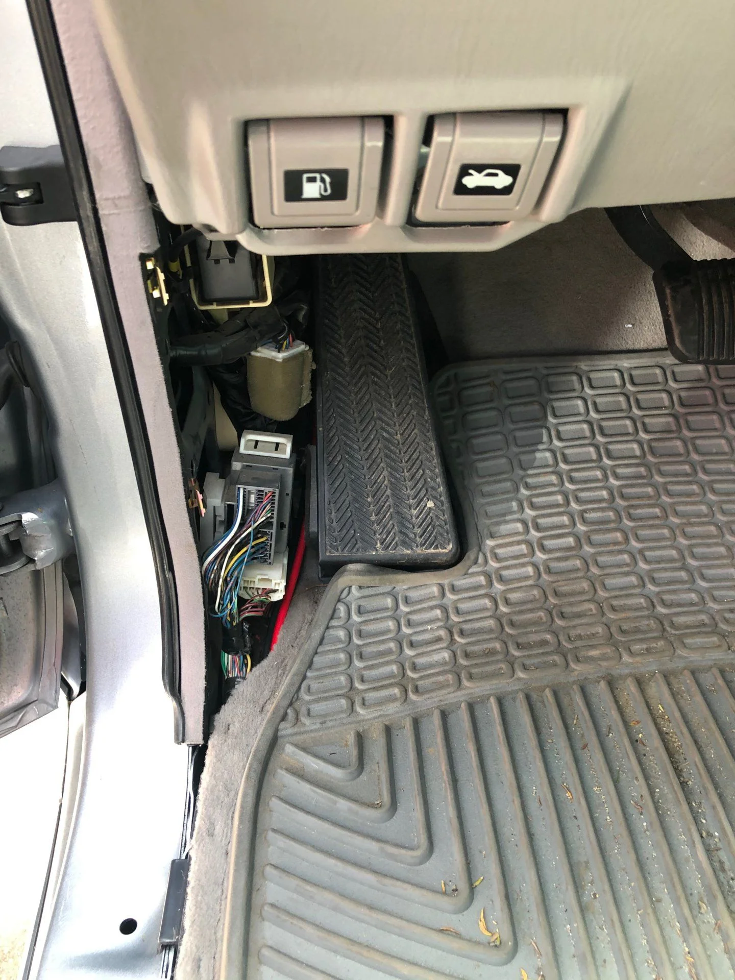

Dirt Baby also got upgraded and switched 12v outlets in the back. 10 ga wire feeds the switch and the first outlet which then splits to 14 ga for the rearmost outlet. The switch/outlet box is from @BenCC and fits perfectly. The outlets are from Blue Sea. The 10 ga wire runs along with the stock wire harness that runs along the floorboard adjacent to the door.

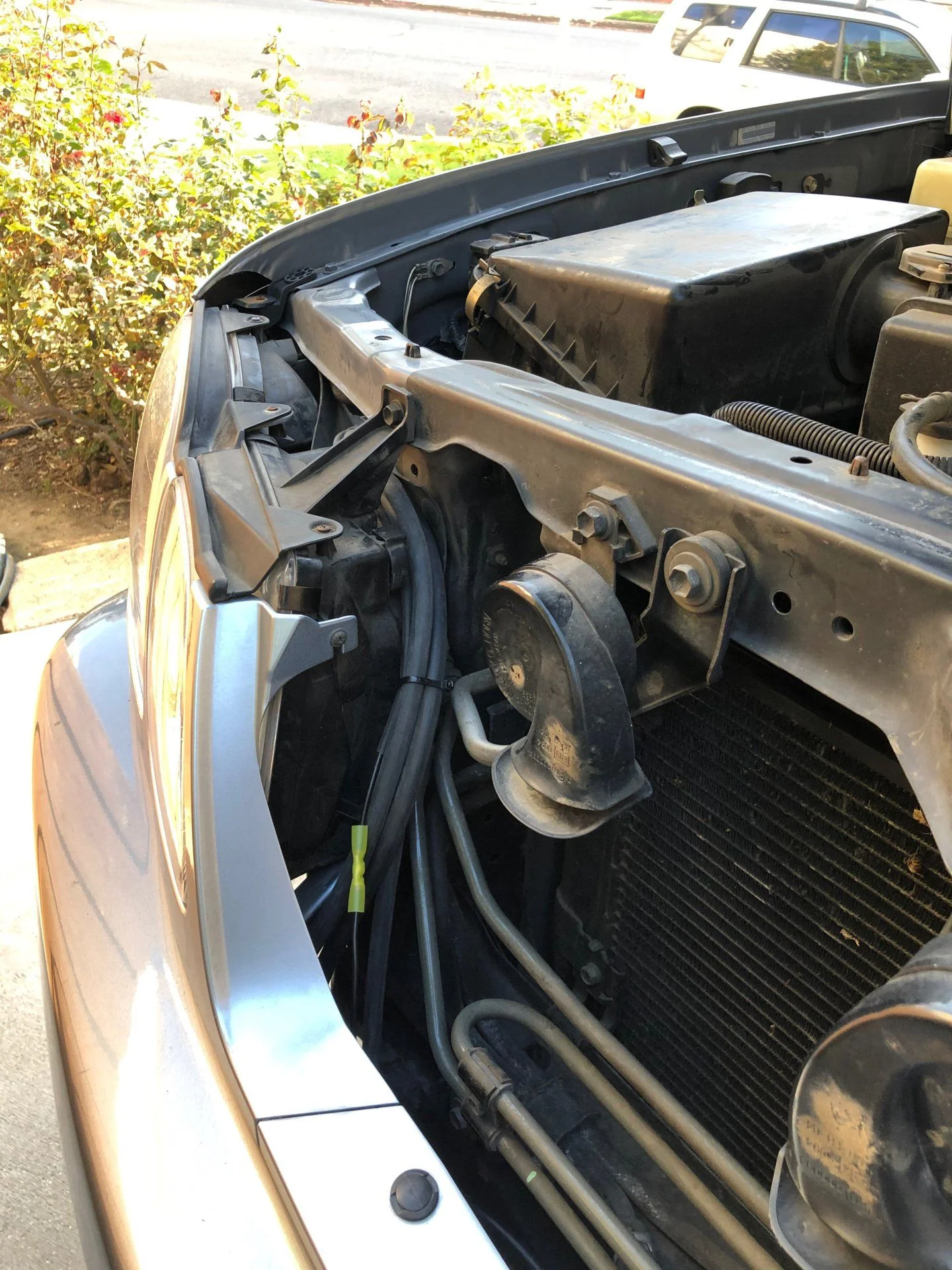

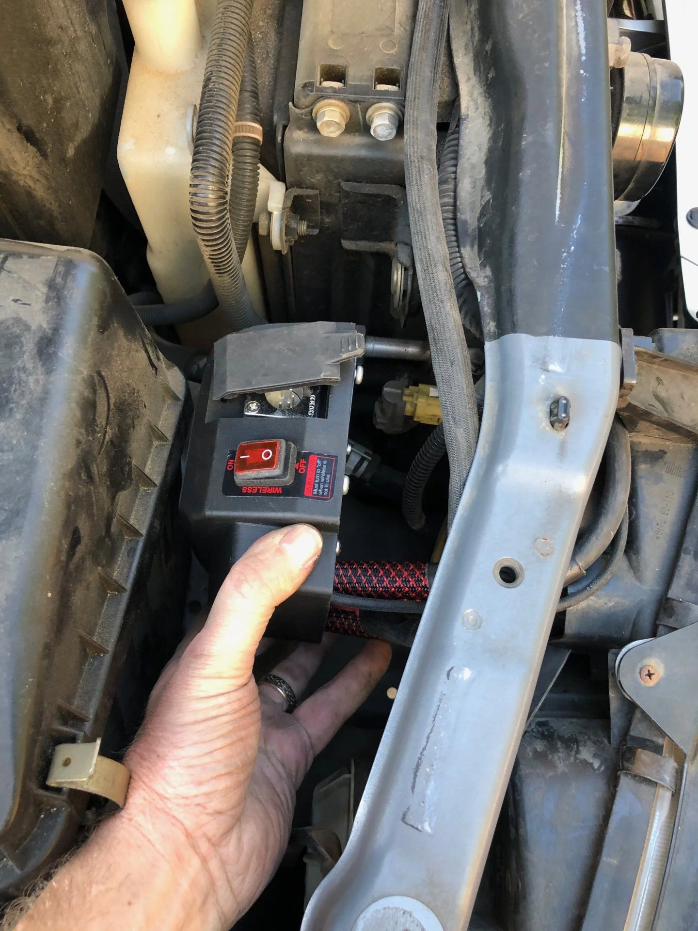

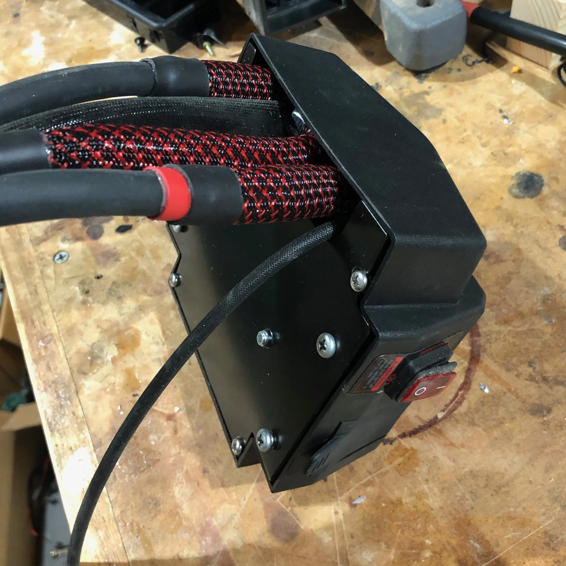

Coronavirus has given me a lot of time to work on the cruiser the last couple of weeks. I mostly finished up my winch install. I started by extending the cables coming from the controller with 2 AWG cable so that the controller could be located next to the air filter box.
I routed the cables through the panel above the headlights and then attached to the winch.
I still need to figure out how to mount the control box. Right now it is just hanging out in this spot. Any suggestions?
With all the electrical in place I wound the rope on complete with the new Factor 55 Flat Splicer.
I'm very happy with how this all went together. On to the next project!

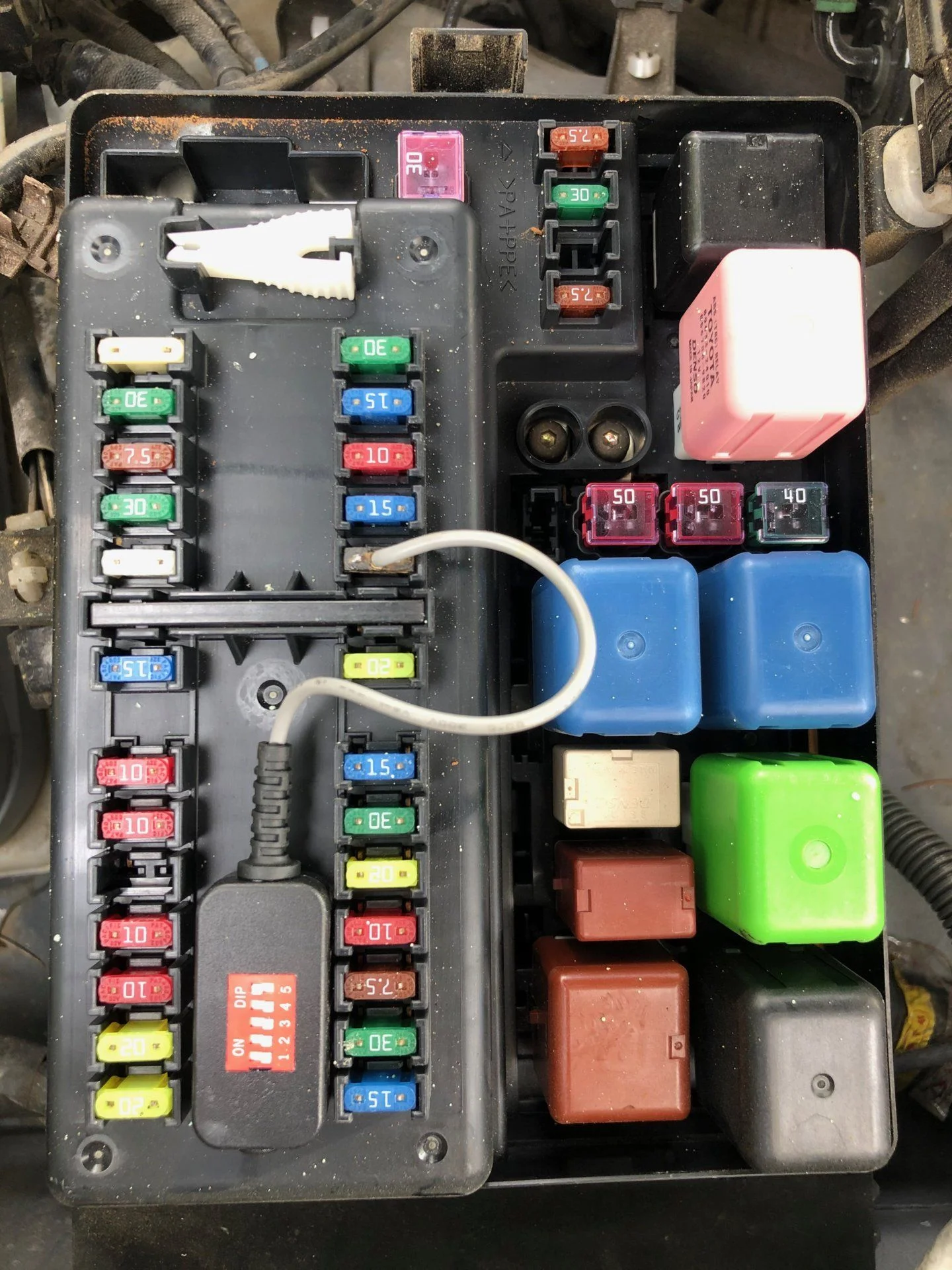

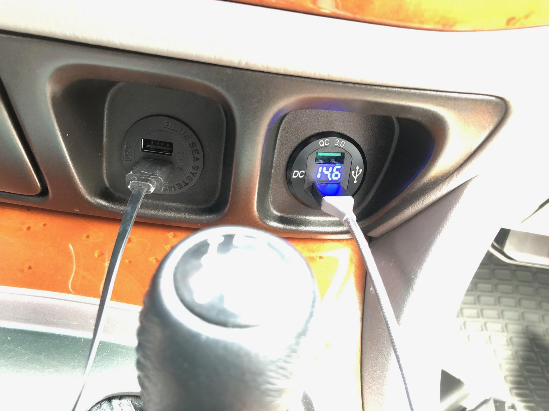

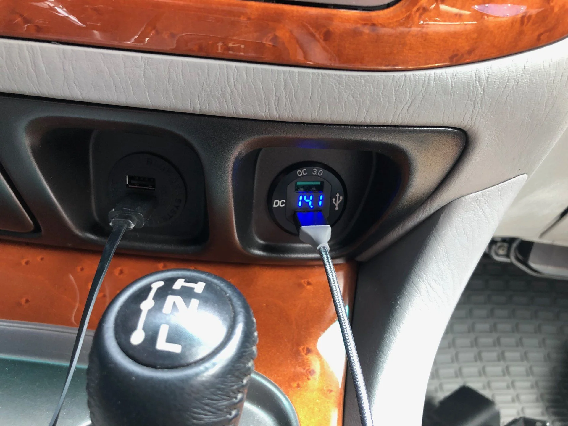

With the new Optima yellowtop I wanted to make sure that it was charged correctly and so I added an HKB adjustable voltage booster.
It fits inside the fuse box like it was designed to!
Voltage before was about 14.0 to 14.1
Voltage after seems to fluctuate betweem 14.6 and 14.7
These pictures also show the upgraded/changed outlets in the center console that I recently added.
One Blue Sea and one no name that includes a voltmeter. The no name is metal, feels substantial and is quite nice.

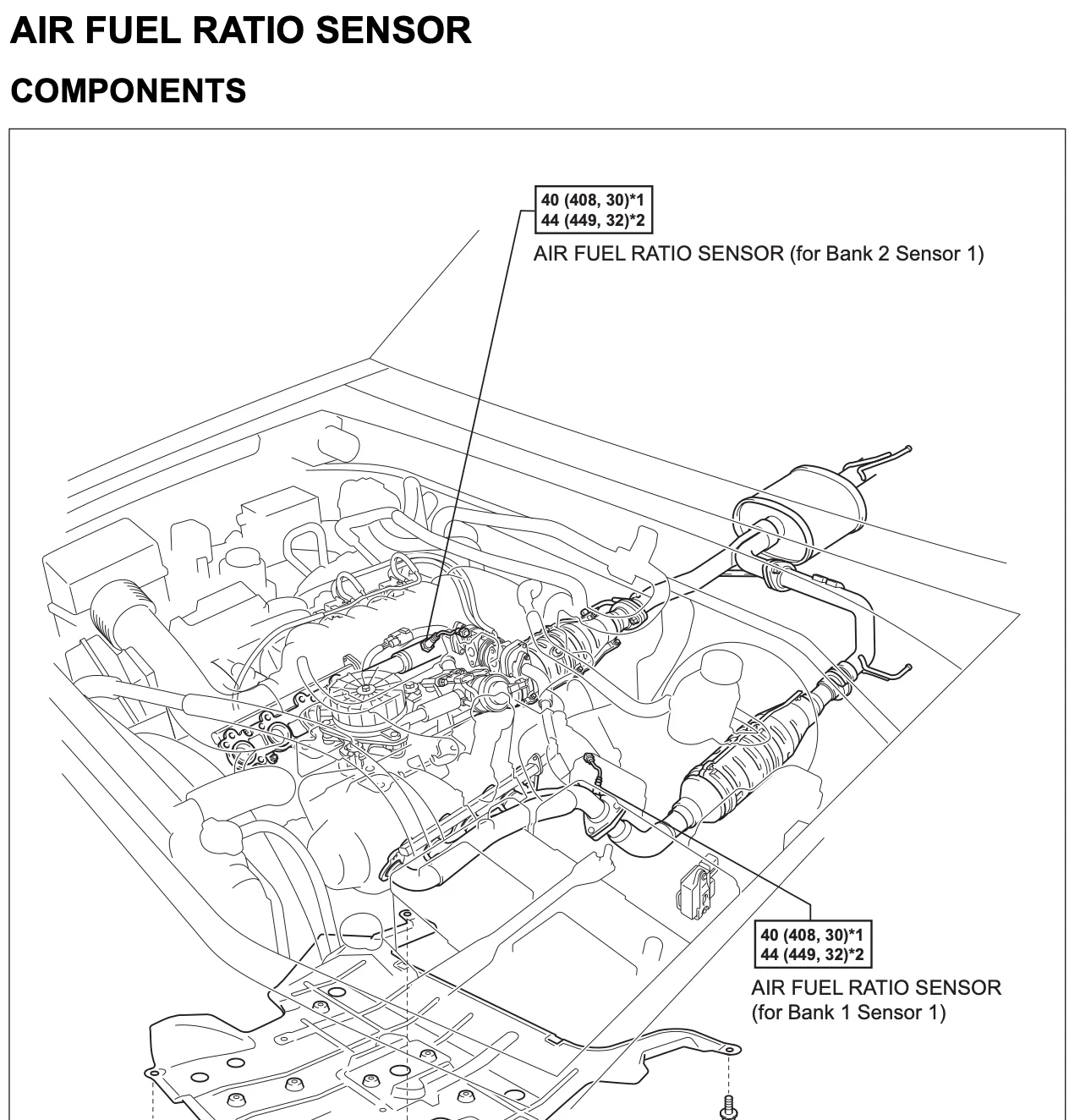

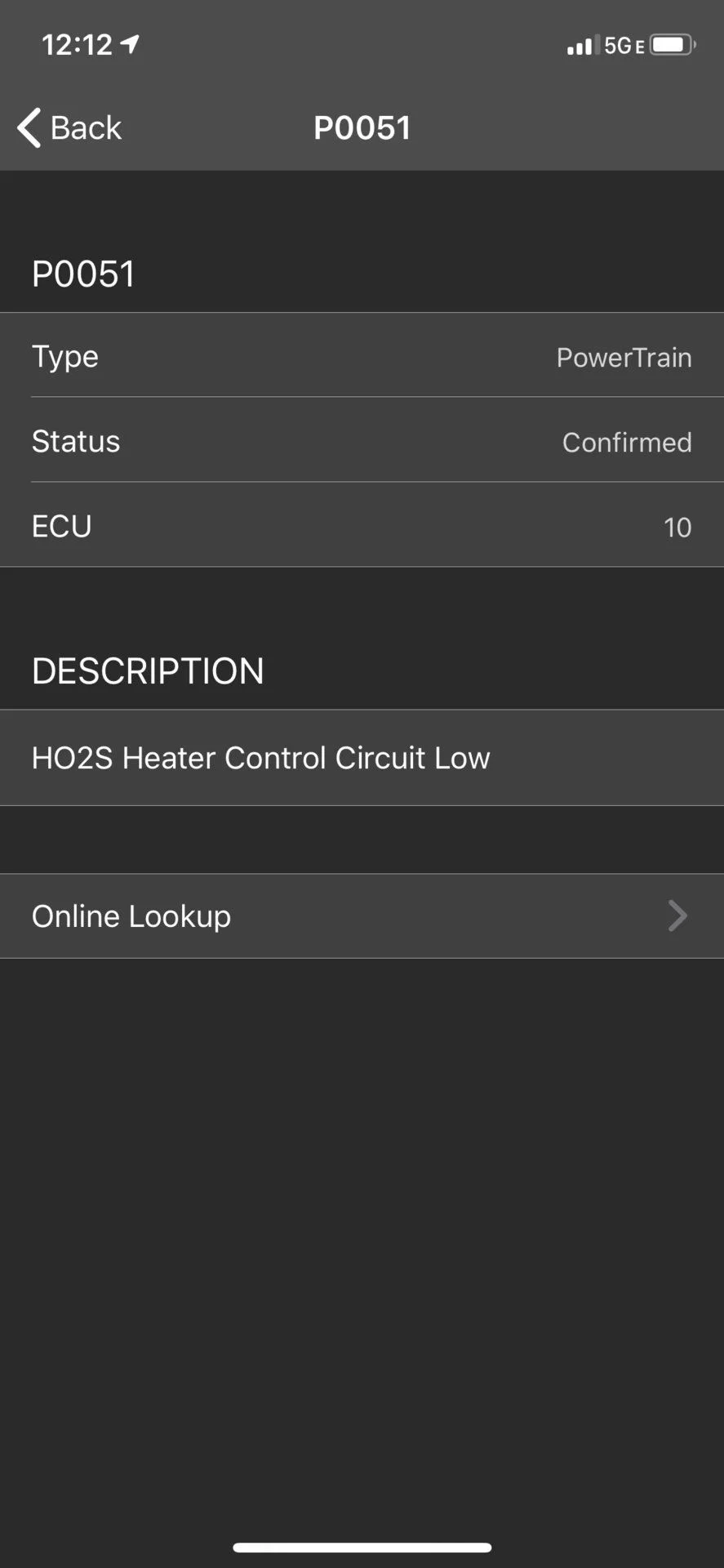

At some point during these projects the dreaded CEL came on. I pulled the code and got an 0051.
According to the FSM this is Bank 2 Sensor 1.
Thankfully my friends at Amazon had an OE replacement in stock.
Amazon product ASIN B000C5YCUW
Out with the old and in with the new. I did have to run down to the local pep boys to grab a oxygen sensor wrench.
When I checked the resistance across the heater leads(black) I got an open circuit reading indicating that this was indeed a faulty part. A later test drive indicates no more CEL. Success!

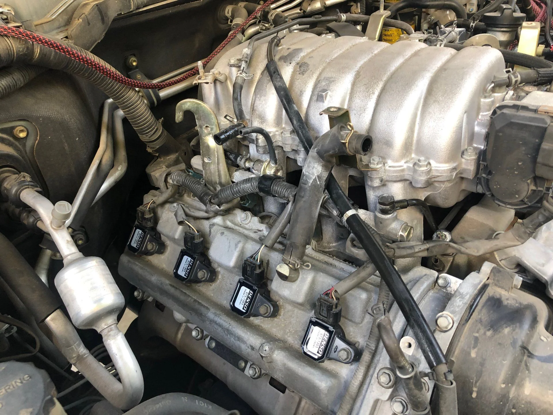

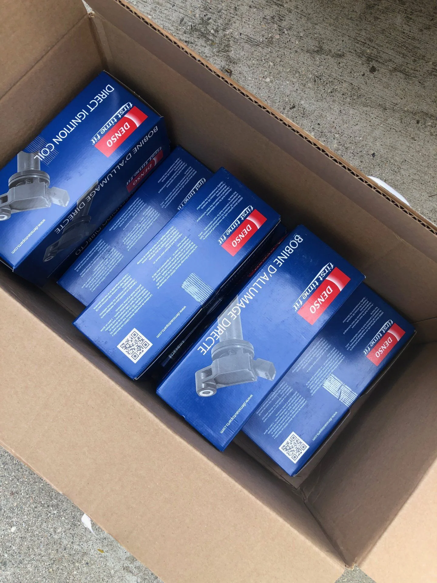

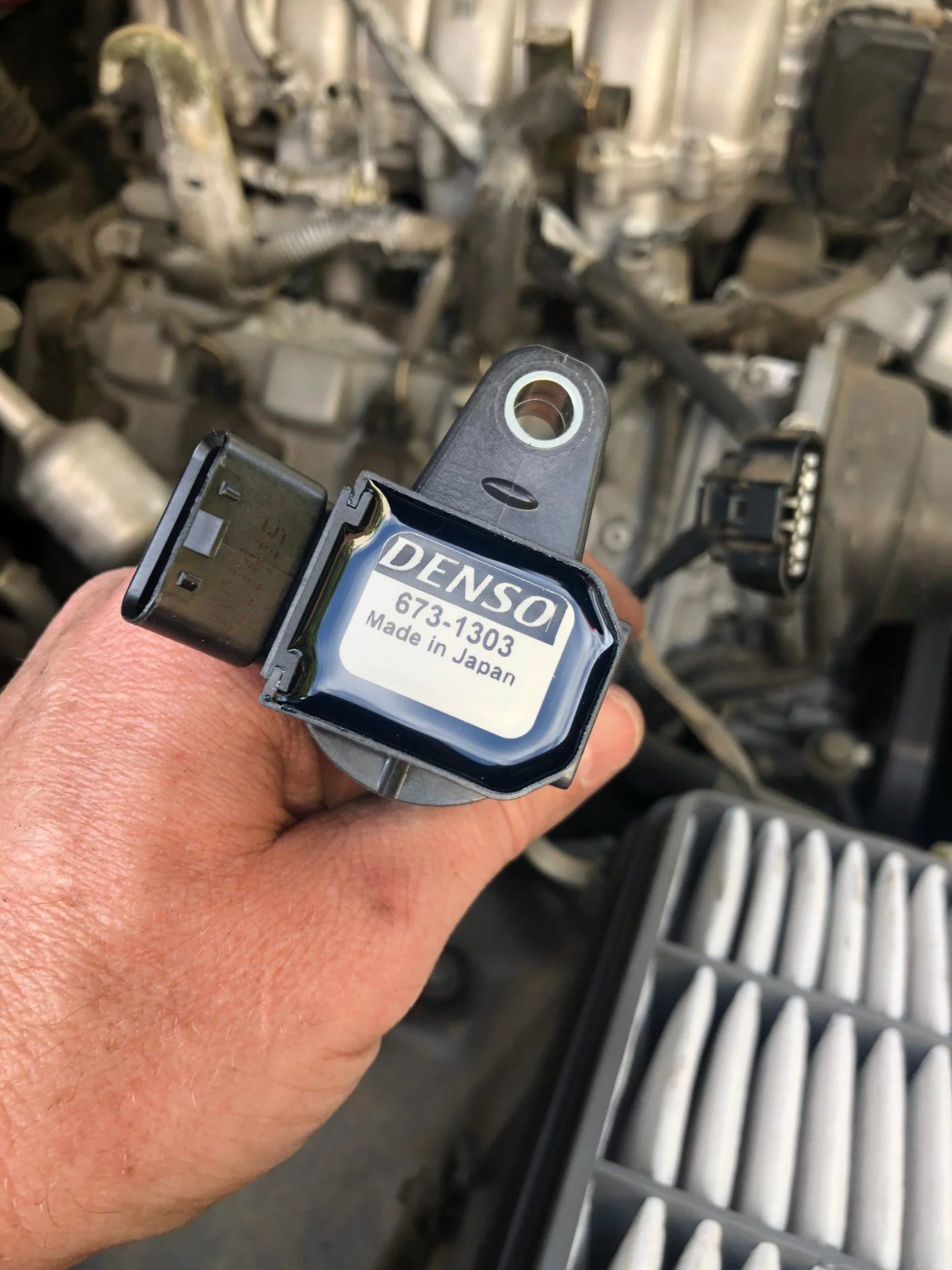

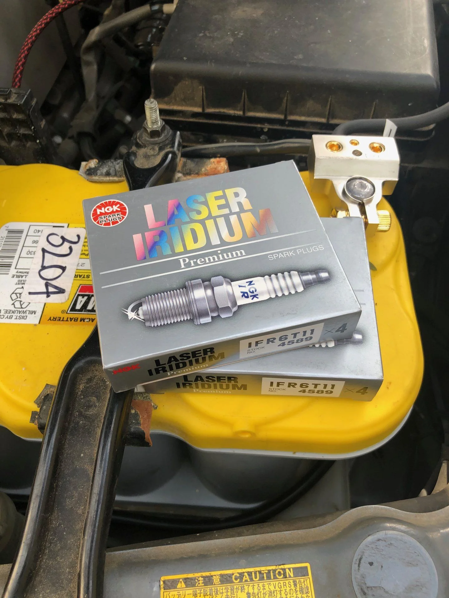

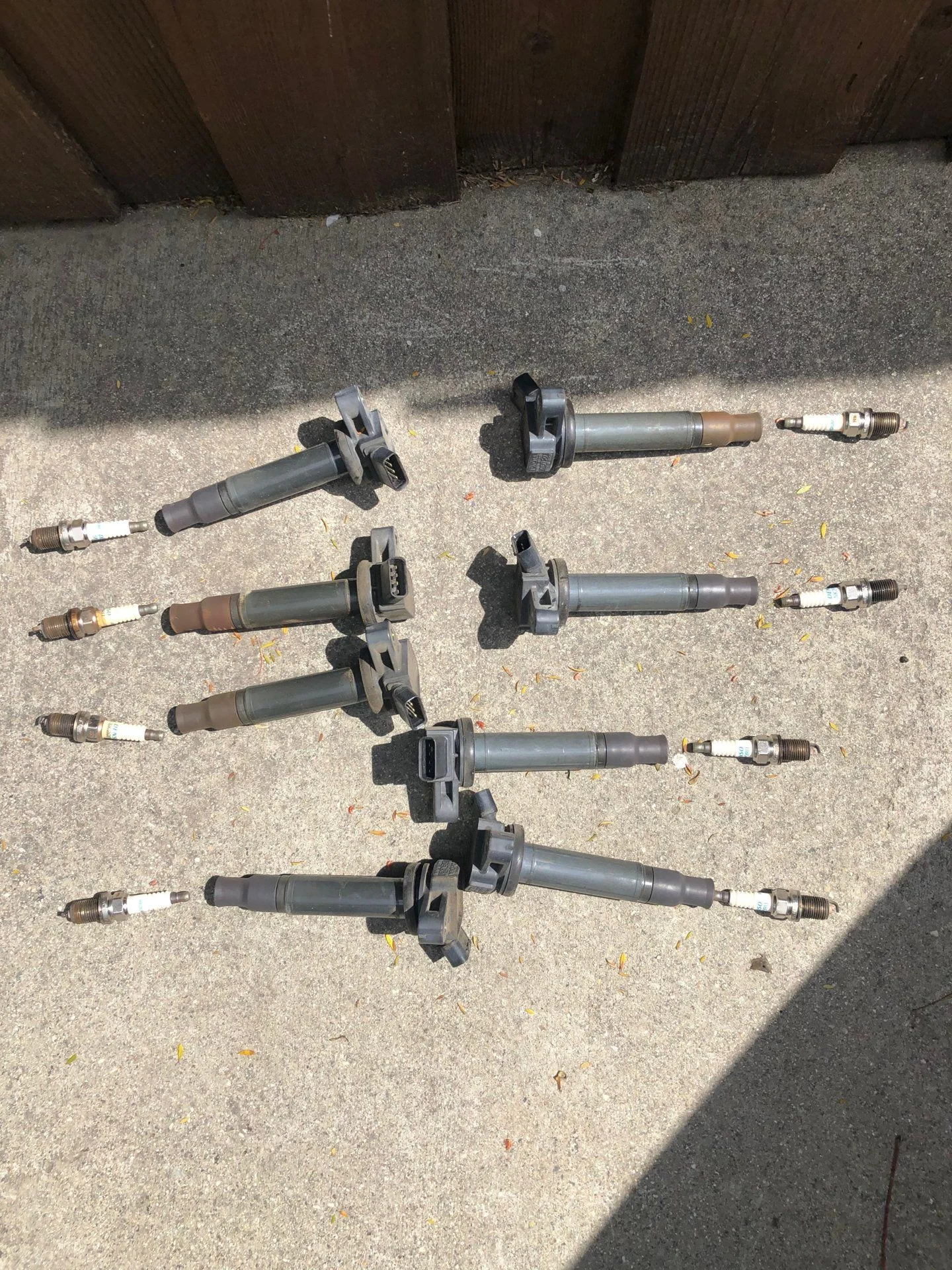

In my continuing efforts to bring this 180k mile truck to functionally new I replaced all of my plugs and coils.
Amazon product ASIN B002Y37M0WAmazon product ASIN B01M97PGOT
1 Box of ignition!
2 Boxes of spark
One of the plugs/ coils (left hand column second from the top) had evidence of blowby that has probably been happening for a long time.
Minty coil

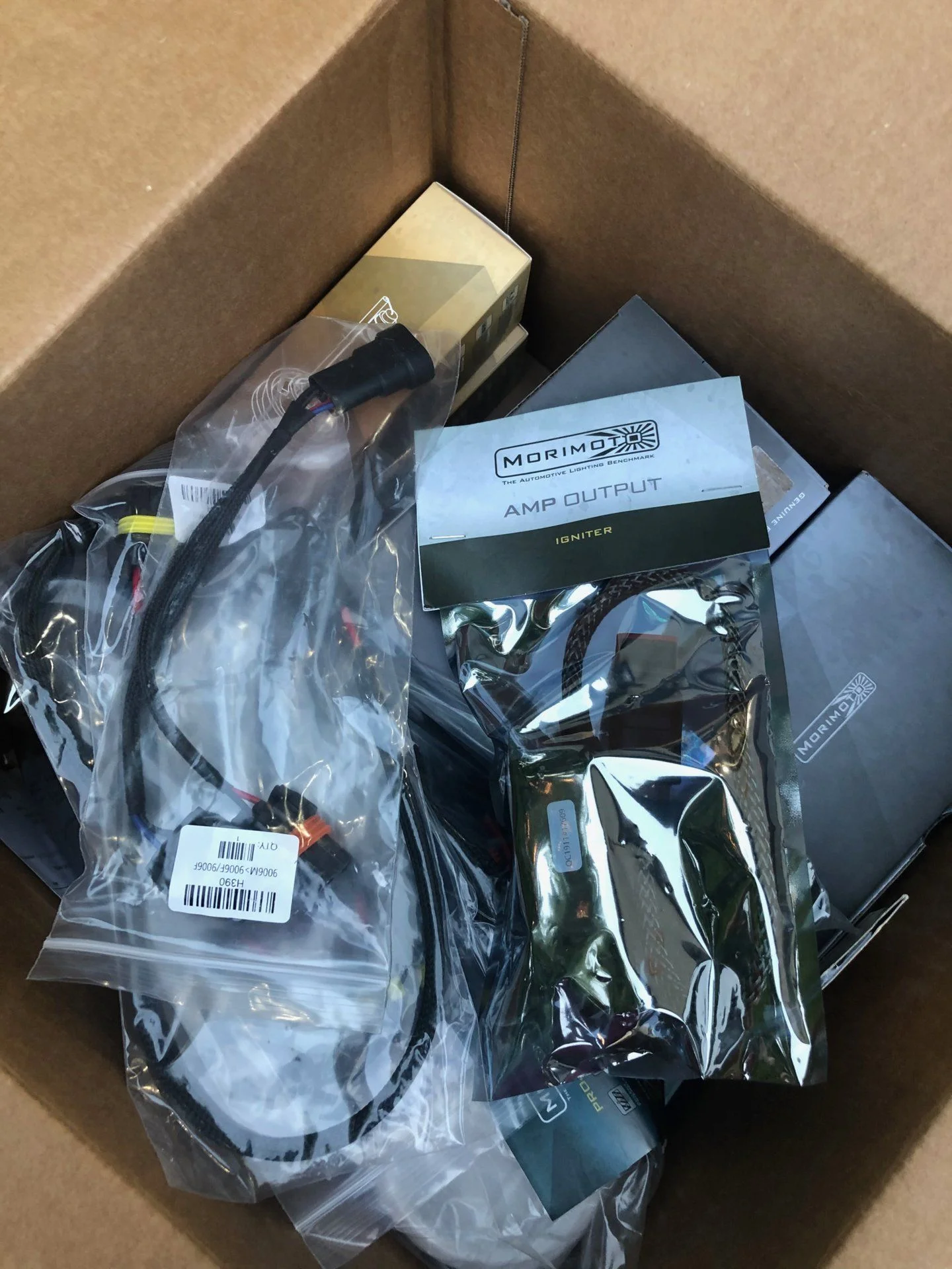

Boxes of toys arrived this week! Thanks to @sleeoffroad and @Luke111 I'll have a wider stance (I couldn't help myself) and be able to see more than 10 feet in front of me.
Can't wait to get these on. The headlights unfortunately are waiting on the Amazon Man to bring some accessories...
View attachment 2284788View attachment 2284789View attachment 2284790
please review those nice LEDs I've been having my eye on them for long time but have yet to pull trigger, how are you going to fit dustcaps?
