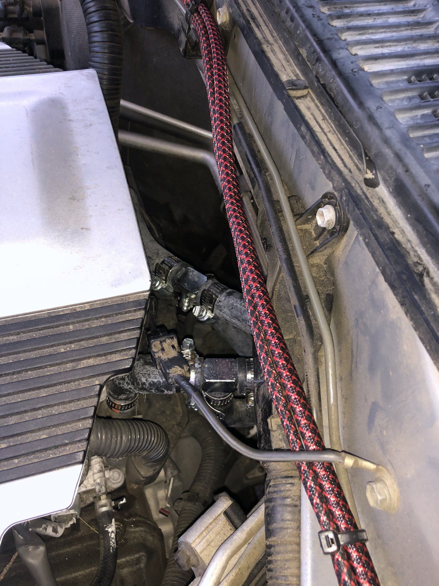

Right before the trip I had my mechanic go through the cooling system and replace everything.
Heater T's, and hoses, Radiator, and Hoses.
The radiator was starting to look brownish and had those spider cracks. While it may have gone longer it was just no longer worth the risk.
Heater T's were replaced with stainless parts and the Radiator and hoses were replaced with OEM.

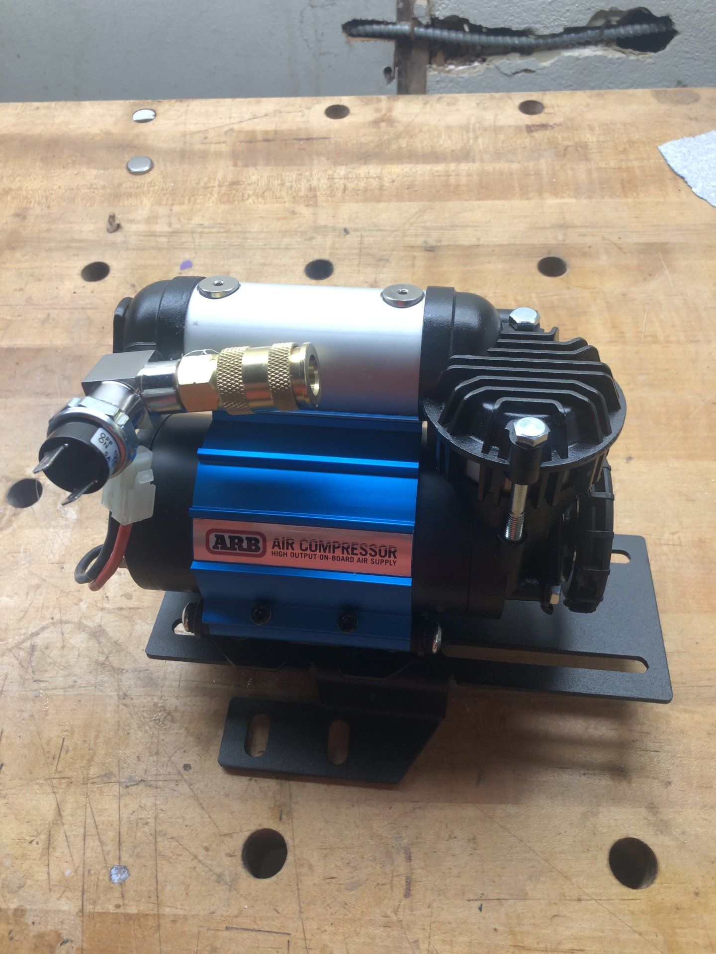

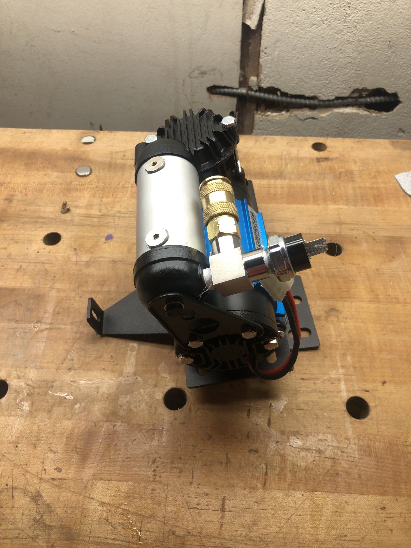

Just in time I took delivery of the new @Ramathorn15 ARB compressor mount that preserves the AHC. I'm not kidding when i say that (excluding wiring) I had it bolted up in less than 30 minutes. I had done the wiring over a couple of weekends previously so I was ready! Being the single version I was able to run it through my SPod. I used the ARB pressure switch in conjunction with a T fitting I found on amazon to control the on/off.
Amazon product ASIN B07DTB34L4
