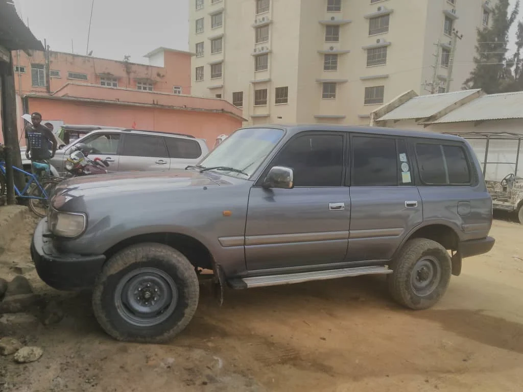

I’ve slowly shifted our fleet towards Landcruisers as opposed to Land Rovers, mainly due to the availability and price of spares. I don’t know the exact model names so I’ve attached pictures, we currently have:
1991 J70 Hardtop station wagon
2004 J70 hardtop station wagon

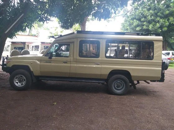

1996 HZJ79 Station Wagon (safari)
1995 Landcruiser GX
1997 Landcruiser GX

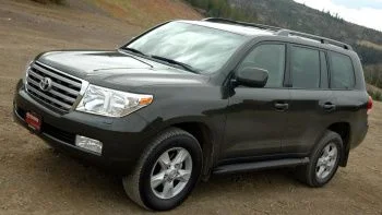

2013 Landcruiser like a VX? It’s our “nice” car.

Your GX is an 80 series.
Your VX is a 200 series.

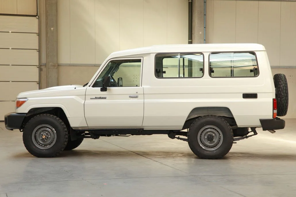

Hello,
The "station wagon" model in the picture is actually a 75/78 Series.
76/77 Series are station wagons.
Prado and Hilux shared platform in the past, but things have changed. Now 4 Runner and Prado are built on a common platform.
It is good practice to think of the Prado, Hilux and 4 Runner as the 70 Series' little brothers. They are all good off road. However, 70 Series Land Cruisers are a category of their own due to, among other things, rugged design and tougher drive train.

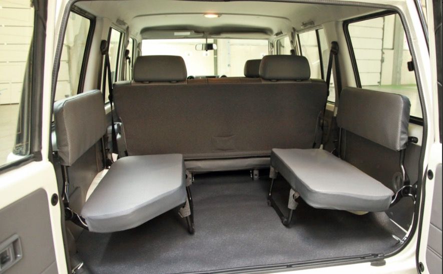

Would have been nice to have that option in a 77 Series
