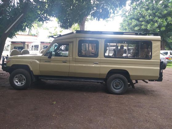

I’ve slowly shifted our fleet towards Landcruisers as opposed to Land Rovers, mainly due to the availability and price of spares. I don’t know the exact model names so I’ve attached pictures, we currently have:
1991 J70 Hardtop station wagon
2004 J70 hardtop station wagon
1996 HZJ79 Station Wagon (safari)
1995 Landcruiser GX
1997 Landcruiser GX
2013 Landcruiser like a VX? It’s our “nice” car.

what is the actual model of that “96 79 series station wagon safari”?
I need one
Its most likely a HZJ75. HZ means it has a 1HZ diesel but they also came with 1FZ making them a FZJ75
The J is for landcruiser and the 75 is a long wheelbase.
They were made from 90 to 99.
The 78 which is a post 99 troop carrier and the 79 series in the heavy duty models and has coil springs in the front. Most of these are diesel except in ME countries where the fuel is cheaper than water, almost. And the petrol models arte superior in sand dunes.
